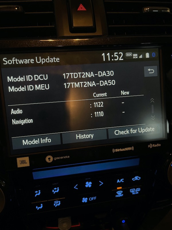

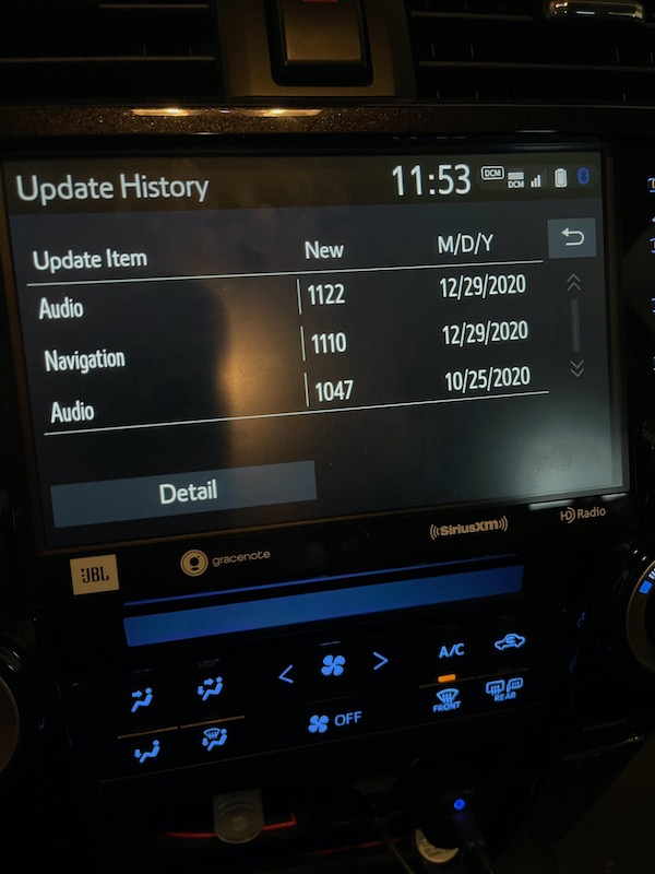

I went to the dealer yesterday and they updated my entertainment & nav software on my 2020 AG TRD Pro. The audio version is now 1122 and nav is 1110. I'd previously done the 1047 update myself.

I wonder if there is a download web site for the new updates like there was for 1047 and 1030? Anyone? Toyota website ofc says mine is up to date and I can't download the new versions either.
Can you help to get the software update for audio:1122 and Navigation 1110? It shall be a file named"17TDT2NA-DA30_000X.kwi", and we can save it and install it VIA USB connection. From "https://securedp.toyota.com/download-app/getHeadUnits", can only get the update files released on Nov.19th,2019, the audio is 1047,which is not up-to-date. Tks
