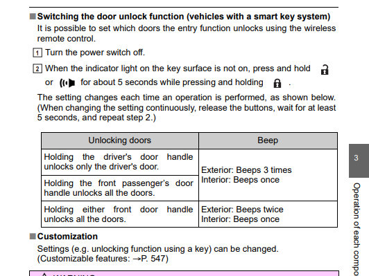

I've had my 2020 TRD Pro for 3400 miles and exactly 30 days. I love this truck. Its a nice combination of tech, off road capability, on road comfort and stock looks. Now I'm coming from a Jeep Rubicon so it didn't have any tech, on road sucked and I had to spend $10K to get it to look the way I wanted to. Things I don't understand though.
1. After remote starting, why the hell does the 4R turn off when you unlock the doors?? Please tell me there is an actual reason.
2. And equally annoying is why can you unlock all four doors when opening the passenger side door, but not when opening the drivers??
Are there any ways to override the 2nd complaint??

You can change the touch unlock on the drivers side to unlock all doors, I can't remember exactly what I did off the top of my head. I read about it in another thread, something to do with holding lock+unlock on the remote for 5 seconds? Definitely confirm this elsewhere.
No clue on the remote start, my poor SR5P lacks this functionality (not that I miss it).

1. It was explained to me it's to prevent someone from being able to leave with the car should they open the door since the vehicle can be driven even if a key is not detected in the car once it's running. Though my wife's murano won't let you drive until you press the start button and a key is detected, so that seems like BS to me. Related, I noticed that the car does NOT shut off if you open the hatch. I haven't yet been ambitious enough to climb in through the back to see if I can drive away without it turning off.
2. See below - I'm 99% sure you can also program the same thing through Techstream which is what I believe I did since I have it setup that way and don't recall bothering with the key beeping stuff.
