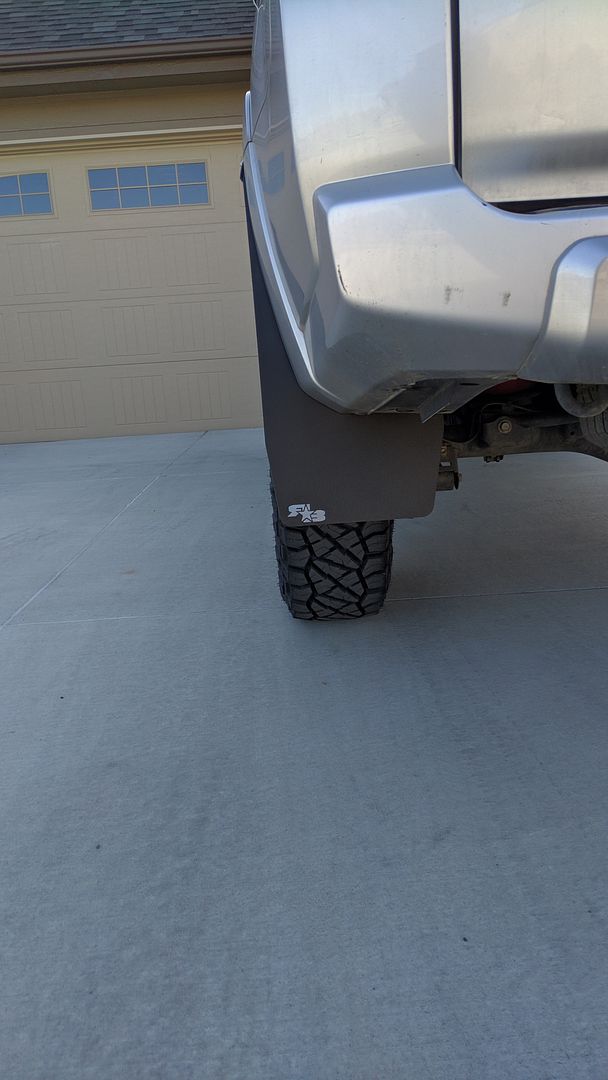

Finally got new kicks on my 2017 4R SR5 Premium. Researched going to 275 or 285’s, but daughter is learning to drive with my rig so 255/75r17 was a nice upgrade from stock Dunlop. For a mud tire, not loud on the highway or street driving. For reference, 2-4 clicks of the volume on radio took care of any extra noise [emoji106] I have Bilstein 5100’s set at 2.5” in front, with cornfed 1.5” spacers in rear. Spidertrax 1.25” wheel spacers all around. Plenty of clearance while driving, minimal rubbing when full lock in reverse both ways. Some nipping and tucking with a box cutter of the mud flaps took care of it quickly. This is my daily driver, all highway, zero off-roading for this guy. I wanted a more aggressive tire than stock without having to chop up the body, fenders and such. When I was researching this tire size I didn’t find a lot of info so feel free to ask questions.
Wtf is that monstrosity on the front

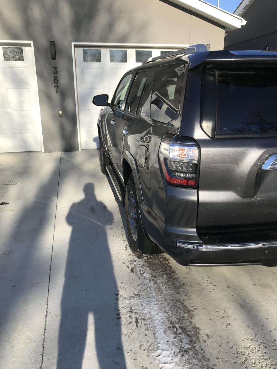

Here's the best pic I have showing from the rear, doesn't really show where the tread is relative to the fender edge though. Some 1.25" wheel spacers would really complete the look IMO. It's on my list of things to do.

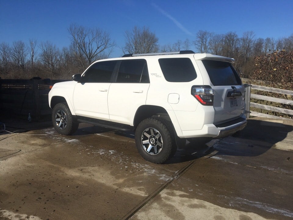

Here's a pic of 255's with stock Trail (7.5") wheels and 1.25" spacers.

From the pics, it looks like there isn't a lot of meat/bulge on the side for rim protection, and that's with 7.5" rim.. 8" may not be the best idea.. Perhaps the TRD Pro rim at 7", but that one weighs 25 vs. the Six Shooters at 21.. Decisions, decisions..

Sidewall bulge has a lot to do with the specific tire design as well, different brands in the same size will vary here.

Don't forget when needed, you air them down and bulge will increase significantly.
