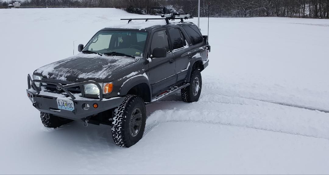

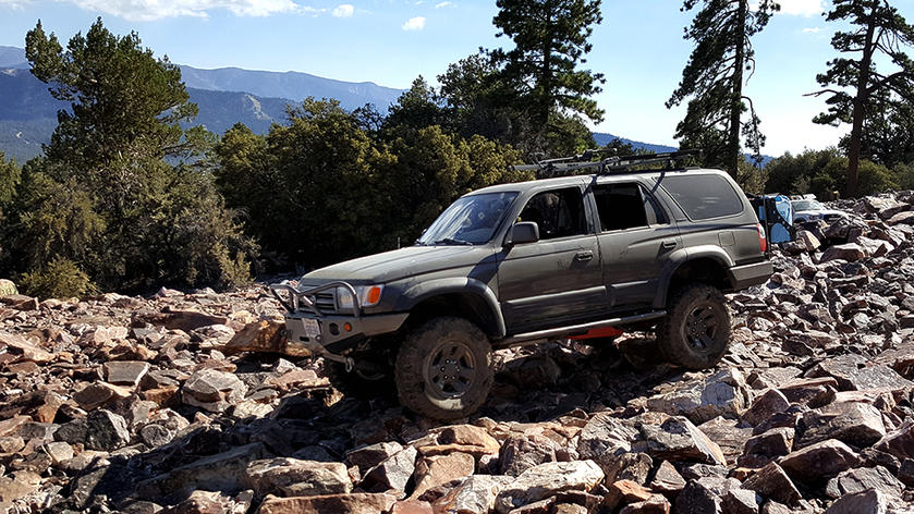

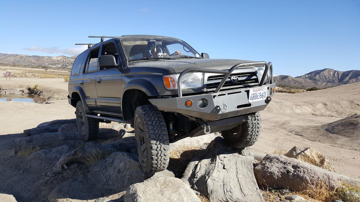

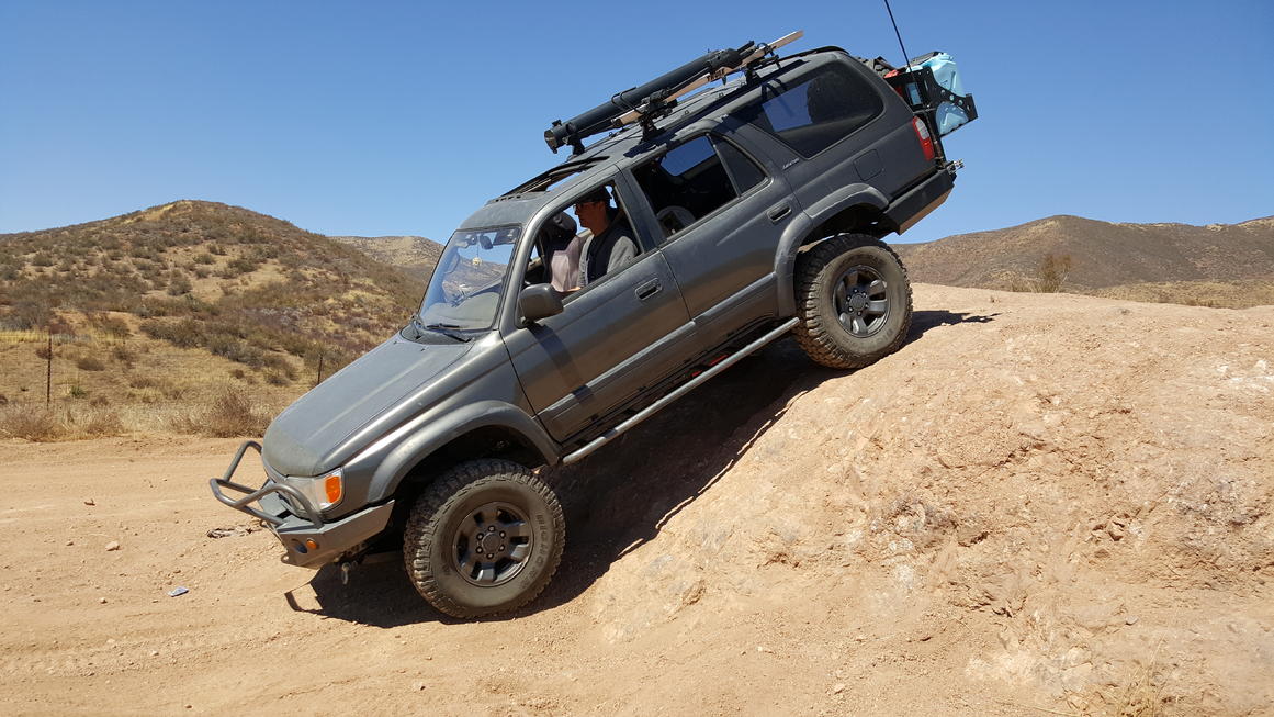

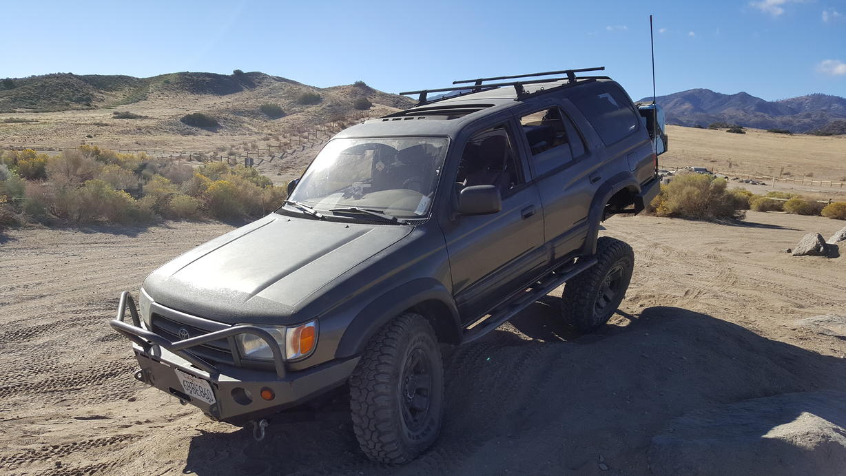

Big Horn Maxxis = fun

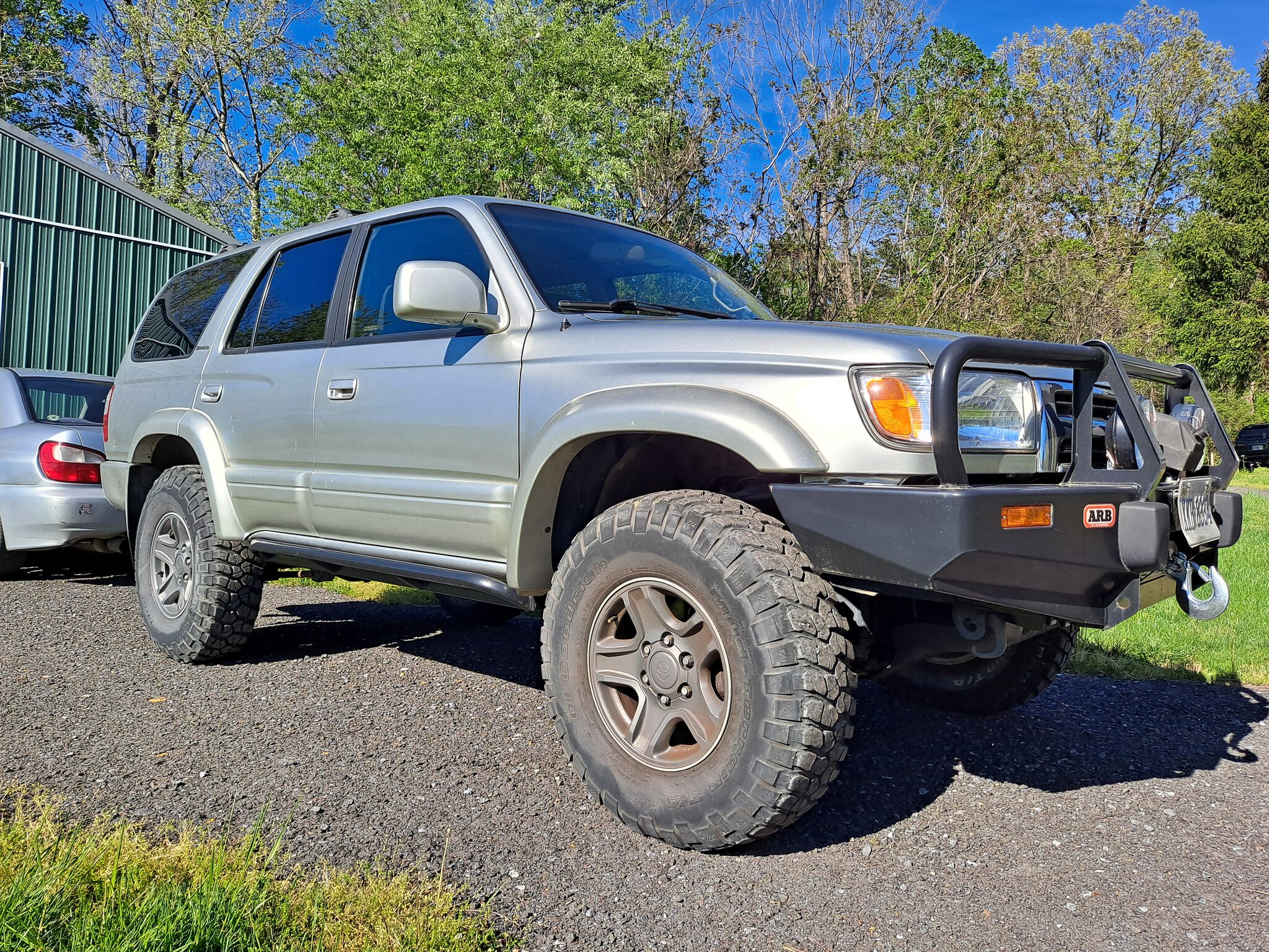

Just picked this up in Alexandria VA for 7500. Frame is nearly perfect.
How much lift do you have and are you running any spacers?
I have the same wheels sitting around and don't have any fender flares. Currently have 16x8 aftermarket wheels with 265/75r16s. I bashed in the pinch welds to get them not to rub. Have 5100s with ome 881s, set to first notch. Wondering if these would run about even with edge of fenders, without spacers and not rub.. I know it's a little different for everyone, just want to know your situation.
Would appreciate any info

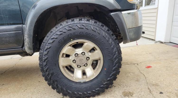

I have 255/85 Coopers ST MAXX on factory five-star 16" rims. I locked out my bottom lower control arm cams (neutral) and my SPC uppers to factory (D) setting.
I only get minimal rub at full lock off the rear of the tire on the frame rail, no pinch weld interference.
I'm also lifted 3 in in the front, FWIW

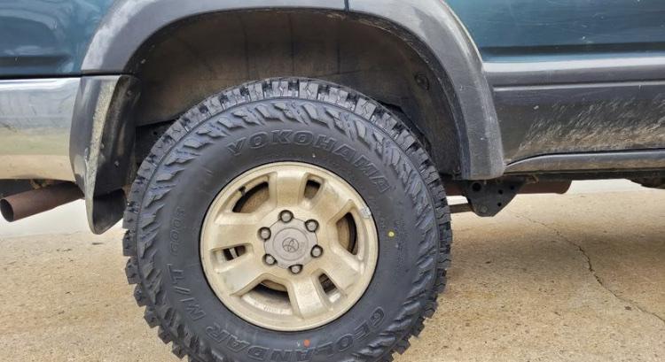

255/85 Geolanders. No front lift and OME890s in the back with LC shocks. My rear lift has definitely sagged a bit so new springs will be a bit higher
