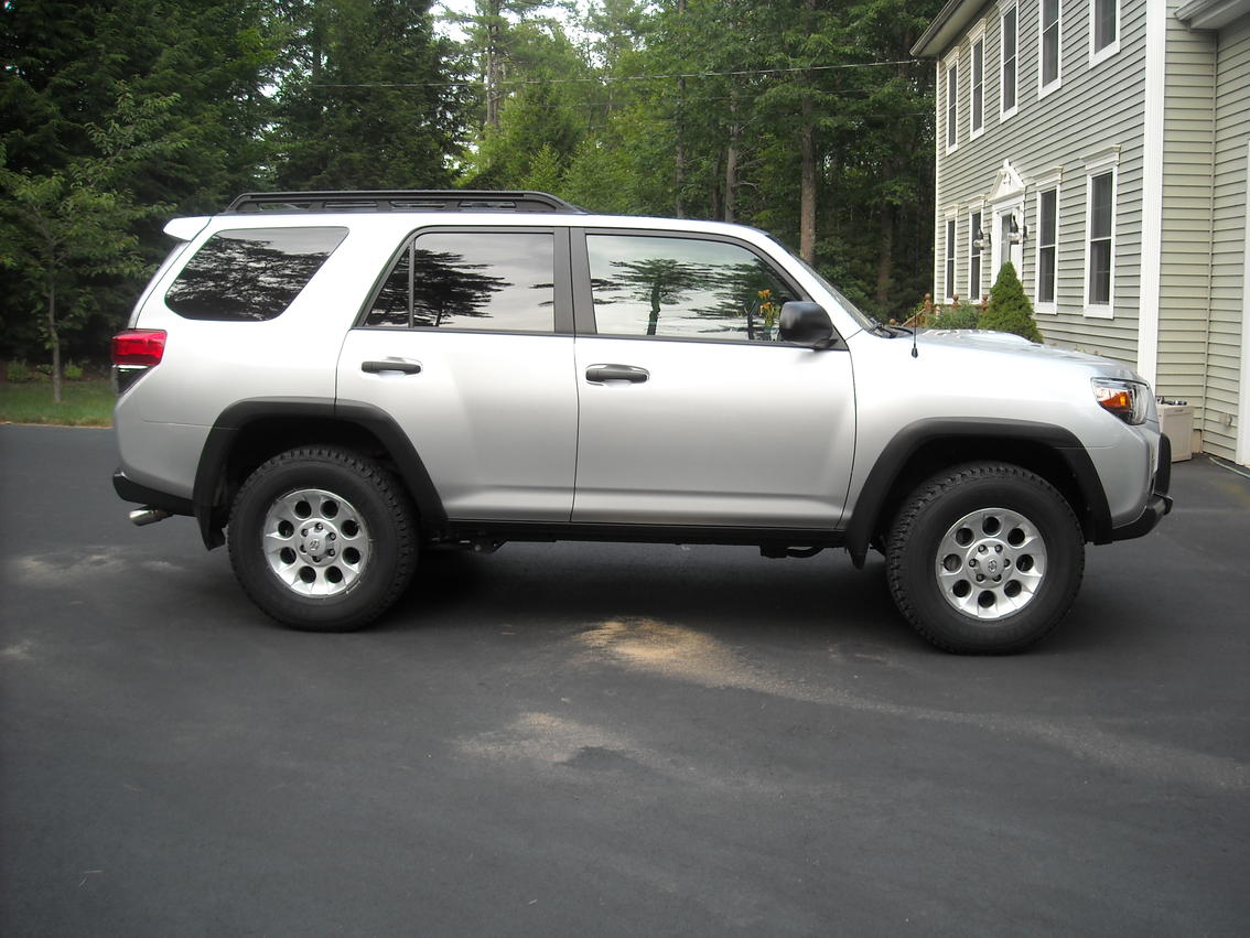

The 4 runner sits level prior to install, I have read (and pics) a ton on leveling on this forum.....when you measure from a flat surface from the rocker panels, its sits level, I knew if I went to .85 it would be alittle nose high...I was ok with that because I will probably put in a 1" cornfed spacer later this summer. The pic below is on a slopped driveway. Once you get a full tank of gas, any weight, you can see it nose higher but even without that....is alittle higher.

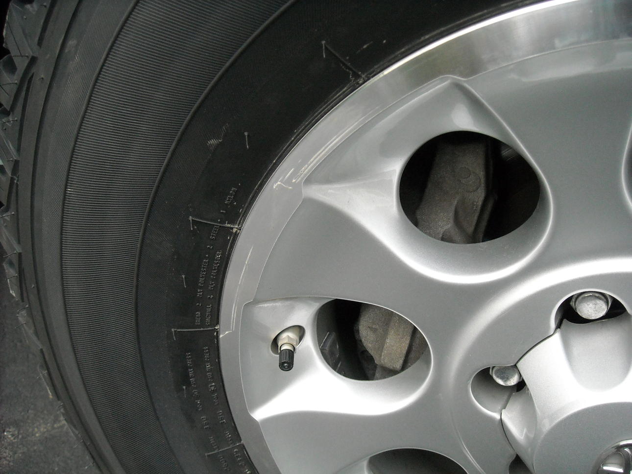

They scratched all 4 rims with the roadforce balancer..wtf. They are going to have a professional try to fix it, if it doesnt work then we must have a good conversation on replacement or $$$$. It seems the plastic lifter part that goes around the rim when putting the tire on scratches the TE flat rim piece that runs around the tire. You think when the first rim did it, they could think of a way to fix that (protection), they tried another Roadforce, did the same thing. Im willing to let them try to fix it but the more I think about it, the more pissed I get. Seems like only one person on this forum has had such an issue, so to me, the installer did something wrong or the machine needs new parts...who knows.. :uzi:

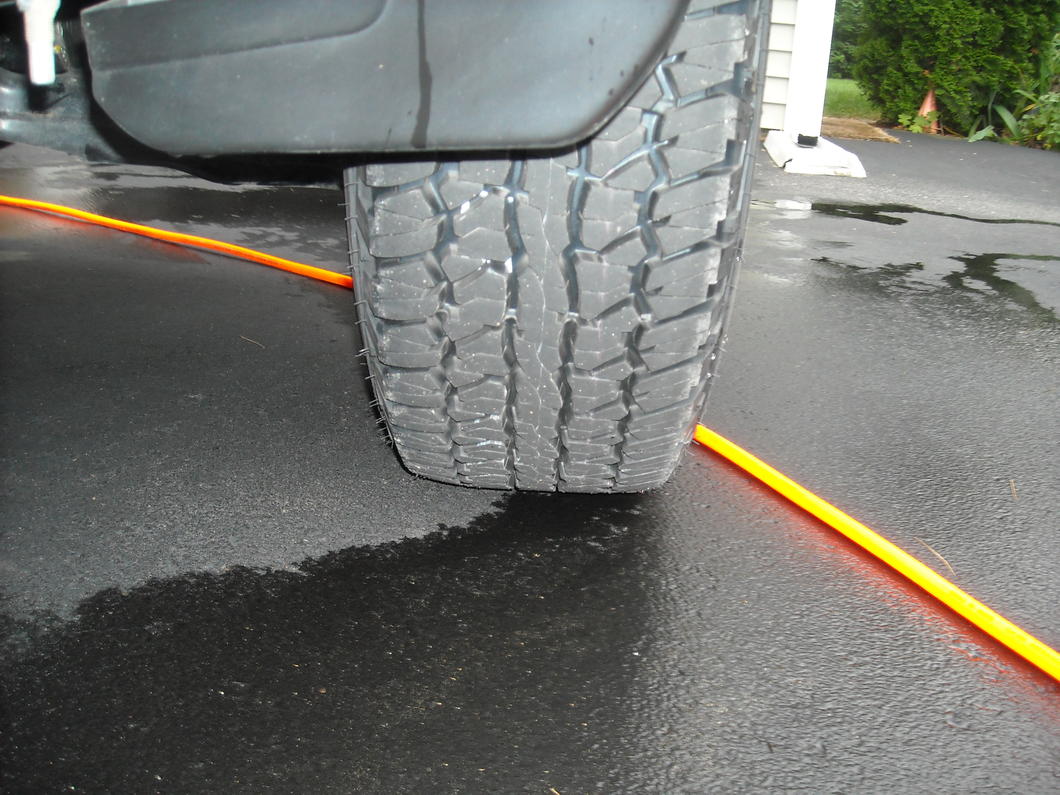

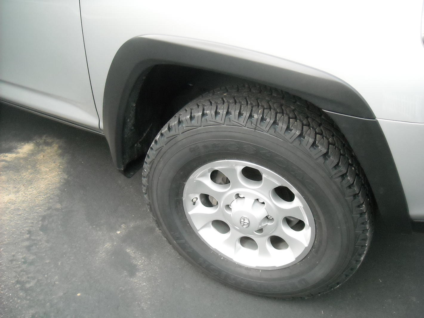

The tires look alot better, more aggressive but not over kill. They are quiet, pretty close to the Bridgestones. I can hear them just alittle bit more. I think as the 13/32 tread goes down, they will because quieter. I can feel them, aggressive tread--milder then others, but no real vibration or such. They do carry the Mud and Snow symbol and look forward to NH winter and how they do. I think the LT has reduced the floaty type bounce. I was worried about how 6 ply and LT's would be over the P. I think I made the correct choice. I had them do them at 40 psi (got home and they were around 38..ugg but put them back to 40psi). I might tow a camper later on, so glad to have the extra ply's and carrying load (at 50psi).

Looks great Ramzey. This is what the truck should look like from the factory IMO. Sorry you didn't get the results you were expecting with the Lt tires. I guess it's all pretty subjective anyway.
Did you get the 5100's for the rear too? Planning to install them when you install the CF spacers?
I came from a Tacoma as well. You are absolutely correct regarding handling and braking differences. I guess with this much additional mass, the 5th gen will never drive like a 4th gen or Taco, but the factory set-up is just plain ridiculous.

The road force did that? Looks more like tire mount marks. The local tire shop here uses a thick grease on the edges when they mount. Do you know if they used the Haweka tool when they balanced?
Looks like a grease was used.....I asked for the haweka adapter to be used but not sure if they did......they insisted they had state of the art equipment with different flanges......so who knows.....I asked and hope they used it...don't know.

Glad I made the decision on those exact tires, shocks and minor lift...85. During the alignment I tried to get positive caster, set to 4.0 but could only get around 3.0 (I'm sure the dealer didn't try to hard). (this helps with steering response). Yes, I think it's alittle nose high but most can't tell and most will say its level but I think it's slightly higher but not really that noticable. I'm happy I did it. Still might add a 1" spacer in the rear because I like the look of alittle rack but not in a hurry. If I had money and faith in the dealer, I would have done 1.5 front shock setting and 1" rear spacer( maybe different spring instead that gives 1" lift). I think that would look great. I didn't want to go with 285's for fuel, and engine response and I wanted only to go up to load c so my tires to me we're the perfect decision.....they are quiet, feel good, wear well (more tread then p rated). The shocks did help with cornering and some braking, tires helped this as well. Break dive is not elimated (would have to change string I think). Haven't tried tire in snow yet. If I went higher, I wouldn't fit in my garage with my Yakima rack. I changed out the antenna because it was hitting. Let me know if I can help you with more ?'s.
