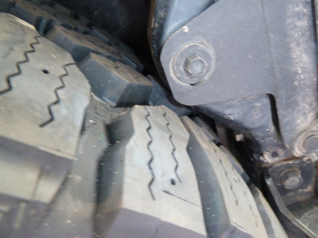

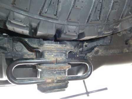

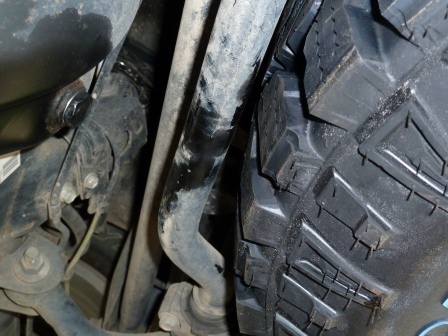

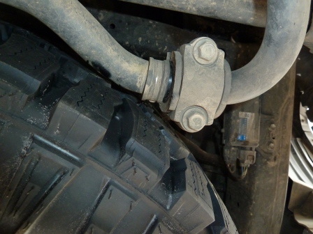

I know I have seen this question floating around the forum about whether 285/70/17s fit in the spare location, and most of the answers have been yes. I changed out my stock spare for a Goodyear Duratrac and thought I would post some picks of the clearance around the tire in case anyone had doubts. It is close to my KDSS sway bar but I think there is enough room for it to clear the tire during its range of motion. If it does contact it during my next off road trip I will just have to get a rear bumper made.
At first it was too close for my taste to the sway bar.
I readjusted it after Discount initially installed it.
It did have to be right up to the hitch to fit but not super tight.
Now I just need a spare trail rim.

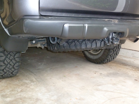

Added Shots of the back of truck. Hangs down a bit but not too bad, wish I would have taken some with stock for comparison.

I have a 3 way hitch ball. It has two different places for the hitch pin to fit depending on which ball is selected. I had to lower the spare and push it all the way towards the sway bar so I could connect the 2" side of the 3 way ball mount. So these pics tell me it would no work with the larger spare tire.

That hangs very very low to my liking. Better to have a 255 80 17 spare in there.
I've had my 285 hanging like that on my truck for a long while now, and I've never done any damage to it while on the trail. I rarely hit it, and while a 255 might be a better fit, I think it would take some pretty hard hits and extremely sharp rocks to damage the tire in that configuration.
Agreed. Mine has been there for a while as well and I break other things instead.
