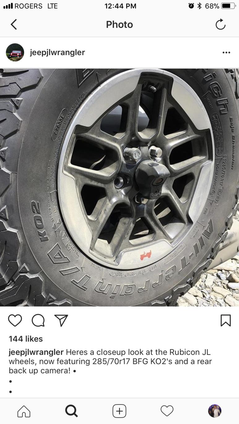

Just spotted this photo leak of the new Wrangler JL with BFG KO2 285 70R17 load range C!
Seems like it is inevitable and replacements will need to be available to replace.

Jeep must think the C rating is strong enough if they are putting it on their Rubicon. Pretty sure they test those on the Rubicon trail. Must have done ok to warrant putting them on there.
Weren't the km's they put on the jk rubicon's also c-rated? I remember them on my 07, they were soft and lightweight.
What the heck is on the hub, looks like a lock off a Yakima?
Nevermind I bothered to read the Instagram and it's the backup camera.
