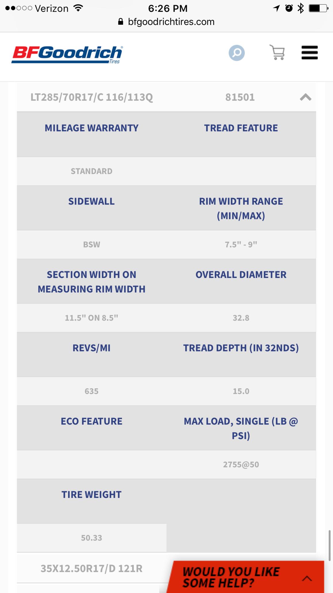

285 70 R17 BFG KO2s With Load Range “C”?
Specs

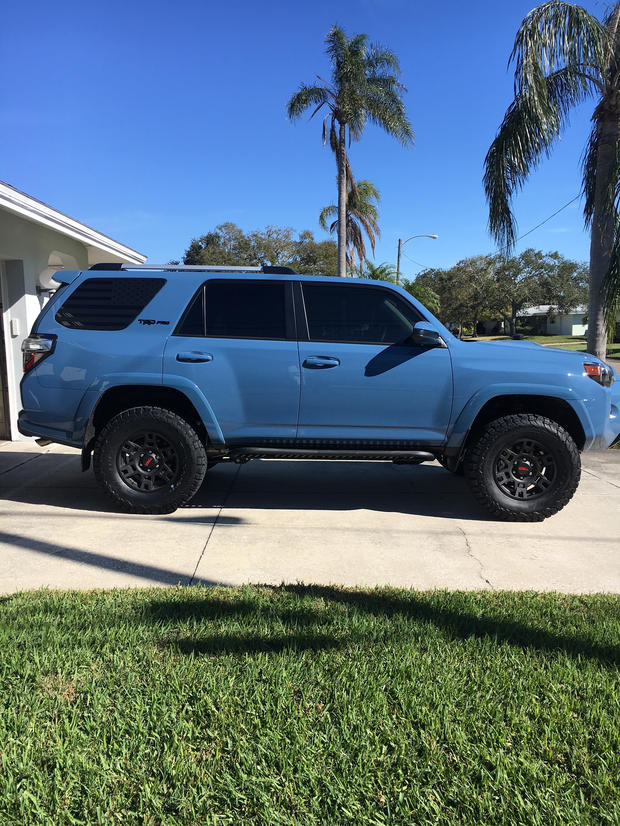

Also, is your pro stock height? And is there any rubbing with these?
My pro is lifted 1.5" in the front with Cornfed spacer and I got 1" in the rear with the Wheelers/Eibach T13 coils. Not even close to rubbing even with mud flaps still on. If I put on wheel spacers, which I'm debating on, I'll need to remove the mud flaps
Do you have pictures of these mounted on your 4Runner? Can you measure the height of the tire now that it's installed?

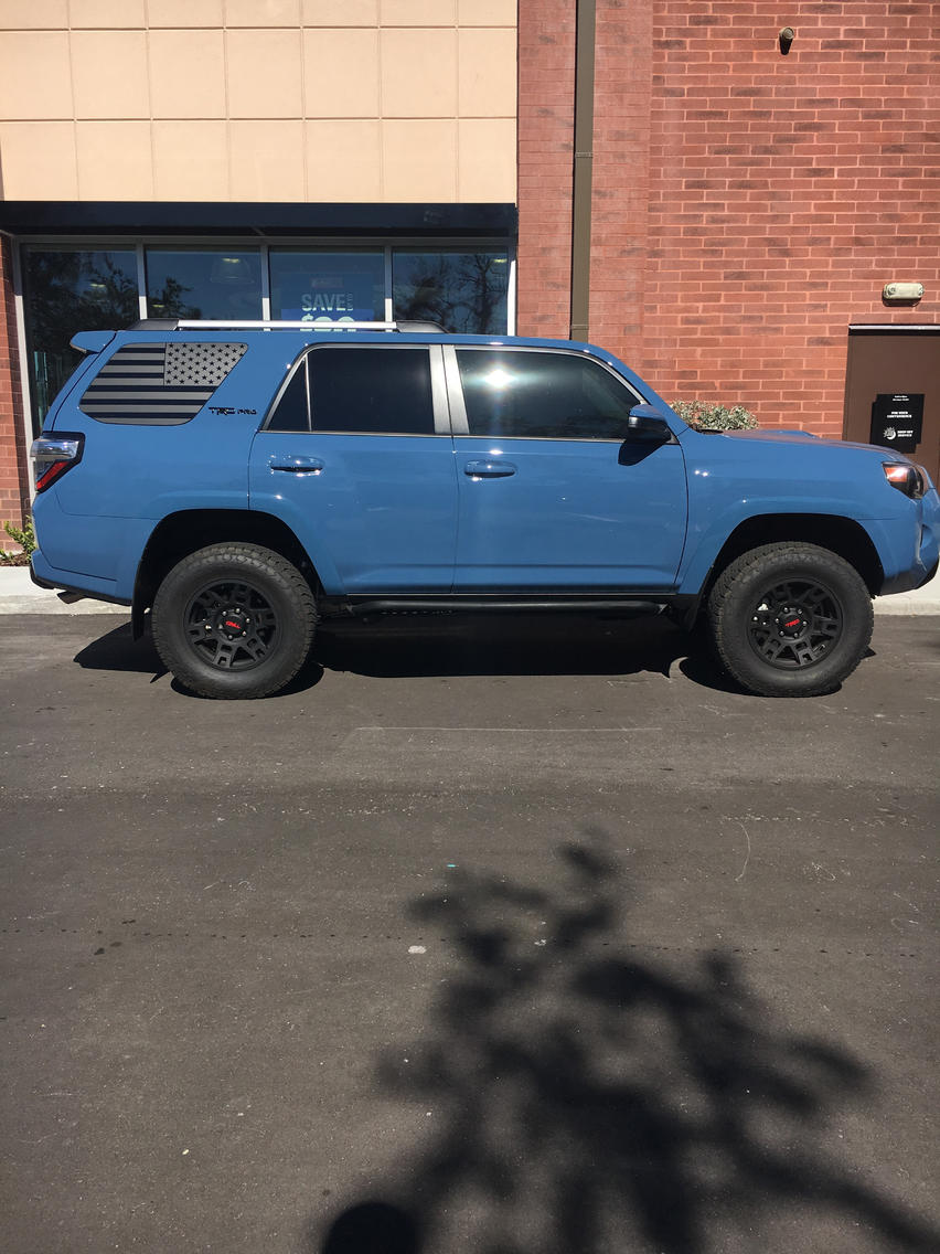

Here ya go. They measure closer to 32" than 33' IRL, set at 37 PSI right now.
My pro is lifted an additional 1.5" in front and 1"ish in rear. No rubbing, really not even close so I'm debating wheel spacers to give it a more aggressive stance. Hope this helps!
Edit- Added a picture with the mild lift with the stock 265 Nittos for comparison

based on BFG's webpage the savings is almost 8lb (58.16 vs 50.33) Substantial for sure. I noticed this on their page a couple weeks ago. No timeline on when the orders will be filled, and I'm waiting patiently as my 275's will need replacing this spring.

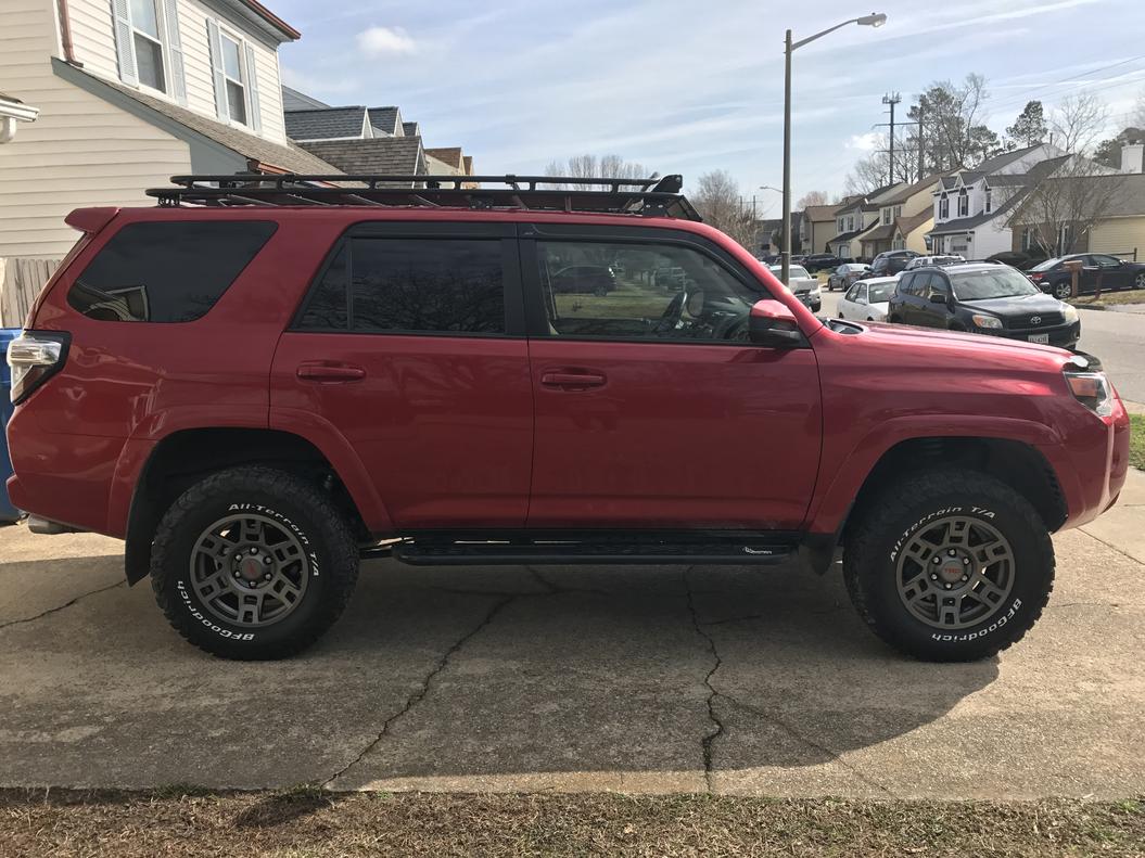

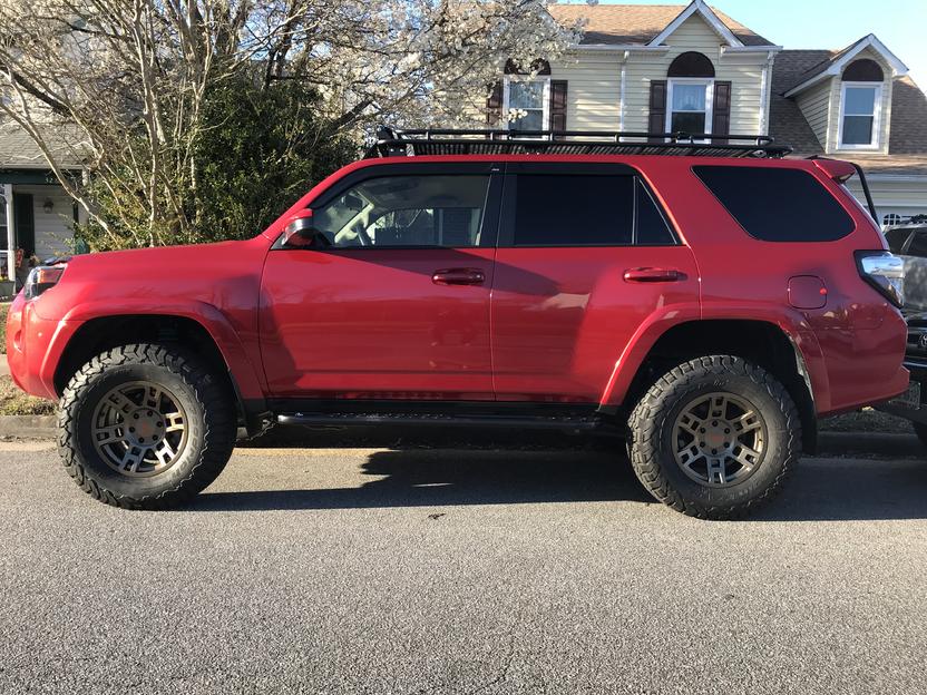

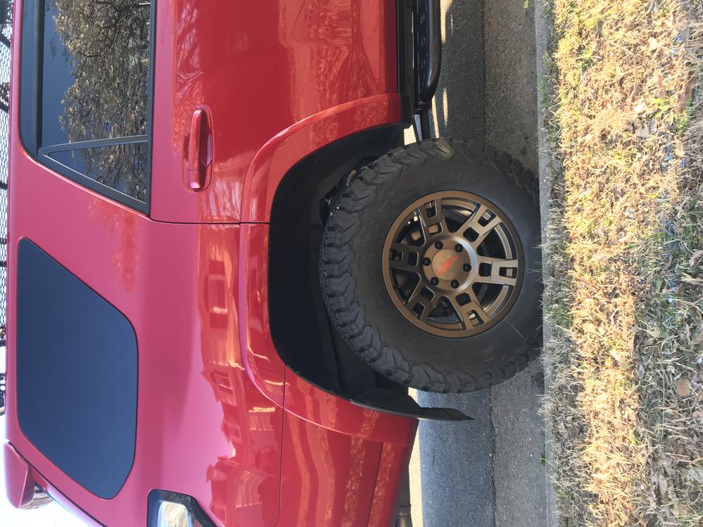

I found some C load 285s, 5 for $750 with 1,100 miles, zero miles on the spare from a 2018 Jeep Rubicon takeoffs. Rides like my 265s, zero complaints. I do miss my raised white lettering. Mounted them to a bronze FN Pro wheel.
