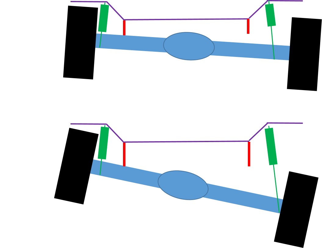

Now that I think about it more the bump stops might not be required. I keep getting myself confused. I have the 3" stops, but my tire ends up a few mm from the bumper at full flex. However, since I have the LT my axle angle is totally different and therefore puts the tire at near the same location it would be with standard travel and no stops. It just gets confusing since there is such a difference between vertical and articulated travel.. with a solid axle. Increasing your down travel actually increases your articulated up travel and the tires size that will fit (even though the vertical up travel is limited by the bump stops). Does that make sense?

the rear control arms on the 4Runners are so long, your long travel rear shouldn't be affecting your tire placement much. if you have your metal tech arms at a length that places the rear axle in the same location as factory, at full droop the arc path of the rear axle would be 'sucking' it further towards the centerline of the vehicle. since you are running longer bump stops, the reverse of its arc upwards wouldn't be as substantial as a stock units as your rear axle reaches the level apex of the arc, pushing the tire further away from the centerline of the truck.
I think you are talking about side to side and forward and aft movement (or I'm just lost). I meant the vertical position of the tire to the fender in terms of the larger diameter tire. This is what I was attempting to describe (pardon my quick and dirty diagram). More down travel on one side results in more articulated up travel on the other even though vertical up travel would be much less due to the longer bump stops.
Oh okay, yeah - I misunderstood what you were referencing. And yes, you are correct. However, the bump stops contribution is very minimal compared to the extra droop you're getting from the LT shocks.
