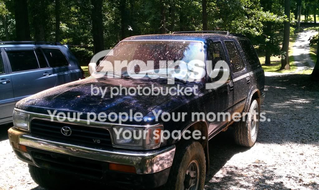

Just seen this thread for the first time so forgive the late entry... I bought mine for 125$, not running, put 360$ into it to get it street legal. That constant tic you are hearing is possibly the cold start injector, as they almost sound like a rocker arm ticking. If you are in that area of NC, you are in Austin's neck of the woods, who is a great guy, pretty knowledgable. I will send him a link to this thread. I run an inverted knock off magnaflow. Good rumble without being piss your neighbors off loud...
http://static.photobucket.com/playe...com/albums/ll43/Nitewulf_photos/VIDEO0012.mp4
IMAG0380.jpg~original
