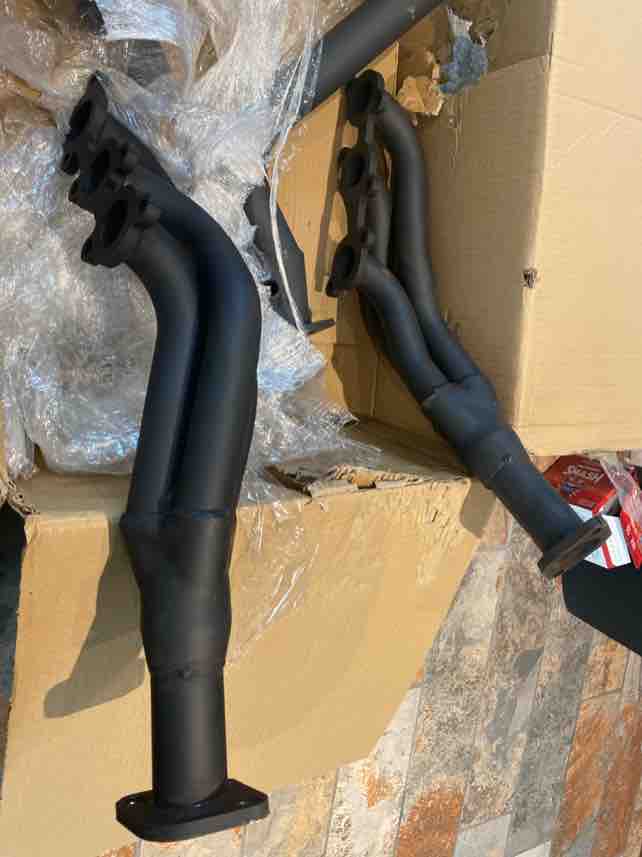

Well I ordered them any way. I can weld and modify them as needed. I will keep y’all posted with pics. Delivery date is Oct 4. Just got my heads resurfaced and going to start putting her back together.

Got the headers today. They look like they will fit no problem. Exhaust studs line up perfectly 68504522845__0A681038-98C8-41B9-B9CC-61D7190BC6F3.jpg

What are you going to do about the upstream oxygen sensor since it will no longer be reading both exhaust banks?
This is the part I’m interested in, I’d imagine you would need some sort of X pipe to put the sensor in since I don’t think you could make two sensors work
as far as I know, he will be ok by reading only 1 bank of the two no problem. You read 3 cylinders and assume the other 3 are at the same ratio. Some people have been running like this forever.
I’m going to do an H pipe to allow for more even flow of exhaust. Oh and btw they fit like a glove. Haven’t bolted them in yet, just mocked them up.
Cool they fit! Have you test-fitted the included Y-pipe?
