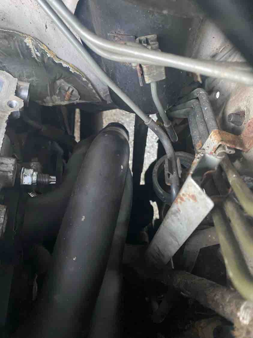

Cool they fit! Have you test-fitted the included Y-pipe?
I wonder if using an equal-length Y would give it a nice, smoother tone like the newer Tacos with an equal-length Y.
No I’m not using the Y pipe. Going to cut the ends of the headers and weld V bands on and connect them with a fabricated H pipe and run true dual exhaust. Installing an o2 sensor on the h pipe and a mini cat on one of the exhausts
You’ll need the first oxygen sensor to be upstream of the catalytic converter
Yep. It will be. Waiting on a side job to get the rest of the parts. Got the header flanges cut off and the first V bands welded on. Stainless steel exhaust pipe is kinda pricey lol

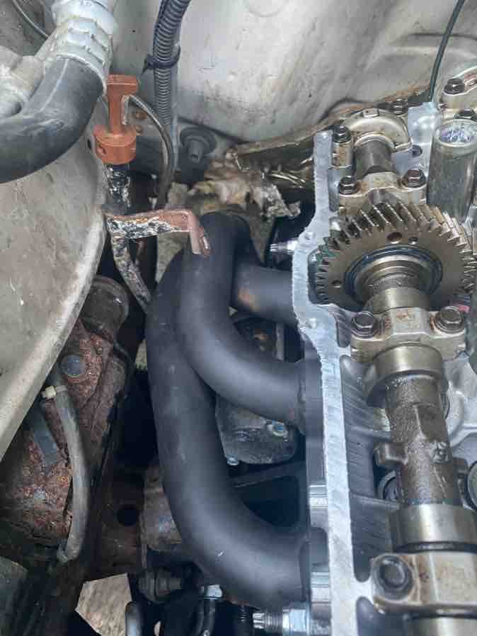

Got them installed the other day. Just waiting for some more funds to become available to buy the rest. Does anyone know about valve clearances? I thought you always checked with the lobes facing up but what I’m seeing on videos is different.

Correct, up or sideways, as long as the lobe isn't touching the shim. The book has you do it in 2 (if I recall) passes, rather than moving many times to get every lobe straight up, but you can do it either way
What I wouldn't give for a lift and tube bender in my shop, or else I'd be right behind you :lol:
I see some daylight between the pipe and the steering shaft! I think you got it.
Yes lobe pointing up or at least higher than the 9 o'clock or 3 o'clock positions. If it's facing any lower than that the cam lobe starts to taper and you'll get a bad measurement.
