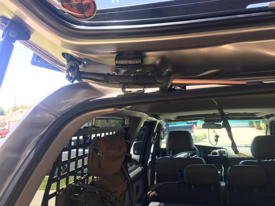

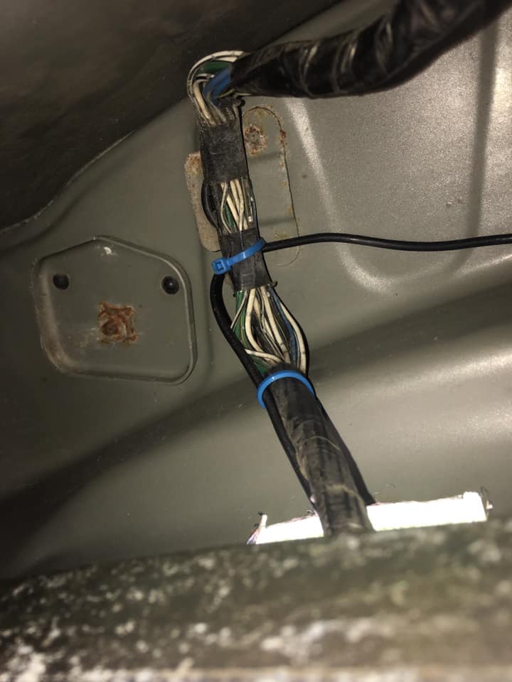

10) Locate the wiring loom between the tailgate and the roof of the 4Runner. Using a flat head screwdriver, pop out both rubber/plastic housings that attach to the 4Runner.
11) Gently twist the metal tube (I used copper) through the loom, so you don't damage the existing wires (SEE PHOTO #1)
12) Once you have the metal tubing through, approximate the amount of wire you'll need by starting at where the cargo space courtesy light is and "running it through the loom" down to the very bottom of the tailgate.
(Have some beer)
13) Cut 2x wires at the length you determined from Step 12 (one will be your (+), the other will be your ground)
14) Run the wires, one at a time, through the metal tubing thats wedged inside the rubber wiring loom (Make sure you are able to know which wire will be your ground and which will be your (+). I used a small piece of tape to distinguish the two)
15) Once done, remove the metal tubing carefully, making sure you don't remove the wires you just ran through there

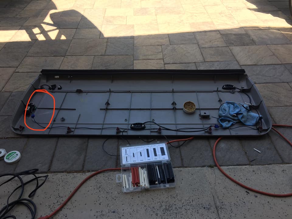

20) The light furthest away from the driver side, measure out 2x pieces of wire the length of the width of the tailgate. SOLDER one wire to the light closest to the passenger-side light to its (+) and ground wire. Use heat shrink and heat gun as needed.
21) On the open ends of these 2x wires, attach the male end of the T-taps to both the (+) and ground wire.
22) Attach the T-Taps to the ends of the 2 wires from Step 18. Make sure you know which one was (+) and which one was ground.
23) After completing Steps 21 & 22, this creates a "quick disconnect" to gain access to inside the tailgate, should you ever need to. (SEE PHOTO #3)
24) Using splice pieces, splice the remaining lights into its designated wire (+ or ground) from Step 20. (+) splice to (+) and ground to ground

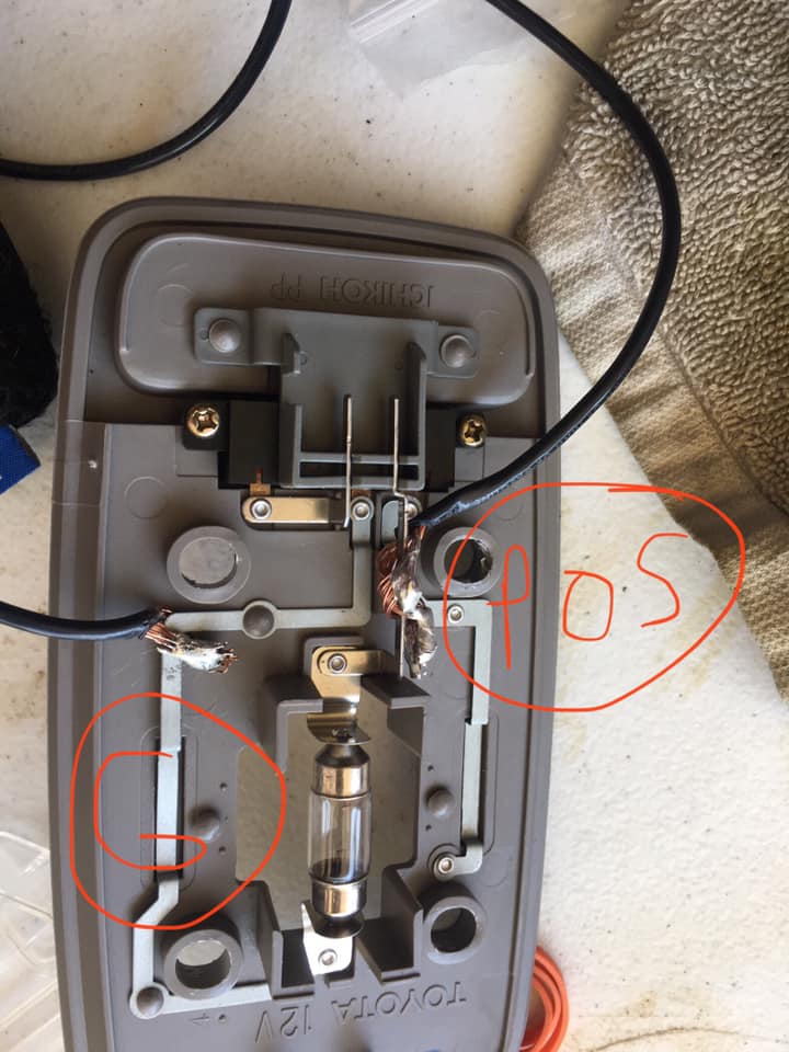

25) Now go back to the ends of the wire closest to the courtesy light switch from Step 14. Grab the physical light switch, as you will be soldering the (+) and ground wires to the topside of the switch (see picture). NOTE: (+) wire is the center piece and grounds are the small flat metal pieces. (SEE PHOTO #4)

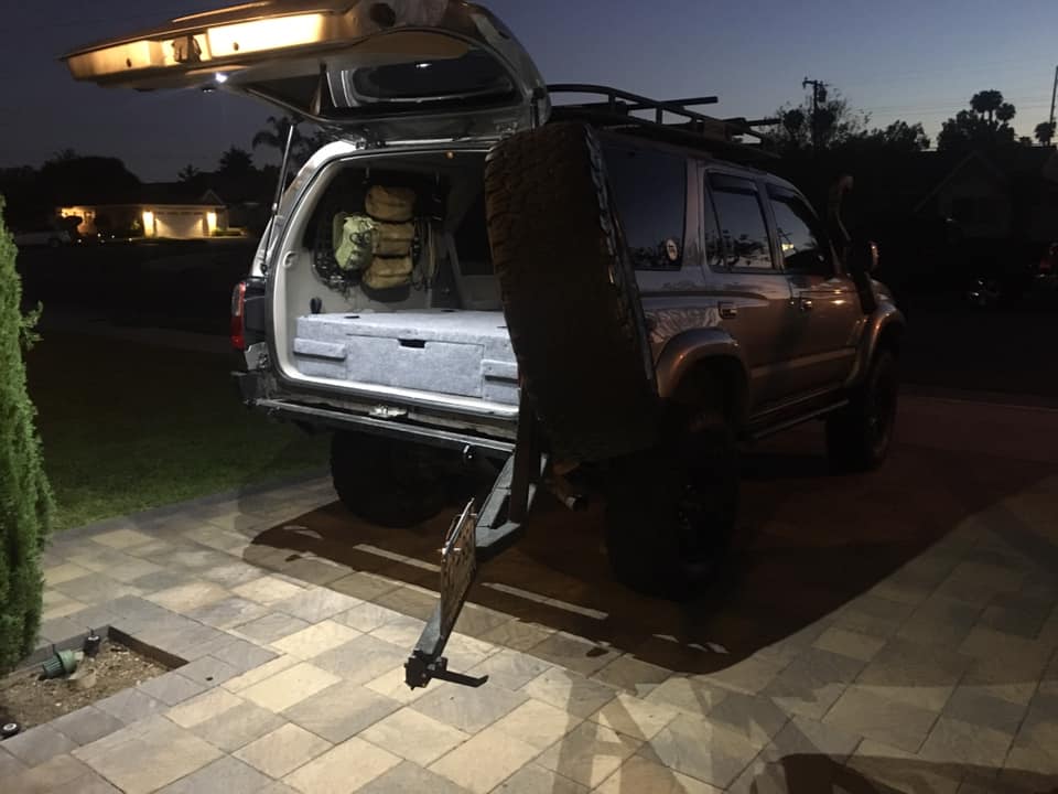

28) Once done, test the light switch. If it doesn't work, you will need to check all your T-taps, splices, and soldering points. I cannot help you w/ this.
(If you are stuck, it may be because you drank a beer everytime I instructed so. Sober up and retry Step 28; if succesfully done, have a beer)
29) Once you confirm that it works, you can unscrew the light switch from the roof and pop in the interior trim that you removed first. Feel free to use tape or whatever to make the wires on the backside of the tailgate interior panel less crazy.
30) Pop back in the tailgate panel and use the 10mm socket wrench to tighten the pull-handle back in it's designated spot. Pop the cover back on. Waaalaahhhh! Sit back, relax, and enjoy the fun little project. Oh, and feel free to Venmo me beer money too.
