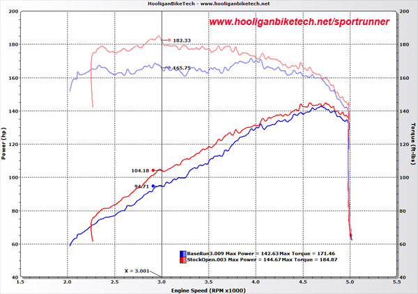

I highly recommend removing the stock air intake elbow or doing the deckplate mod (the results are basically the same). The intake elbow is held in by two 10mm bolts on the passenger's fender. Wiggle it out (there's a tab opposite the bolts) and ta-da, you just gained power.
Gains peak +10HP, +16TQ at 3000 RPM. That's for a stock 4Runner too! Props to Speedy for dyno'ing his:
If you want to chase more power you can check out my build for ideas. Other simple things you can do is an Airaid intake tube, high-flow dry filter from aFe (don't go oiled if you plan to off-road), and doing simple things like cleaning the Mass Air Flow sensor and replacing the front Oxygen sensor.

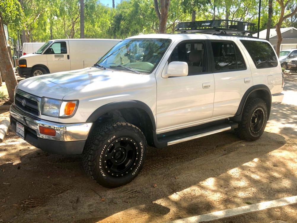

my beast...
Here's what I'm working with. Great truck as a base.

Thanks again for this insight Mayniac. Much appreciated. I was looking at the Bilstein as well as the Toytec suspension. I’m going to look further at your recommendations. I wish I was more mechanically skilled, especially for the big stuff (under carriage).
