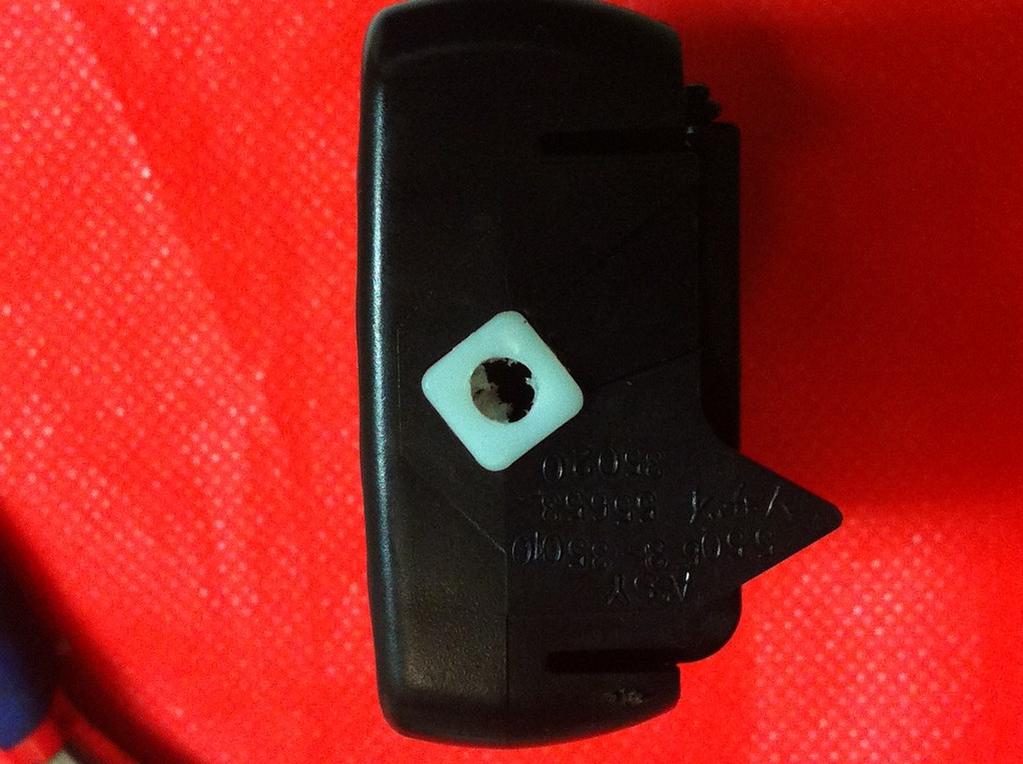

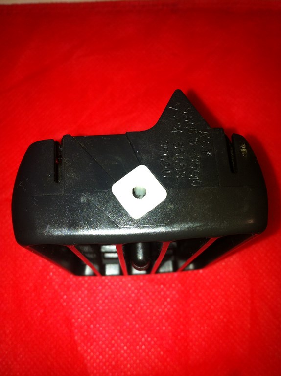

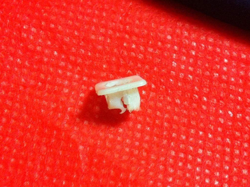

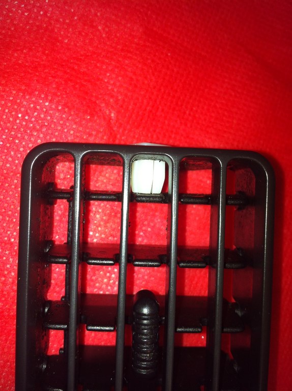

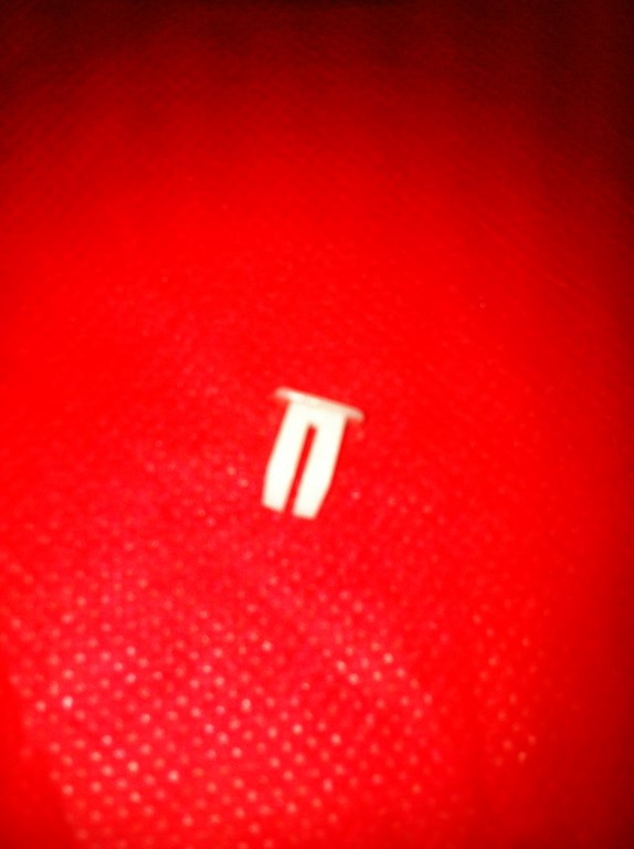

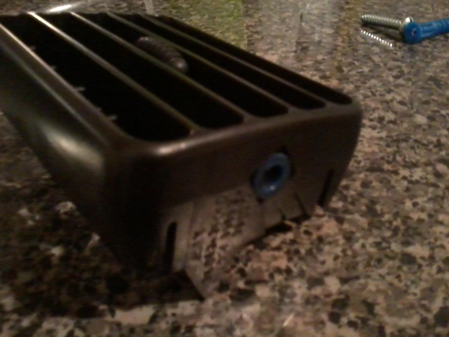

I was looking for a fix to the floppy ac vents and for less than the $30+ that Toyota wants for a them, each or hunting them in the scrap yard. My solution is below and hope it helps someone out and I apologize if it has been done and I didn't find the post before.
I have more pictures of the process but see that I have only 8 max uploads. I put the ones that I hope help illustrate what I did. If you need more process shots, PM me.

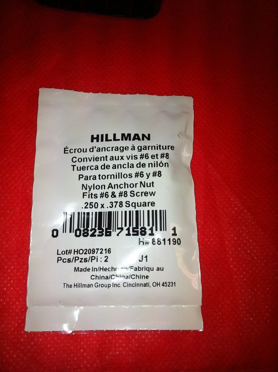

I picked up my parts at Lowes in the hardware section in the drawers with specialty fasteners. I picked up 2 packages of Nylon Anchor Nuts for #6 & #8 screws, just in case I messed up one, at 92 cents a package. They come in packages of 2. So technically it cost me $1.84 and tax. :)
They fit right into the square opening on the ac vent. They don't snap in but do fit nicely into the square cut out and I used glue to hold them in.

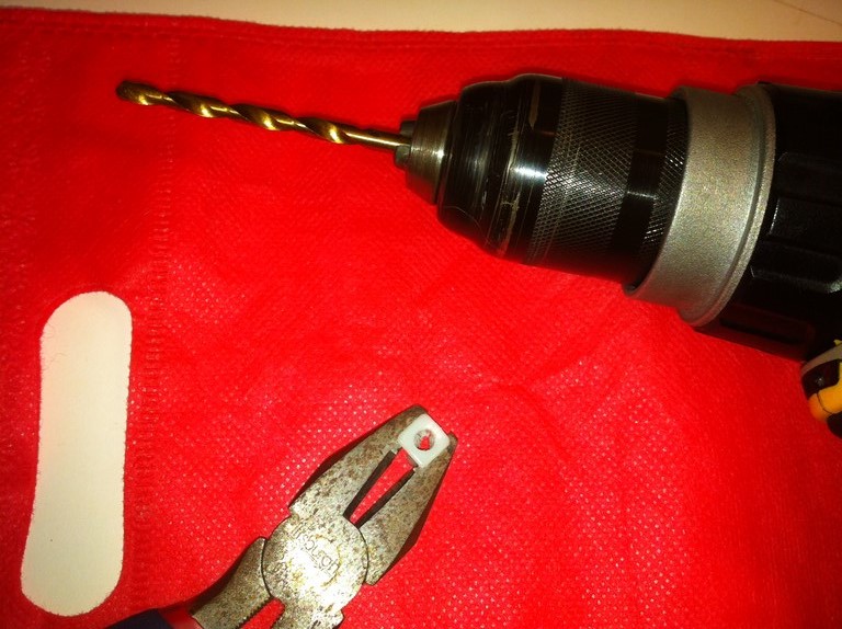

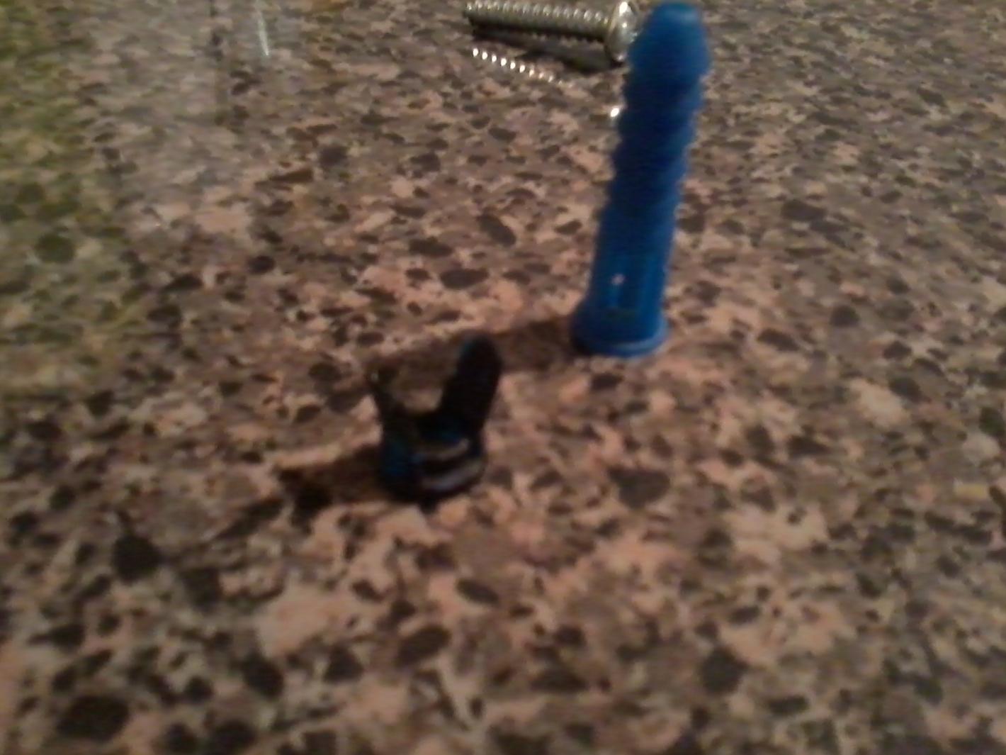

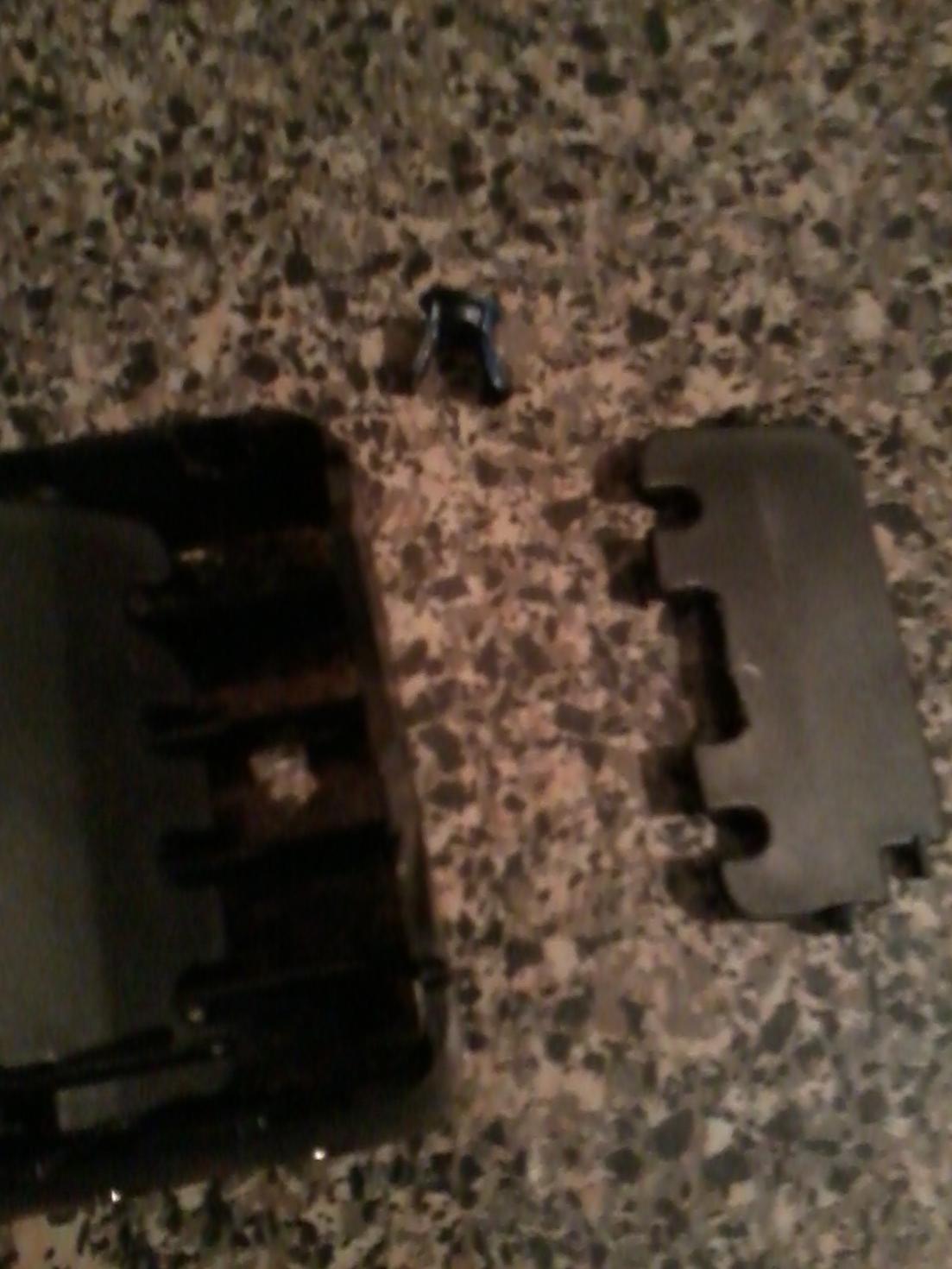

I needed to drill the hole a bit bigger. I used a 3/16th inch drill bit and after drilling it straight I had to wallow it out a bit more for a good fit. I held the nylon nut with pliers so as to keep the prongs from spreading out and distorting the nut. Take it slow when drilling or the nylon will just bend out of shape.
Once I had the hole the size I wanted, I test fit it.
Next, in order to not lose any or very little vent directional positioning, I snipped the prongs down to my liking.

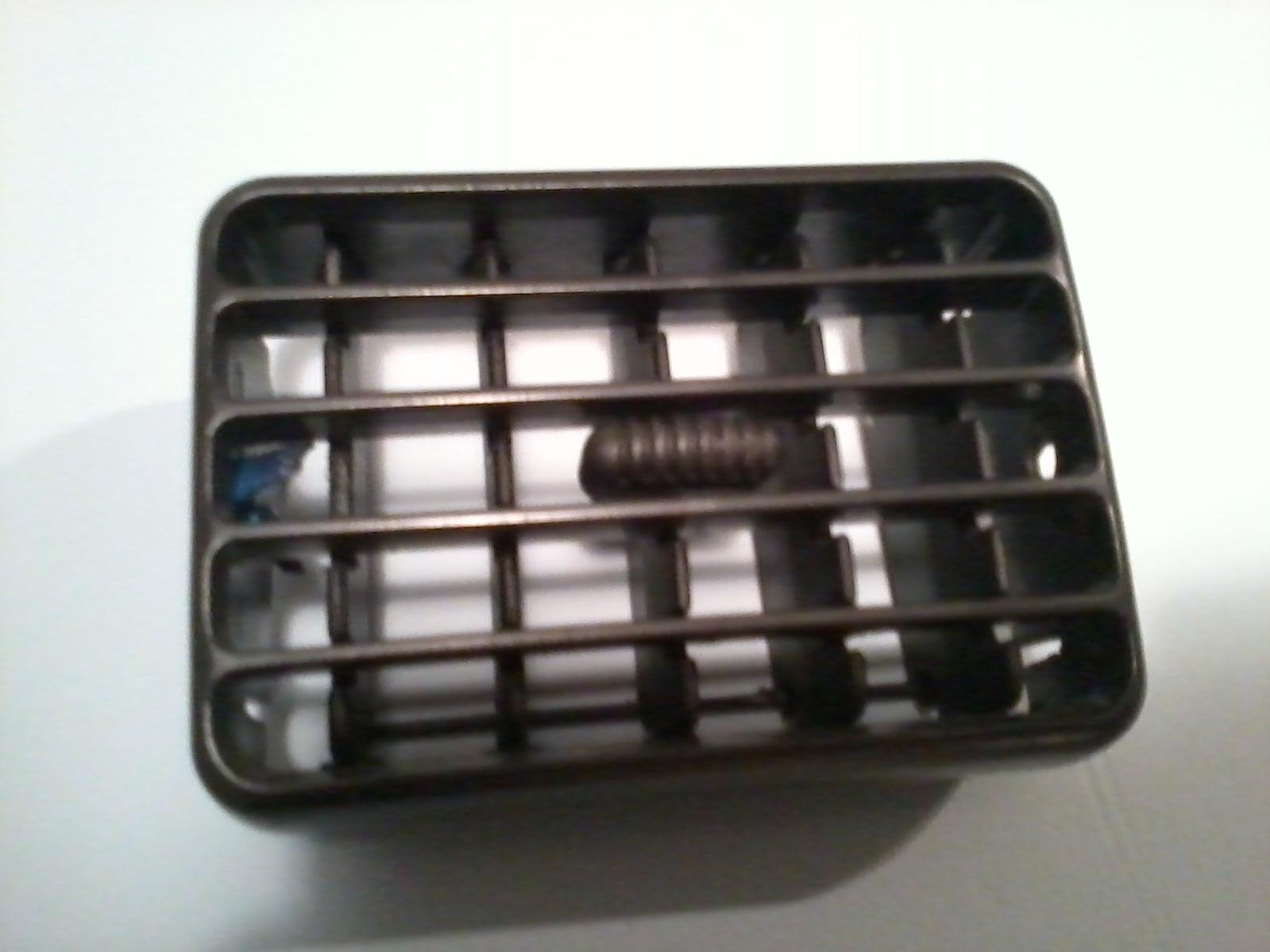

I glued the nut in place and added a spot of black paint for aesthetics. In my picture though it is white.

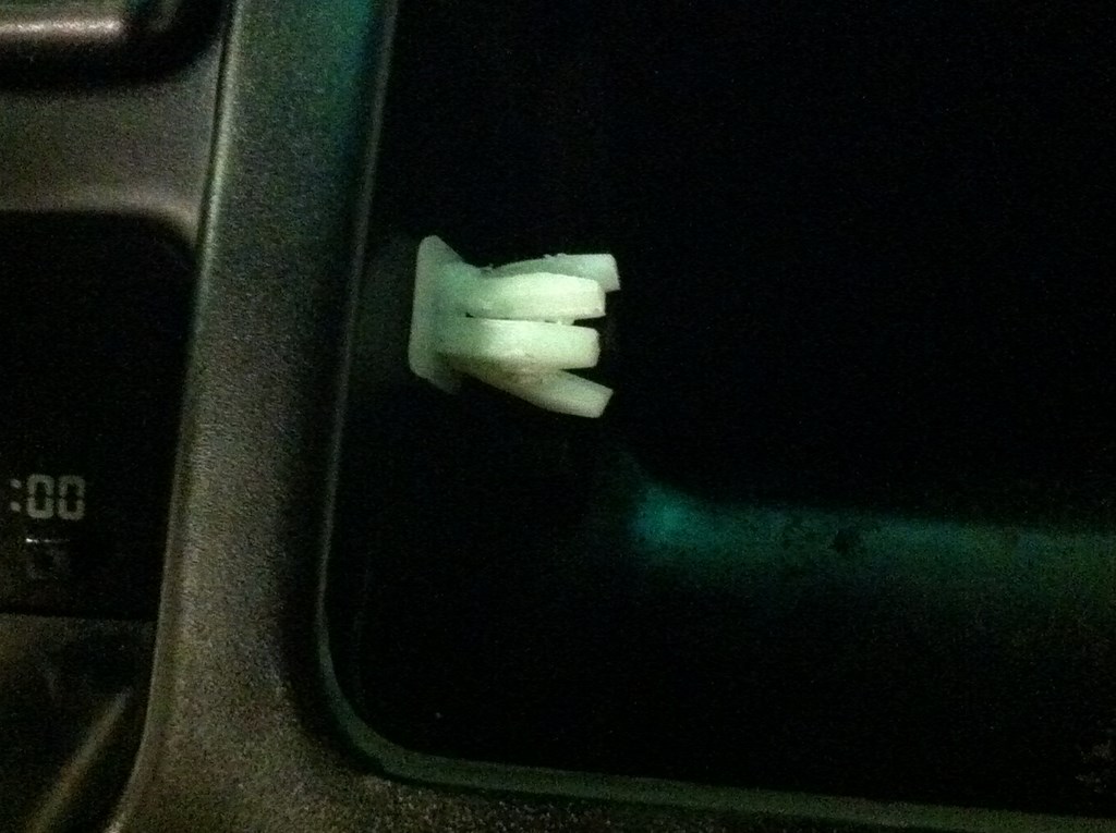

Let it dry or cure and carefully install. It was a bit snug to get it into the pegs as I guess the original square inserts were more flush. But once it was in, the floppy vent issue was no more.
Hope you enjoy.
Ken

I used back cap of a used pen pointer, an 'o' ring that did the job perfectly. Just used a cutter to shorten the length of the back cap so that it does not hinder directional vent louvers and drill it to desired size. Very easy. Fits perfectly. I put the o-ring on the other side of the main panel. It took me half an hour once i figured it out the materials to use.
Anyone who has a similar issue, I would certainly recommend at least try this once. No need spending on getting a new vent.
