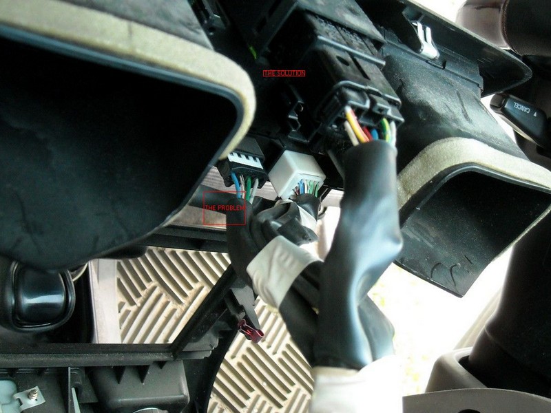

I am so confused now....I just went and tore the dash apart to get to my clock and found that there is NO wires going to the back of my clock at all. There is a 4 pin receptical on the back of the clock...but the freakin' wires aren't there to plug into it!
I don't remember ever tucking them away during my stereo install. Are they bundled up with tape along with the other wires going to that center piece of dash trim (the power back window switch, hazard button and a couple others...defrost maybe, I don't remember now)? There is white tape around that bundle of wires, and it doesn't look like they have ever been untaped.
Weird....
Weird....
I looked at mine this week and had the same problem, the wire was plugged into the dead spot behind the rear window switch. But when I plugged the clock in it still did not work.

Dirt4dinner and jdmidwest - I noted the dead clock harness port in my write-up. Past clock threads have mentioned it as well. Don't feel bad; there have been more than a few ppl who've found that theirs was plugged into the wrong spot!

Well, I'll be darned. This looked simple enuf, so I went to take a look and it worked just as you said.........popped the panel off, looked behind it.....and no wiring harness or plug to the clock. Looked all over with a flashlight, even pulled the radio out, nothing. I'm amazed and baffled. No cut off wires, nothing folded back out of the way.......... I dunno.
Lar.
Lar.
Your are the umpteenth victim of the dummy plug. Your clock harness is plugged in to a blank hole in the center fascia--I think its lower and to the left of the clock. This does not mean it plugging it in will fix the clock, because this often happens when someone is trying to fix an already broken clock--but it might.
