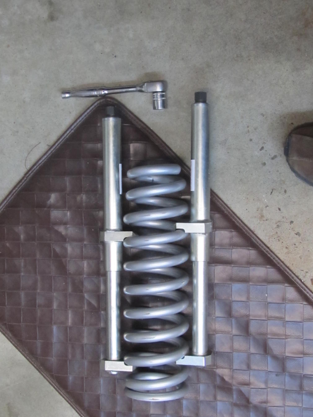

The drop bracket will work fine. Installing everything is quite easy provided you have decent spring compressors and a welder. I'd be very careful if you're going to use harbor freight compressors, they seemed quite iffy even with the stock springs. If you happen to know someone that works at a BMW dealership, see if you can borrow these ones.
