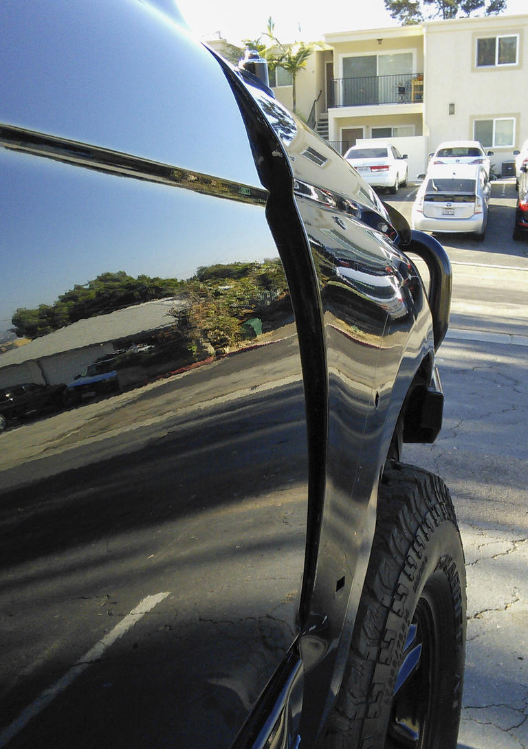

I can confirm that with 285-75-16 tires and stock 5-star wheels you do NOT want to run spacers. This is because the backspacing of stock 5 stars plus spacers makes the tire stick out too far. Once you go offroad and fully articulate you will damage your fender.
With 265x75x16 and stock 5 stars YES run spacers but not with 285s.
I had the 16 inch stock steel wheels when I had toyota wheels on the truck. And I never had any issue with the tires rubbing the fender. Don't have any experience with the 5 stars so don't know about those. I would take his advice from the looks of it.
The sizing was mostly fine until I came down hard on the front end, basically bottoming out to the bump stops. The tires pushed my fender up and popped off the flares on each side.
The tires were just sticking out waaaay to far with that setup and I should have realized it would be a problem.
