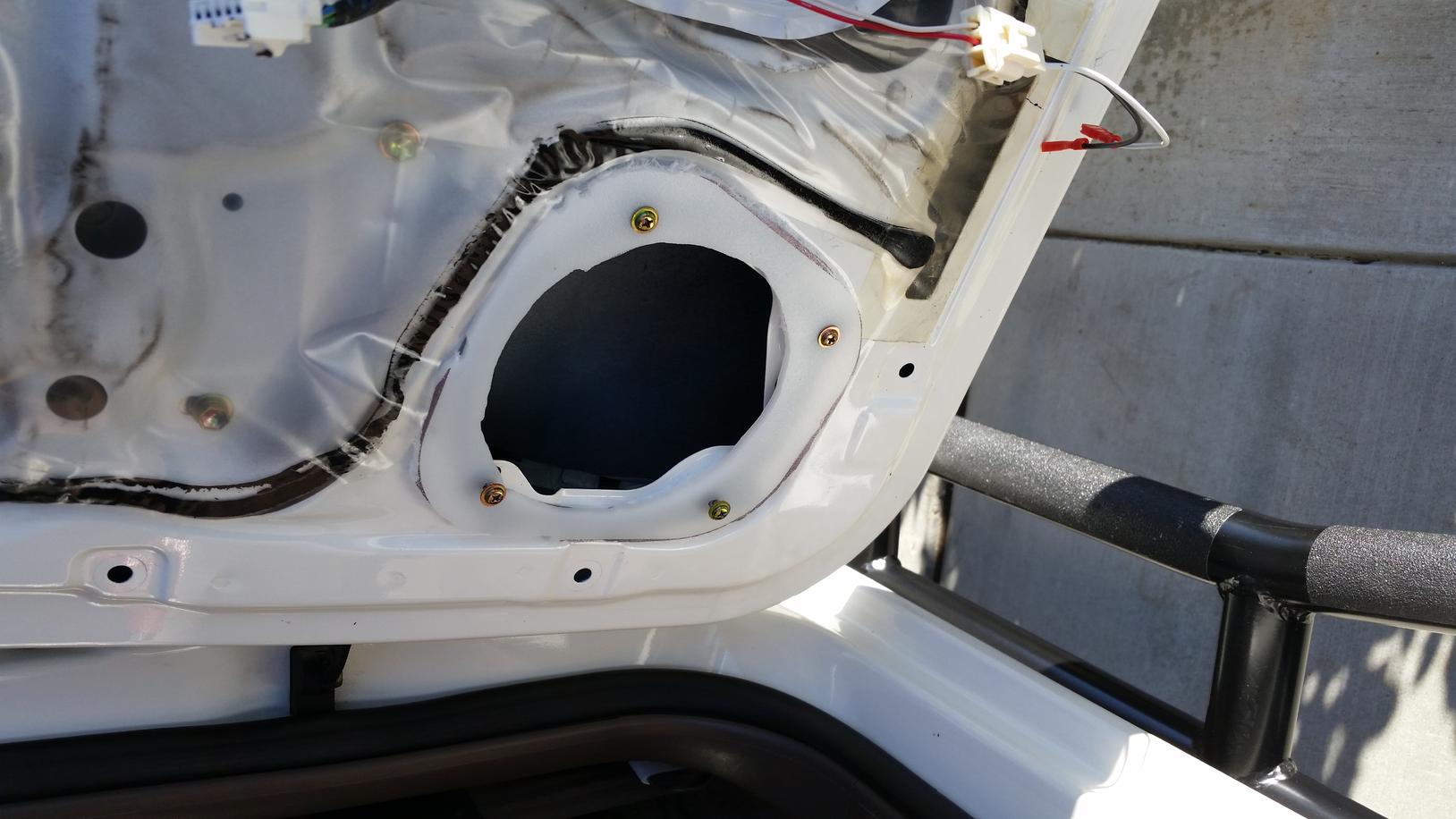

Once you decide on the speaker it is first necessary to mod up a spacer piece. It's possible to order them on-line but I found a cool suggestion; to simply Dremmel them out from cheap cutting boards (under $2. each !). Holding a steady Dremmel isn't easy with the material but I did manage to get it well enough for sealed fitment.
I mounted the spacers using the original factory mounting points in the door. Two of which I also used to pick up two of the mount locations on the speaker frame. The remaining two speaker mount locations didn't align with the factory position so I drilled and screwed those into the spacer. In addition I added Tacky Butyl Sealant tape to both the spacer to door contact and the speaker to spacer contact. This stuff is great and not only seals it tight but also has a holding power to it.

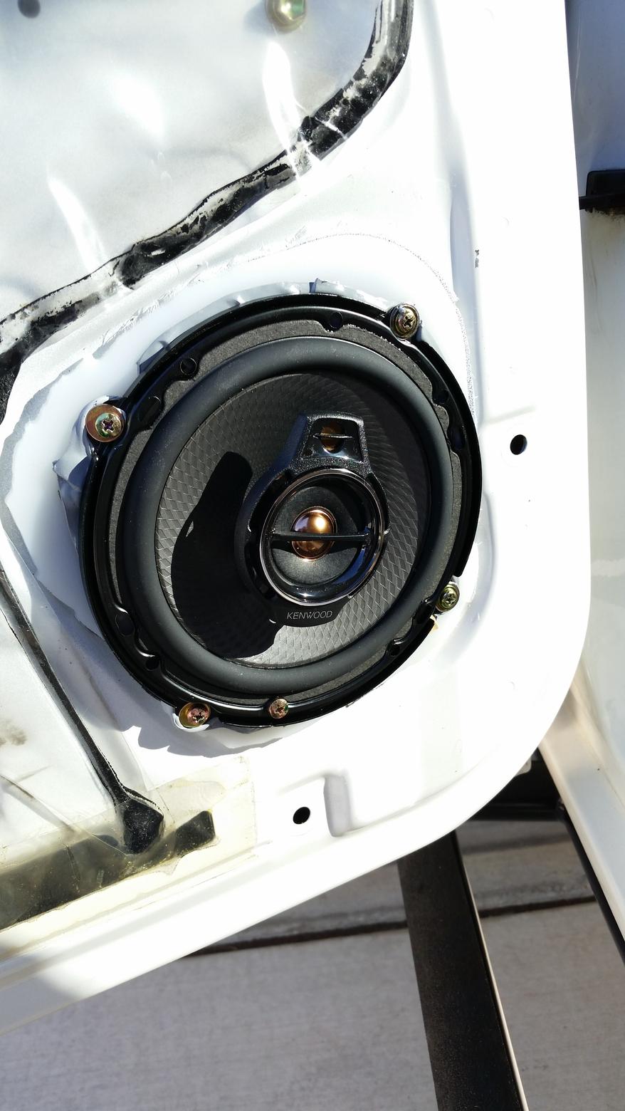

The final fit is perfect. The windows don't touch the speaker magnets and the door panels clear the fronts with room. The final product is amazing with quadraphonic sound in 6.5". In fact when I installed the HU I removed the factory amp with the intention of adding an aftermarket. But with 20RMS on this Sony and the 3Way 320w (max rated) Kenwood's, I don't think I even actually need to add an amp after all. The sound is so deep and rich and it completely fills the vehicle. By the way, if you are doing a stereo upgrade be sure to buy the Metra harnesses, it's the only way to fly...

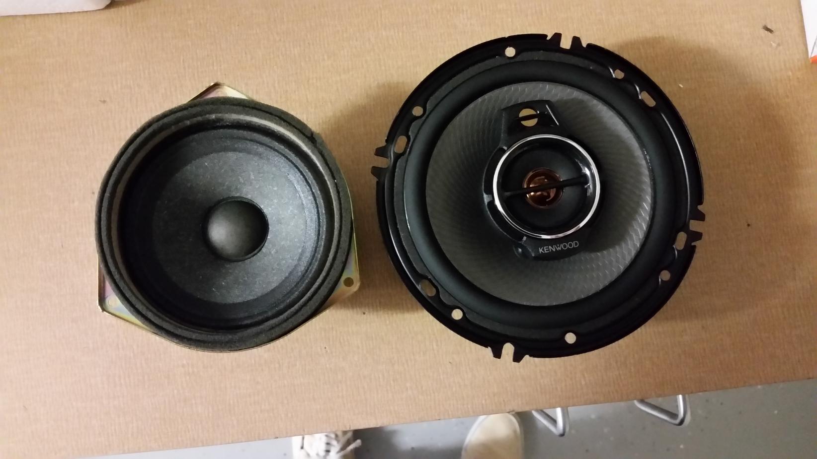

Here is the original 4" next to the new Kenwood KFC 650.

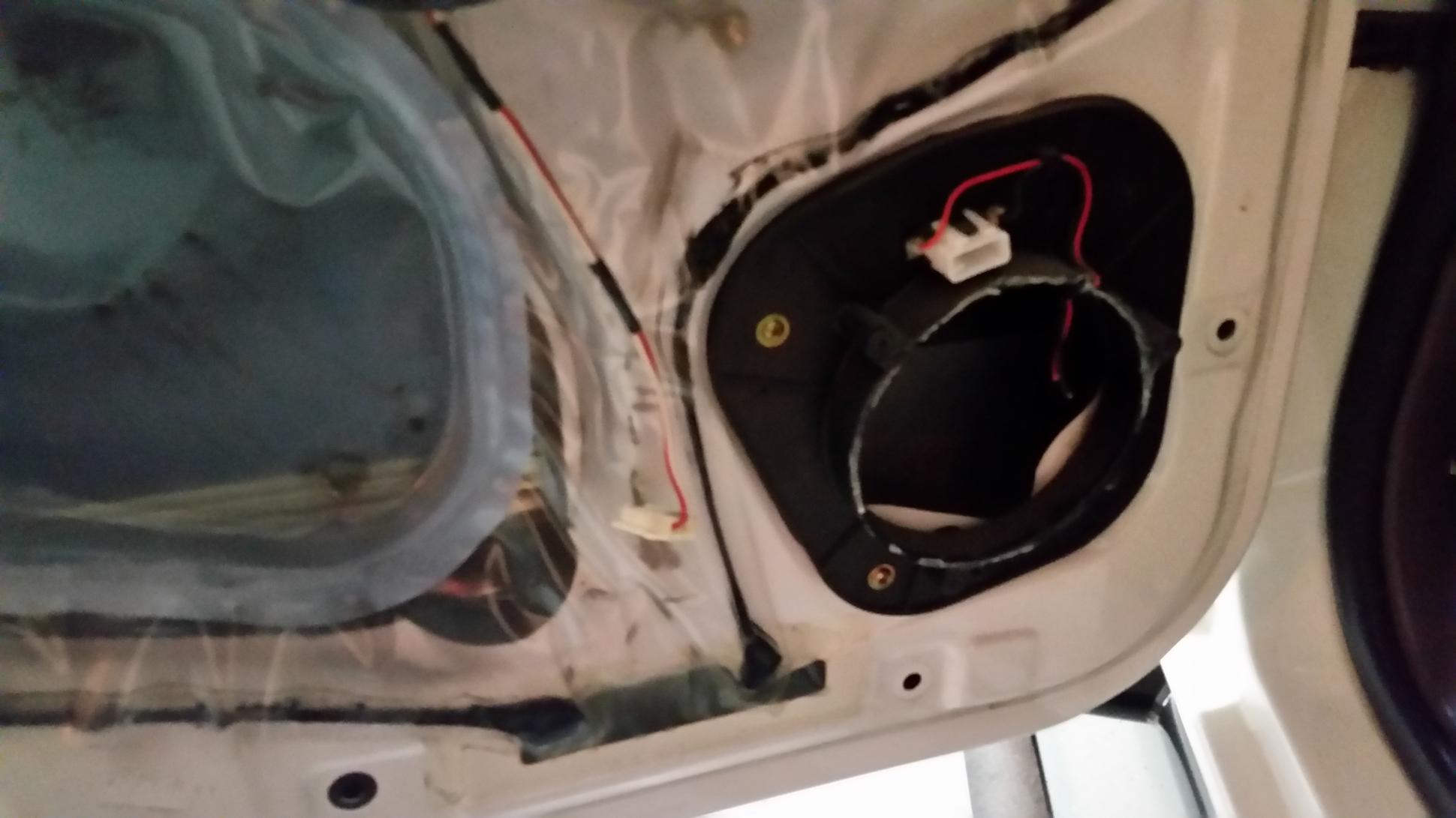

This is the factory mount/spacer that the 4" comes out of. Remove this.
New spacer installed.
Final fitment 6.5" rear door.
