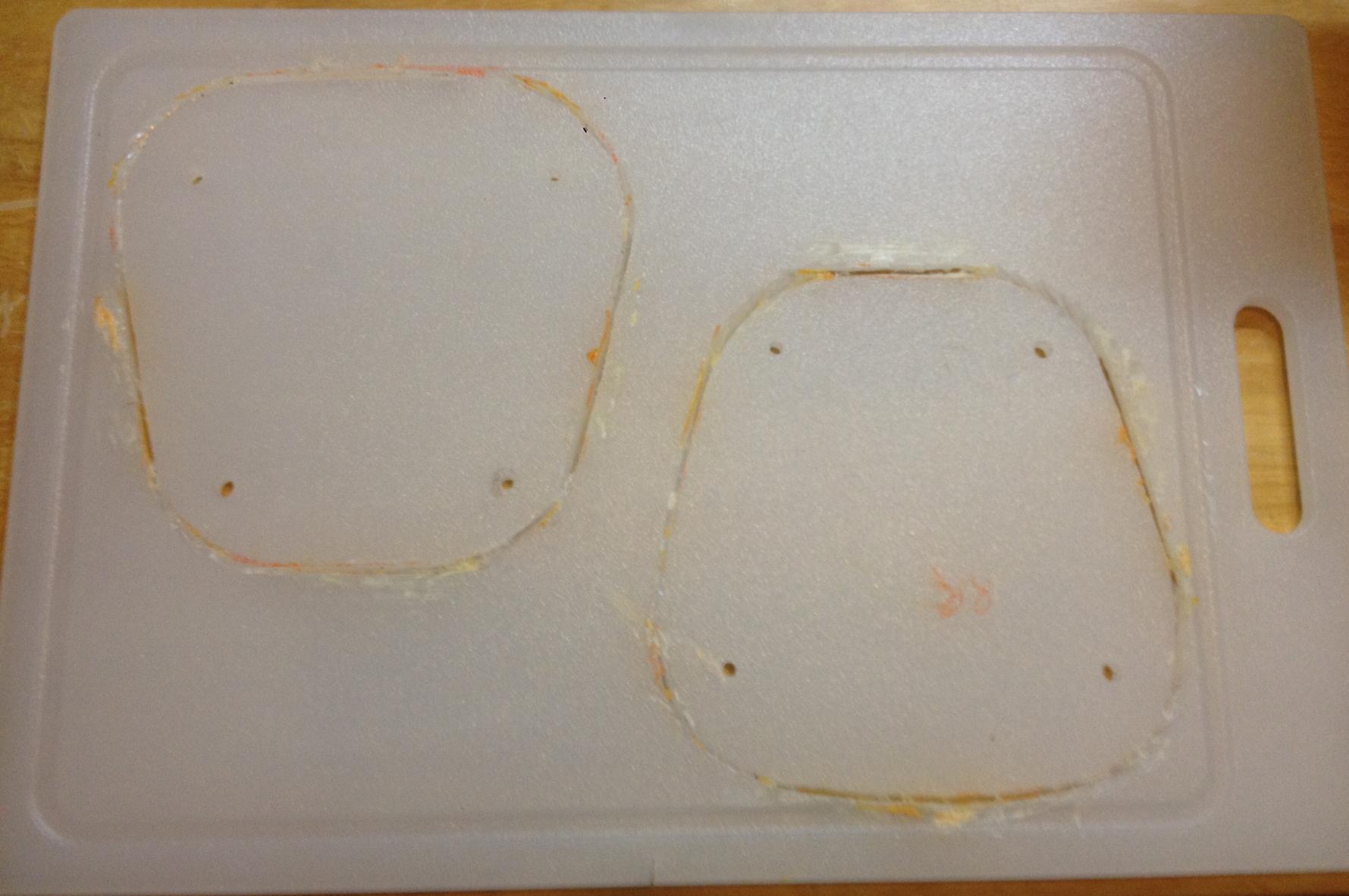

I did pretty much the same mod but I used a Mainstays 5/16ths thick cutting board that you can get at Walmart for $10.00. I used a thicker one to keep the magnet closer to the inside of the door as possible.
I used the factory speaker holders to trace the shapes on the cutting board. I used the drill to drill the holes first, then used the cutout on the Kenwood KFC650 box to trace the speaker cutout hole. I used my dremmel to remove that material.
I went a step further and cut the hole in the door a little larger using tin snips and a file to smooth it down- just in case.
I used 3M 5/16 ths ribbon tape to seal the cutting board bracket to the door, and stretched out a piece to place in the speaker hole on the board to keep the speaker "clued" on the board. This not only seals the whole thing, but it helps keep the speaker in place when your mounting the bracket to the door.
And with the thicker bracket, I needed longer screws. I went to lowes and bought new stainless screws. 12 x 1 inch.
I also had to trim the inside of the door panel near the top part of the rear door map pocket to make sure nothing touches the speaker. You can stick your head in that pocket and see the speaker a little but you wouldn't notice it if I didn't tell you most likely.
I hope my contributions help someone make this mod a little clearer.

Pretty much how I made mine in my thread on fitting the 6.5's. I used 1/4" acrylic and hand fabbed them, then made a digital model and used a laser cutter to make a few sets that I've sold on the forum. I had to counter bore the lower mounting holes so that the speaker will sit flat on the adapter, did you have any fitment issues like that?
