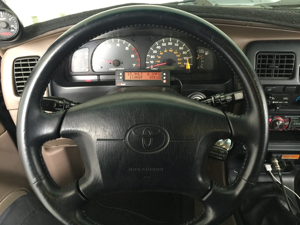

I went on a search for 4Runner steering wheel swaps. There are wheels out there from Toyota that seem a lot nicer than our current wheels, and well, mines cracking anyway. Searched Yotatech, found a thread from 03 about the same idea. I can imagine that Toyota, with their consistency of using the same style parts, would have another steering wheel that could directly swap into a 3rd gen.
My reasoning behind it is that I'd like to keep an airbag and I'd like to have steering wheel controls, all the while having a nicer, sportier wheel. My mom has a 4th gen, some suggested using that wheel. After some thought, I've decided the steering wheel in it is atrocious. Aftermarket radios, such as the Kenwood DNX7100 installed in that same 4th gen, accept steering wheel controls from any brand vehicle. I believe it's a 3.5mm jack, anyway.
For example: This is the Corolla, Celica, Matrix wheel. I have seen these swapped into Tacomas before. It is cool, though it does not have steering wheel controls.
My favorite and #1 choice so far is a new Rav4 Steering wheel. If I could swap this into a 3rd Gen 4Runner, I think we could have a new mod here. It's a sweet looking wheel, and I'd be able to utilize the steering wheel controls with my aftermarket radio. Sure, it's got a lot of other buttons we wouldn't be able to use, but it still looks good. Maybe a Toyota Technician might know this answer.
Do these, or any other Toyota wheels with controls, fit the spline shaft (or whatever the wheel connects to) for our existing steering wheel, etc? I've never had my steering wheel off, mind you.
Obviously, any other knowledge of steering wheel fitment is appreciated.

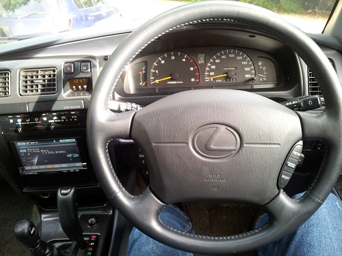

I can confirm that Celica and MR2 wheels fit from a similar age..
I also can confirm that a '99 LS400 wheel fits.
I fitted the steering wheel from my LS400 donor car as I thought it'd be kinda nice to "drive" the engine with the same steering wheel... that and I still had the disguising plastic 2 spoke one.
On swapping them, right over, the airbag plug is different on the Hilux/4Runner spiral cable thingy (for want of a better name) so I swapped the spiral cable thingy over from the LS400 and it was all a direct swap. It also provided wires for the horn, cruise, and other steering wheel mounted buttons, which I have not yet done anything with.
Luckily the colour match was perfect for my interior, and the LS400 wheel is exactly the same diameter as the factory Hilux one.. (although everyone says it looks bigger)
