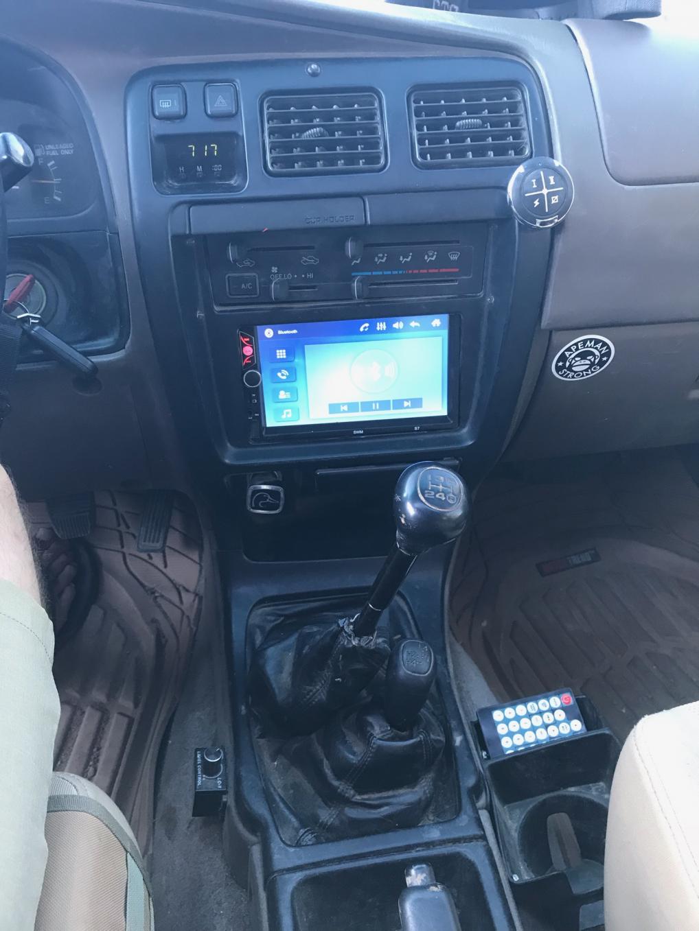

Just got and installed this cheap double din stereo last night and tested out the backup camera that came with it...
So what powers the speakers? The description doesn't mention output power or it is preamp only? Funny thing is china is still nice enough to offer other units as low as 39.95, not for long! :cowboy:
No I didn't test, I am going to get some T-taps and try again. My camera already has power, I tied the red wire from the video cable to the accessory wire behind radio. I can turn the camera on by hitting camera button on the radio. Just couldn't get the red wire on the taillight to trigger the camera.
Sent from my SM-N960U using Tapatalk
I believe it's just pre-amp. I have a 10' kicker sub on it's own amp and I replaced the old stock speakers in the doors with kicker speakers so I've never had an issue with with it not being loud enough.
The mounts took a little work to get the headunit to line up low enough with enough tilt to see while driving (Just drilled some new holes to get it to line up how I wanted), but for $50 I'm happy. Now I've got bluetooth, a functioning backup camera, and can view photos from the memory card off my Go-Pro while on trips. Plus it updates the look of the interior a little.

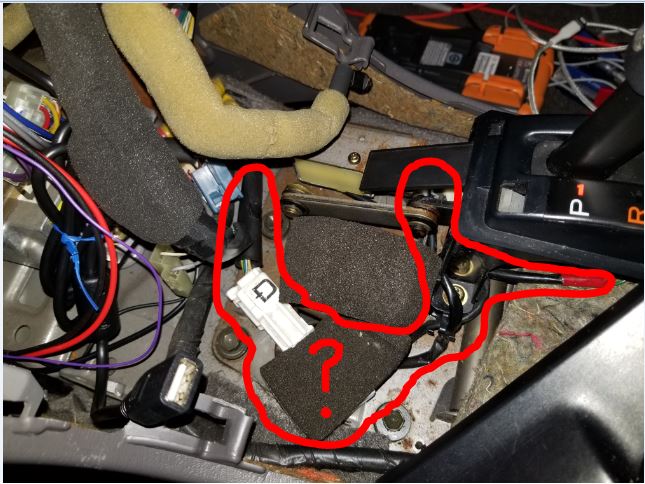

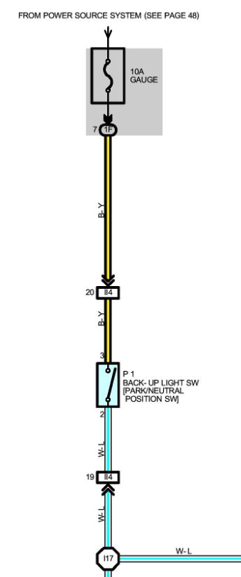

Is there no place under the center console to tap into the backup light switch by the shifter? Where are these other upstream connectors and switches including the L/R split at I17?
Also, where can I find wiring diagrams like this? These are extremely helpful. Is there a full reference manual posted somewhere?
