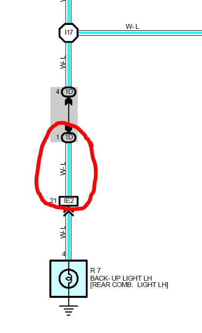

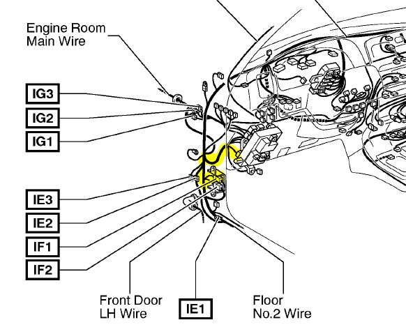

Is there no place under the center console to tap into the backup light switch by the shifter? Where are these other upstream connectors and switches including the L/R split at I17?
Also, where can I find wiring diagrams like this? These are extremely helpful. Is there a full reference manual posted somewhere?

Shoot me a PM and I'll email you the 2002 doc that's floating around if you can't find it elsewhere. It's risky to post a link from my experience.

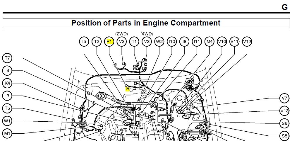

Edit: And, assuming your wiring is the same as the 2002 the White/Blue wire from that diagram should get 12v when in reverse on that plug in your picture. That should be P1, and you're looking for pin 2. I would plug that plug in and test with a meter first though.

Thank you! I sent a "visitor message". I'm not sure that's the same as a PM. Do we have to be friends first?
Excellent! There are actually two plugs in that area. One is under the foam padding that's not easy to see in the pic. I'll try to buzz it out.
Actually, after studying the diagrams, I believe that P1 connector is underneath the car attached to the side of the transmission. Those connectors under the center console are for unrelated features. I think your suggestion regarding 1D is the way to go. I think I need to tap somewhere between D1 and IE2 (behind the kick panel), which is where I tucked the back-up wire anyway.

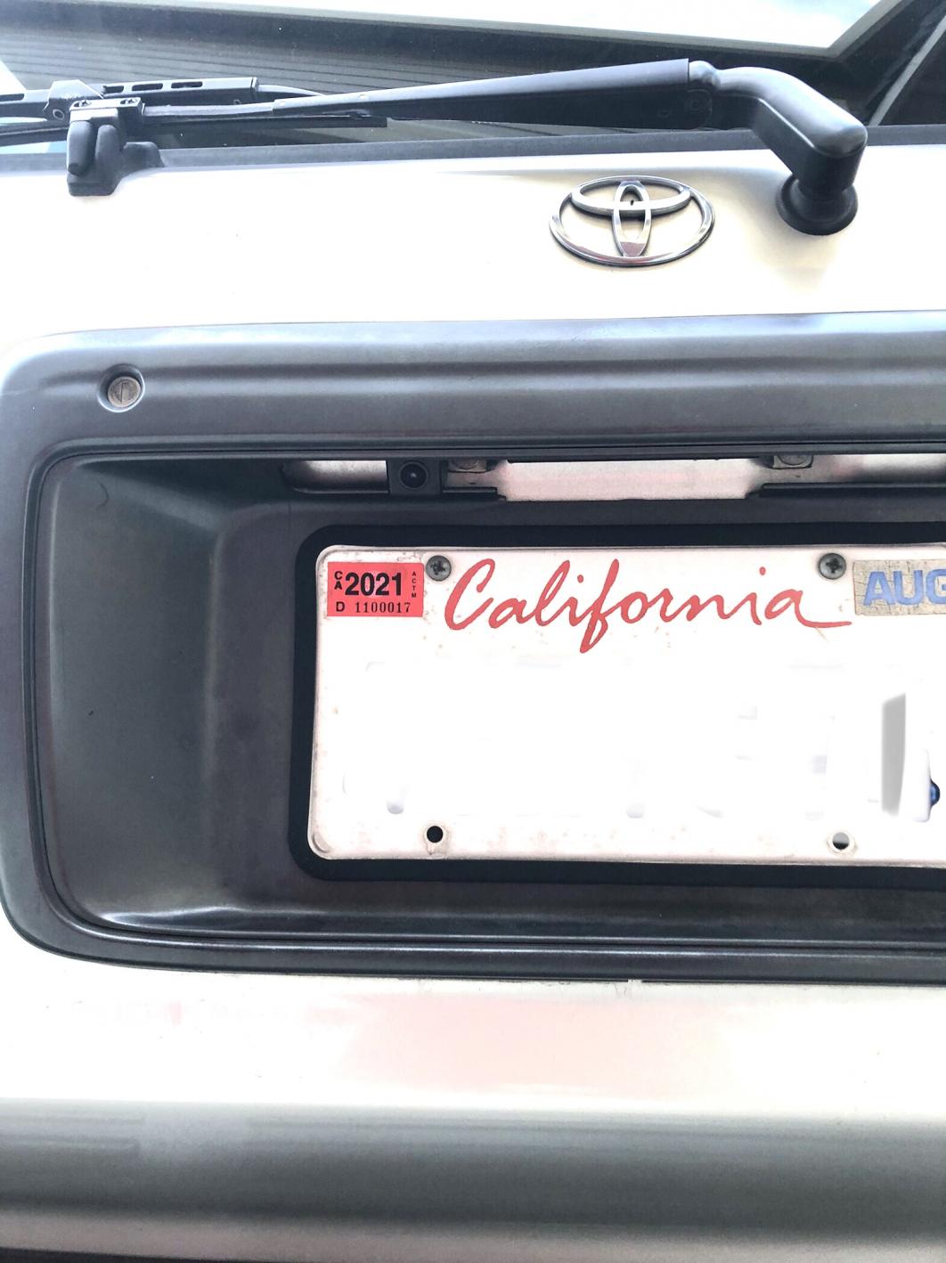

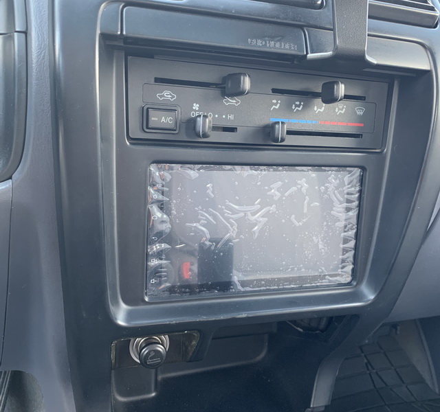

Hi all
My backup camera came from Aliexpress. I bought it really cheap, but it makes the work.
Connected to an Android radio (a very clean install - no cutting or damaging any plastic trim).
Up today (almost 1,5 years ater installing) everything still works like a charm.
Of course running the wires from the camera to the back of the radio was a real PITA, it just needs patience. I think I have lost an entire WE to do it properly (together with the CB radio - not shown on the picture) but it worthed.
Raphaël

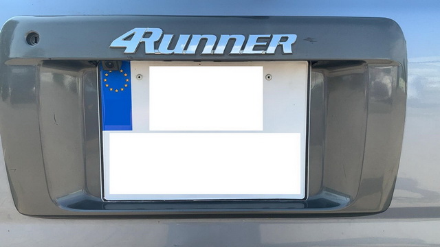

How about this,
4th gen 4Runner aftermarket backup camera. Replaces the left license light and has its own led. Only modification is you have to drill two new mounting holes so the camera can clear the bezel. It bolts up to the original license light holes. Quality is decent, but i suspect background noise and I'm trying to sort it out. Its connected to an Alpine ILX-650 and can be view at anytime by selecting the camera button. I tapped into the 12v accessory of the radio harness. Reverse trigger off the gauge cluster.
BRAUTO New Back Up CCD Rear View... Amazon.com: BRAUTO New Back Up CCD Rear View Reverse Parking Camera for Toyota 4Runner 2002-2010: Automotive

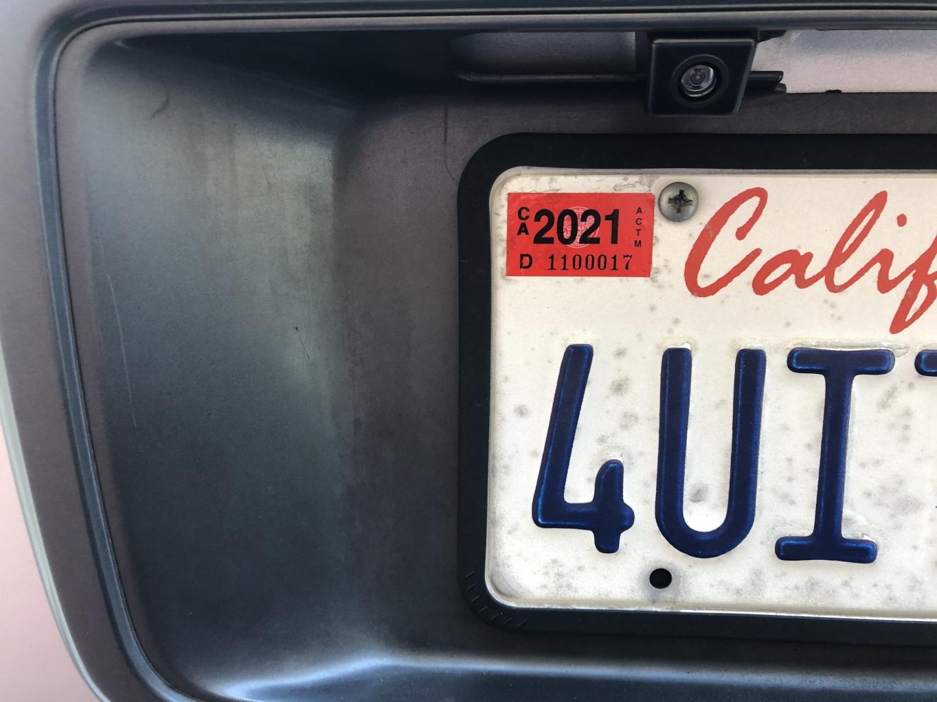

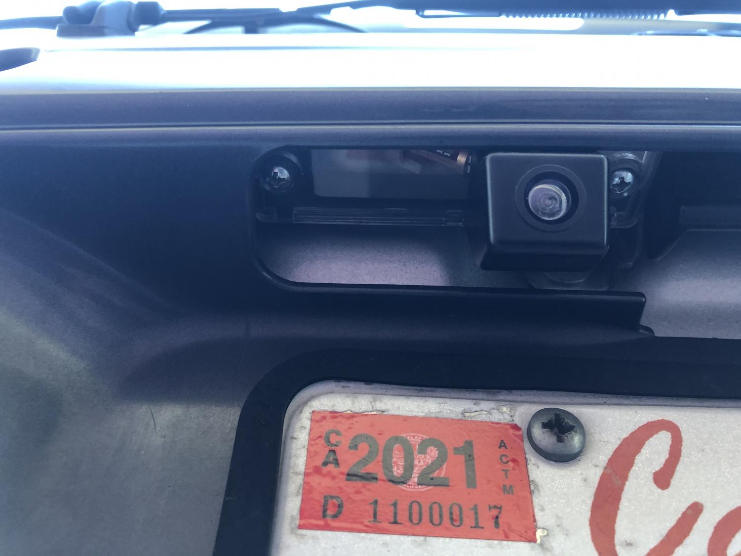

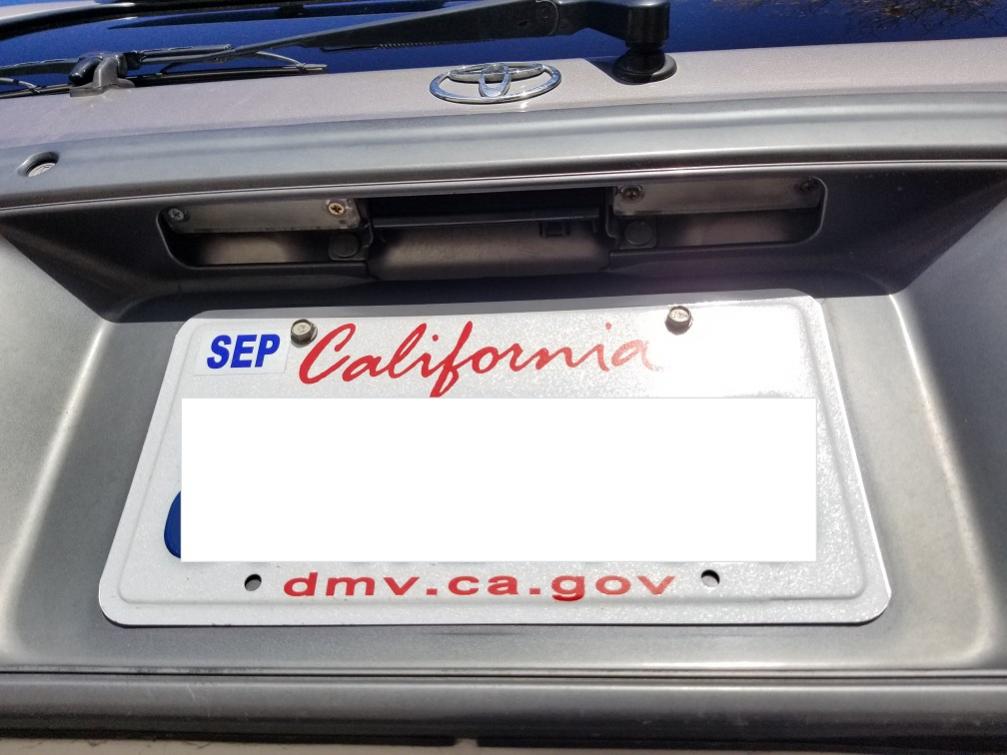

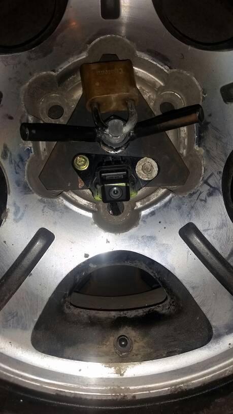

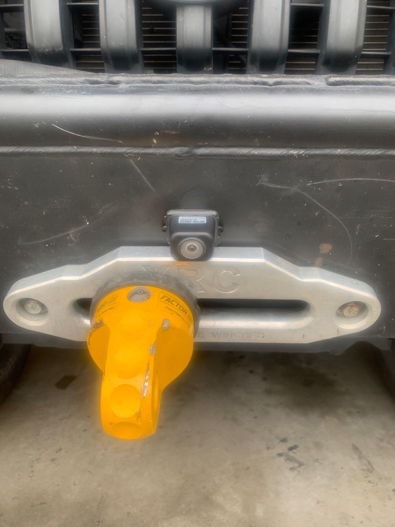

I put a rear camera from a Toyota Prius and a front camera from a LEXUS RX300
Changed out to this unit from AliExpress and it works great. Fits like oem, no modifications needed. Picture quality is very good.
That's pretty slick! I think I'm going to order one too.
Does the camera cast a shadow on your license plate at night?
It looks like it might block some of the light from your LED bulb.
I haven't check to be honest. Will take a look tomorrow and report back. Overall, I'm very happy with it. I even ordered a new right license plate lens to clean it up as my originals were dull and faded.
While it blocked some of the light, its not enough to hinder the light output. Still shines up the license plate just fine.
