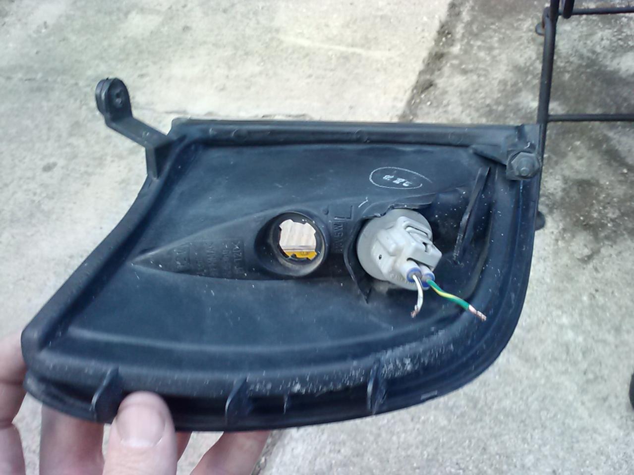

Alright. So after reading a bunch and getting pretty pissed at the truck and trying a couple different relays that I saw worked for others on here, heres what I decided to do. drilled a hole in the side marker and literally carved out slots for the OEM bulb to fit in with my pocket knife. They turn/lock into place, and the parking light bulb stays in tact and everything.

removed front bumper for the new savage offroadwinch bumper, but...its been a struggle trying to get the flasher to stop hyper flashing even with the Tridon EP-35 relay solution I saw on here, so I removed the stupid marker lights I intended to use, and wired the factory clips/bulbs back in to get rid of the wattage issue and just MADE it fit into the side markers beside the headlights.
