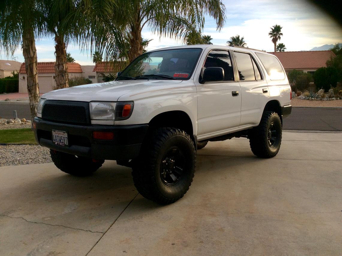

Tossed some new 33" shoes on a couple days ago and thought I was gonna take a big power loss ...but I was thankfully wrong. Lol
