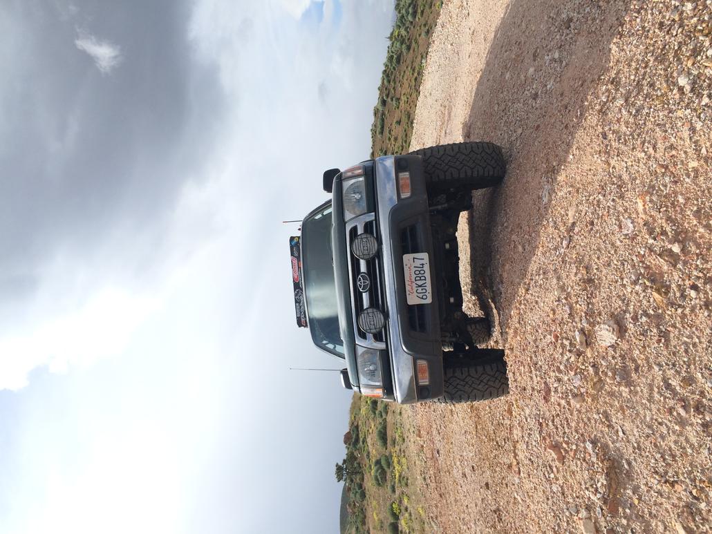

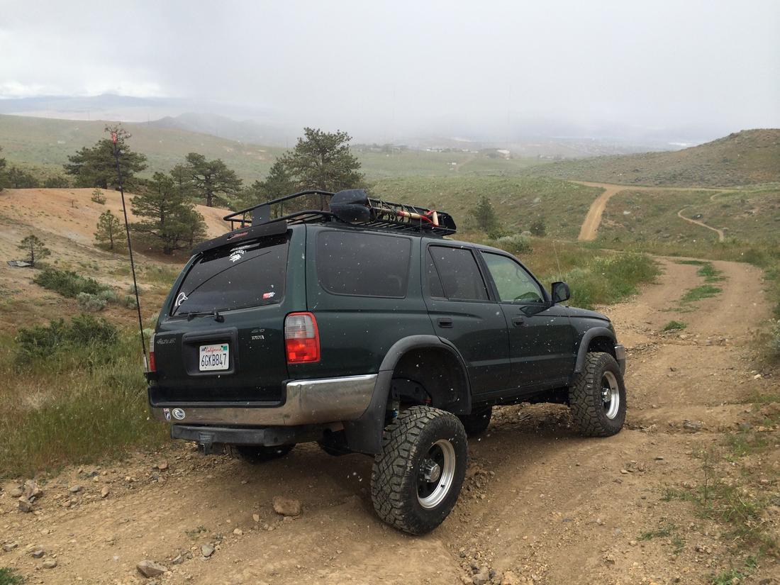

I bought my 1999 3rz 4x4 5 speed completely stock from the original owner in 2012 with 283K miles. It was well taken care of and the price was unbeatable.
Fast forward 5 years, I've added:
3 inch Bilstein/Eibach lift
265/75/16 Duratracs, 16x8 ion alloys
Cabela's Trail Gear Roof Basket
Flowmaster Super HP 2 muffler
LCE street header
K&N intake
Two sets of Hella 500s and one set of Hella 700s
CBI ditch light brackets
Insain Fab antenna mount
Cobra CB
Full interior LED bulbs
Pioneer head unit/kicker front and rear speakers
I'm currently at 335,000 miles and I've started to drastically lose compression
Cylinder #1 = 90psi
Cylinder #2 = 140psi
Cylinder #3 = 50psi
Cylinder #4 = 140psi
My valve rings are worn and I think it's time for a new engine. I found some imported Japan takeouts for a good deal, but I'm still have questions before going for it.
I have the two coil ignition set up on my current engine. If I purchased a used engine with the individual coil packs, could I just swap over my current set up?
Also, will I need to find an engine out of a 4x4 5speed manual? Or will any engine work?
I'd like to not have to mess with the wiring harness if possible.
Any input would be greatly appreciated.

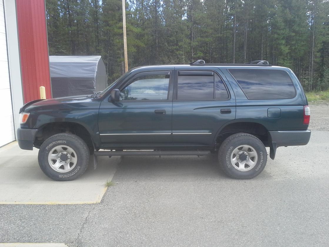

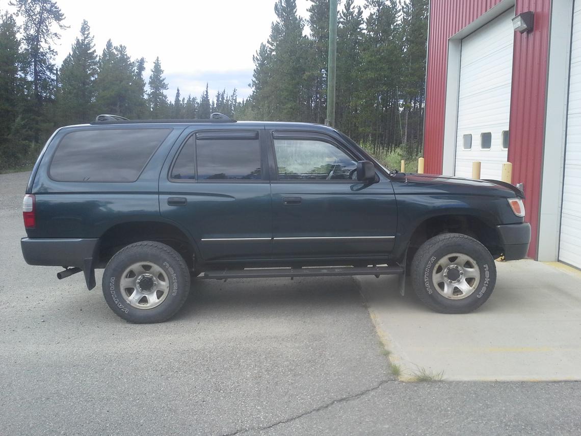

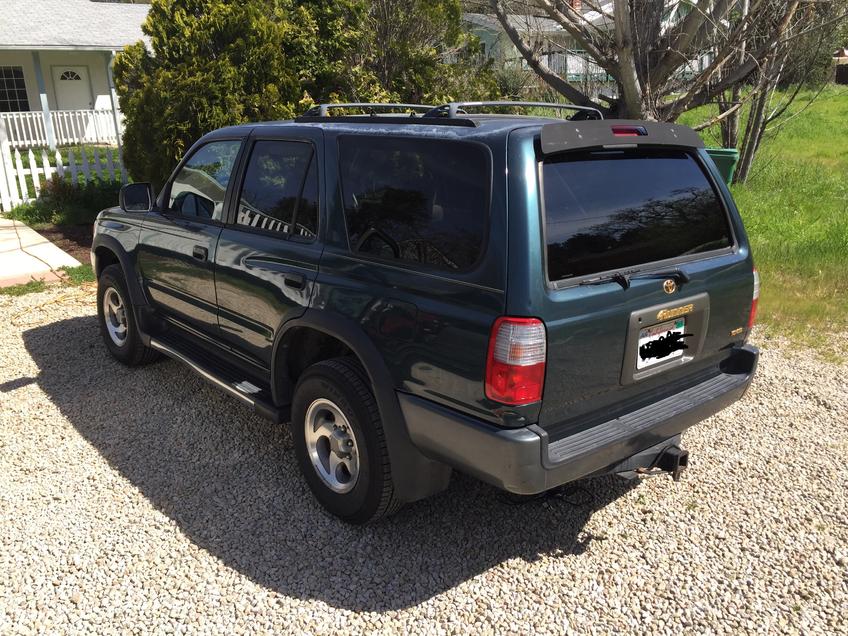

Nice truck indeed! I parted ways with my '87 Hilux @ 338,000 miles. Sold my 1996 3RZ Runner last year with 269,000. I ran it with Alumaseal for 50,000 miles with a small headgasket leak into cyl. 3. Sold it with full disclosure of all issues(headgasket, clutch, rear brakes, etc.)
Bought this one from the original owner for $2400 @ 236,000 miles last month with new tires, battery, windshield, and tuneup. I installed a Denso Radiator and just changed the oil and ATF. This is my daily commuter/kid hauler:

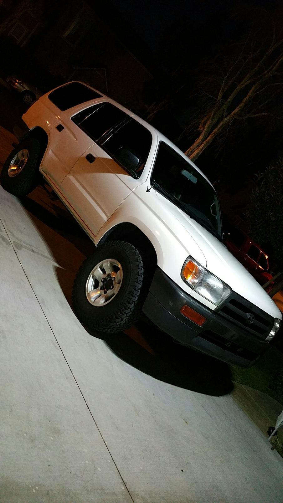

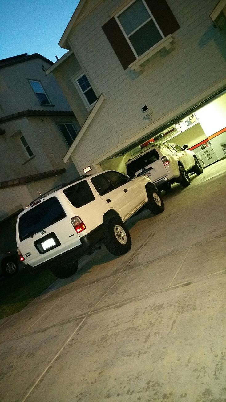

Hey Guys! New 3rd gen owner here! 1997 3rz 4x4 5speed. Main usage is for mild offroad trails and street. It's stock right now, just on bilsteins 4600s. Any recommendations on a 2-3" lift kit and tire setup? I know there are several. Not planning to regear on anything at the moment so I'm still deciding which tire size to use with a 2-3" lift. Thanks!

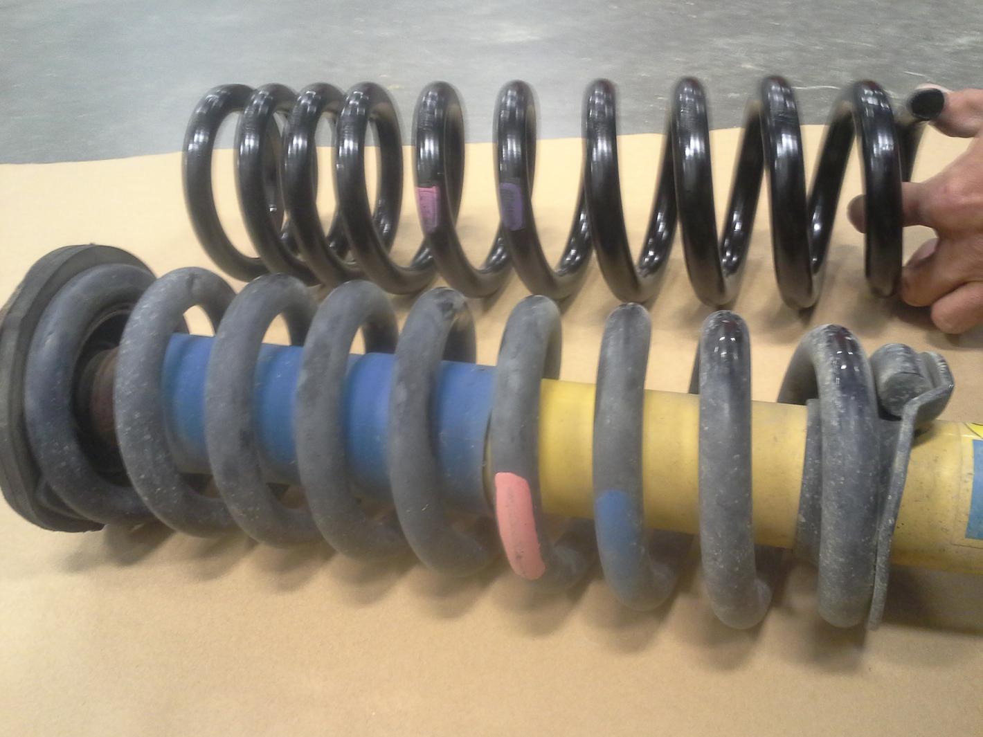

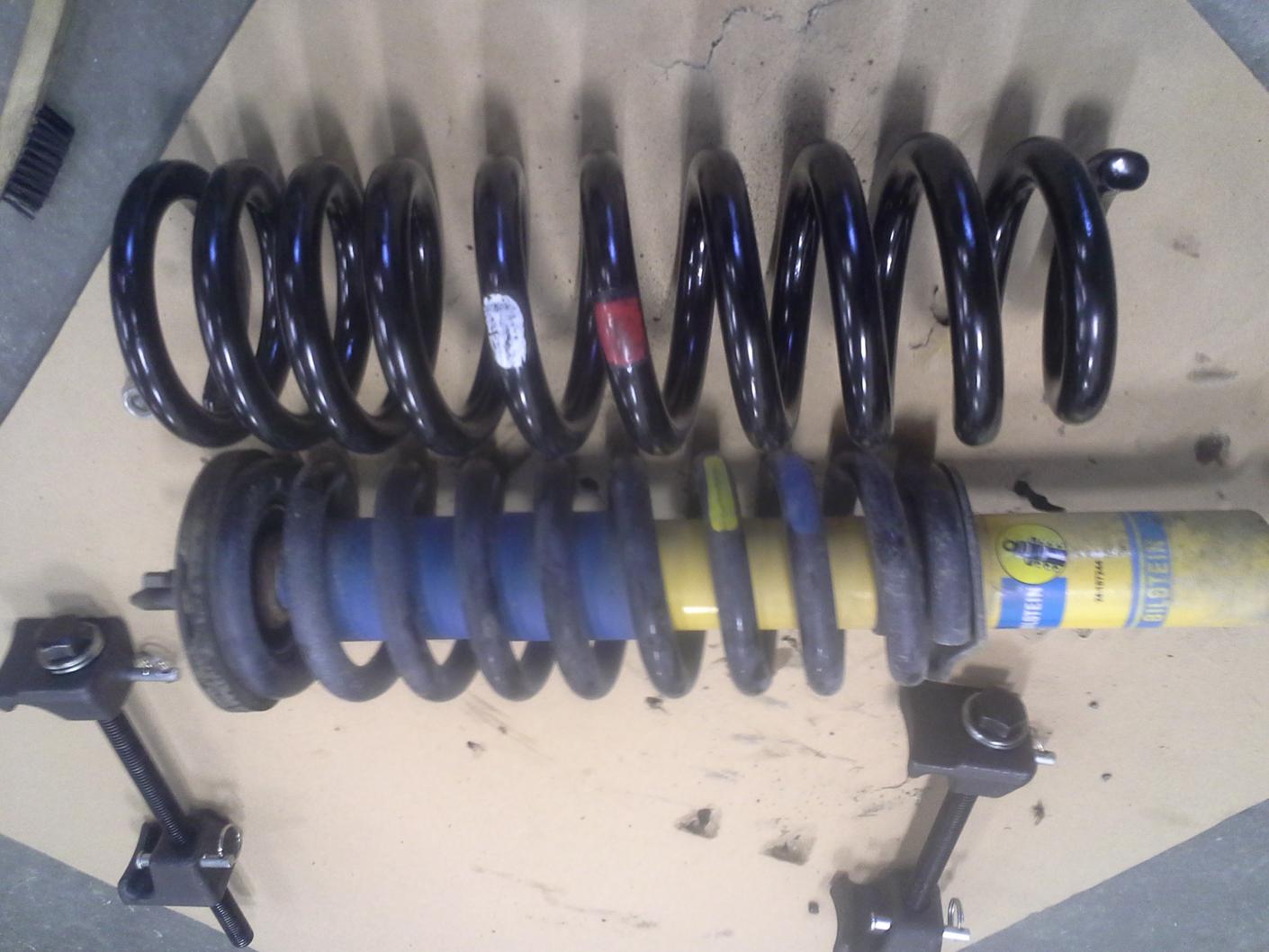

I think this is of more interest to the 3rz group than the V6 guys. This is the biggest post I have ever made, hope it is of use to someone. Thought I would share the results of my suspension experimentation.
I have a 96 3rz base model. 5spd, no A/C, no cruise, no power locks or windows on 15 inch steelies with load range c tires. Likely the lightest 3rd gen available.
1- 3 years ago I went with used 99 Tall fronts, used 99 Tall rears with cone bumpstops and new Bilstien 4600s all around. This resulted in a woefully saggy rear end. Ugly. The 99 Tall fronts gave me fully 2.5" of lift from old original. Too much IMHO.
2- So the used 99 Talls in the rear were swapped for a new set of OME2906s (and cone bumpstops). This resulted in a level 4runner when empty but still a little rear sag when loaded for camping, say an inch lower in the rear. After about 50,000 km it was sitting at 35.5 inches on all corners, or 22.5" hub center to fender when empty. I was OK with the look but the front end ride was horrible. Far too stiff, very jarring in the front. Dash shakingly painful. It got better with time but only slightly.
3- At [MENTION=85046]nissanh[/MENTION]'s suggestion I found a set of used Tacoma Progressive Offroad package fronts out of a 2004 Tacoma with the extended cab. Free height of these are about 1/4 inch shorter than the 99 Talls (all springs junkyard used). Once installed and a couple hundred KMs on them the results are spectacular. They ride much better.
Now my 4runner unloaded sits at 34.5" in the front and 35.5" in the rear. The improvement in the front is very noticeable and I don't mind a bit of rake. Today for an experiment, I loaded the 4runner with 250 to 275 pounds of weight in the rear to simulate a very full load of traveling gear. I ran a few miles on some rough roads then set up for measurements. Happy surprise! Dead level at 34.5" on all corners, or about 21.5" hub centers to fender. I'm very happy with these results.
In summary, I feel the 99 Tall fronts might be a little too stiff for someone not planning to add weight to their 3rz. The Tacoma Offroads are better suited for my use.
The pics below are loaded with 250+ pounds right over the rear axle. I know the tires are small but I love the fuel economy.

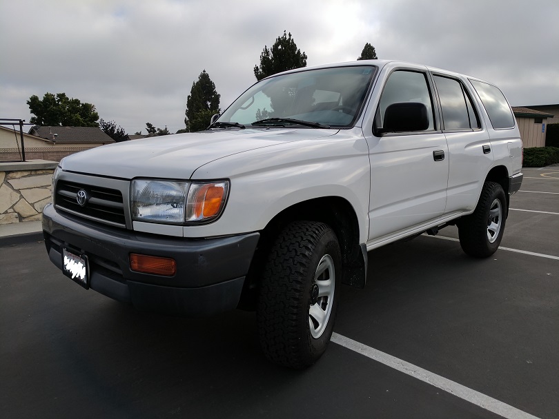

posted up in the New Members area but given we have a dedicated 3RZ thread gotta add to it too!
got my new to me 98' Base 2wd stick a few weeks back and loving it! a little background, my first 3 cars were all Toyota pickups/Tacoma's, the last of which was a 98' 4cyl 5spd 4x4 SR5 (first new car), white with blue/gray interior that i sold in 08' and have been regretting it ever since. fast forward to a few weeks ago and low and behold, my new to me Runner is white with moon mist, 3RZ stick! the Runner is too much fun to drive, every time i get in it i get taken back 20 years.
anyway, enough about me, more about the Runner. bought from 2nd owner (family friend of the original owner) who had it for a year before me and the whole time it sat, i think they put maybe 200 miles on it. 78k original miles, besides some usual wear and tear its it great shape. immediately did all fluids the weekend i brought it home. already had recent tires/brakes/plugs & wires, plus the area around the head is clean so looks like maybe a new gasket at some point.
i have a buddy who owns a shop specializing in Honda's, but had him take a look anyway plus he referred me to a Toyota guy who gave me a look over as well... both commented the truck is in great shape and doesn't look to need anything major, though i do have a couple small things to monitor:
- a little sweat coming from the 3rd member, oil pan, and passenger rear shock, but i hesitate to even call it sweat. no drips at home, and i've been monitoring since i bought at no problems
- also have a bearing whine in the tranny somewhere (spit some metal when the fluid was changed) that goes away when the clutch is disengaged, but shifts great and smooth so not too worried, especially considering i just changed the fluid
no plans to mod really given that its 2wd, did find an OEM rack on eBay that i'll put on in the next few weeks and sometime in the next 6-12 months i'll replace the LBJs as a preventative measure, also shocks and springs along with any other suspension parts that may need it, and when the tires go probably put on some 31x10.5s just to fill it out.
anyway, here's a pic of my new love (don't tell the wife), looking forward to many many happy years ahead and getting back up to speed on my Runner, after all been 10 years since my last 3RZ!
That's interesting, my 99 3rz came with talls from the factory & never felt stiff. My only complaint was that the rear sagged when loaded with camping gear in the back even when new.
There is always the possibility that the combination of the 99 talls and the 4600s are to blame. The 4600s and the Tacoma springs is a combination I like more. I will keep the 99 talls for future use when and if the bilstiens get replaced.
Do you recall what your front measurements were when stock? Like I mentioned I was at 22.5" hub center to fender.
I don't remember, I wrote down my pre-lift dims but lost the paper before I could add them to this site.
