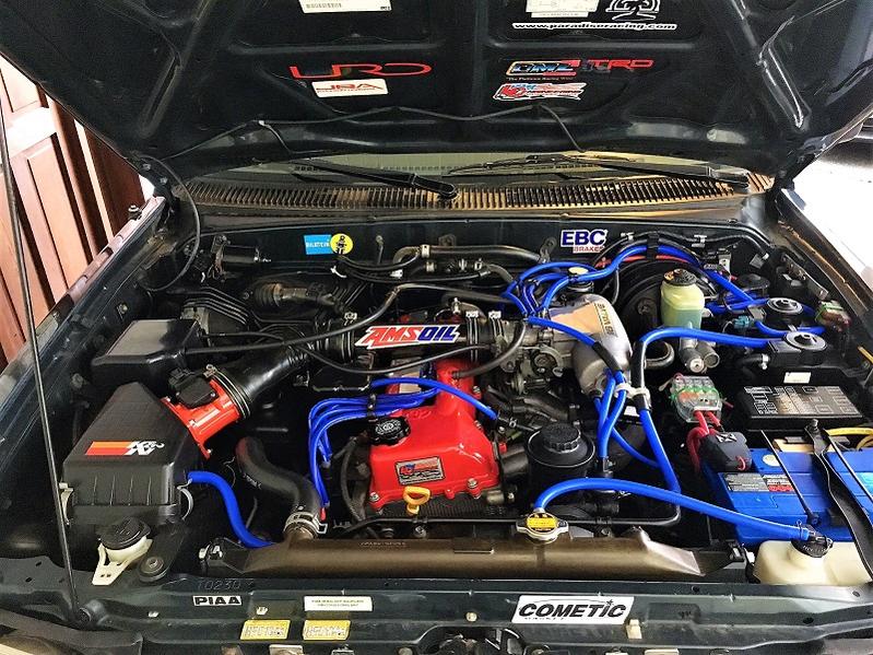

Adjusted valves and got some goodies installed

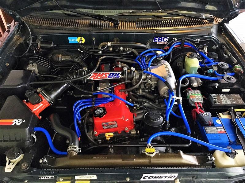

Can you help me find the Toyota part numbers for the two breather / ventilation hoses that go into the valve cover? The rear one hits the PCV and the front hits the metal tube. I ordered 12261-75080 and 12262-75050 and they were not the right shape and length. My truck is a 99 non-CA emissions, pic of the actual engine bay, hoses of interest have red arrows:

Dear 3RZ bruthren:
IMG_1073_zpszytg4xah.jpg~original
I would look at camelback toyota. They have pretty good diagrams. Wish I had time to help more.

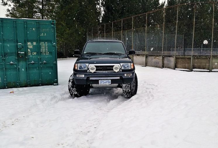

and yes its VERY clean for 200k 20 years old
DSC_0423_zpskjrk4kjk.jpg~original
I've got an FJ lift in the works but the rotors and pads need replacing asap. That is first naturally.
The wheels will get painted soon as well

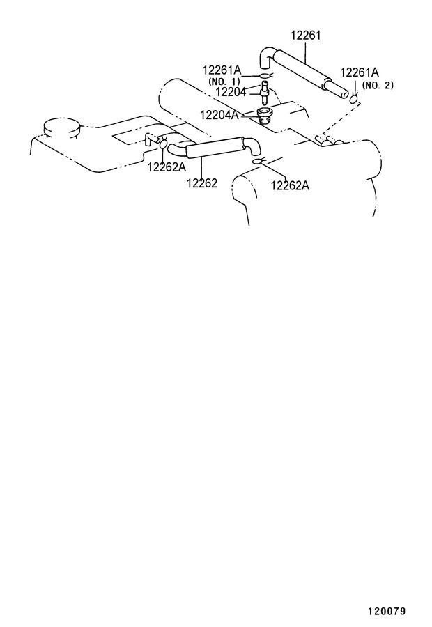

i ordered my hoses from Toyota parts Direct since i am in Canada and used this diagram and they fit perfect. Let me know if it still doesn't help ya.
Yes I started with the diagram too but the part #s didn't work. Can you post up the part #s that you used? Thanks
hmm.. i printed that diagram and went down to the dealer and they pulled up the parts for me easily and matched TPD's prices.. i wish i still had the bags they came in, sadly i got rid of them a while ago.
