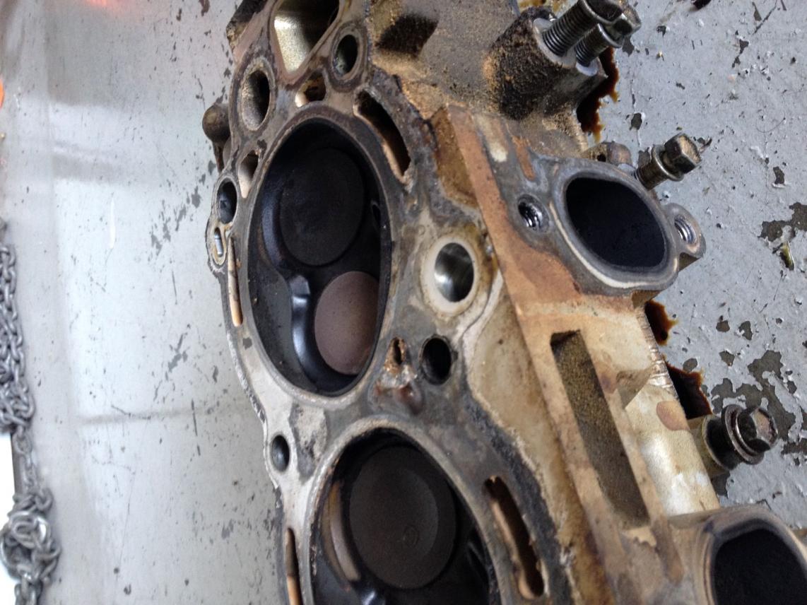

When I rebuilt my 3.0 the heads required welding as they corroded to the point where the head gasket could not seal properly. Did you inspect the plugs when you removed for the leak down test? Any deposits?
You could see the corrosion, it looks much worse once cleaned.
