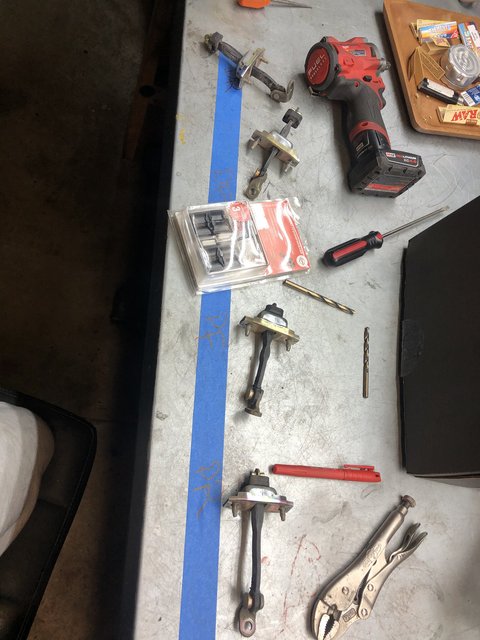

Almost forgot, also did the door stopper mod.
It’s pretty satisfying but you gotta get used to the door being a bit stiffer to open.
It looks like you did all 4 doors. Did you notice a significant difference on any of them other than the drivers door?
Yep did all 4, definitely noticed a huge difference in all the doors. I should have takin pictures of the old vs new parts. Mine were all pretty worn down, drivers door was the worst though.

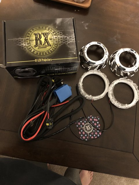

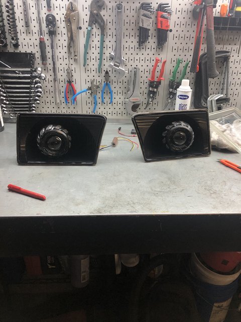

Lots of updates coming soon. Just installed bxbuilt 2.0 led retrofits, gunna be so nice driving at night now.. Instructions were pretty worthless but they turned out good.

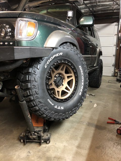

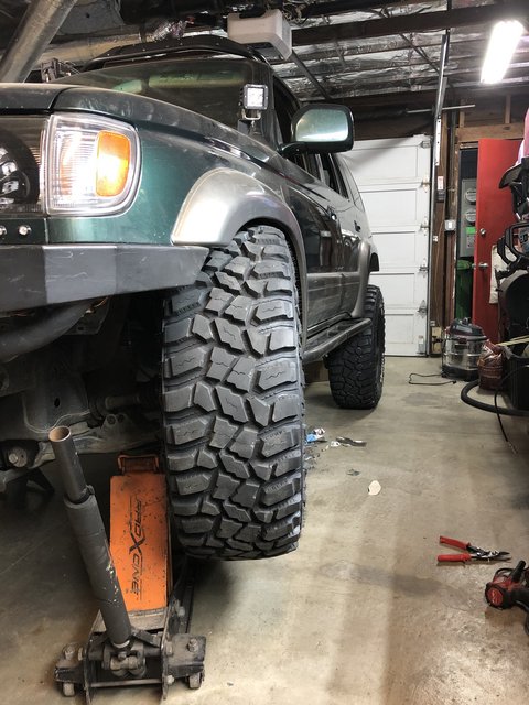

-installed method 312’s on 315/75/17 cooper stt pros and started cutting the firewall

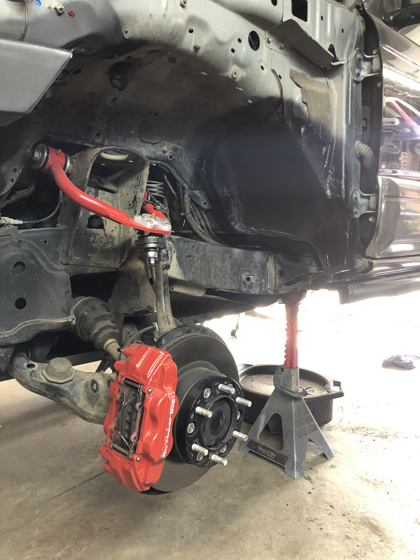

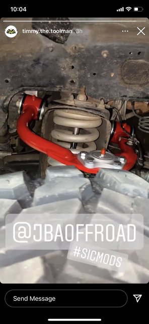

-installed JBA UCA’s

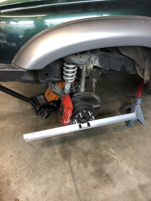

-did a DIY alignment (move LCA cam tabs so I gain maximum positive caster and then adjusted the toe within 1/64” with the steering wheel straight)

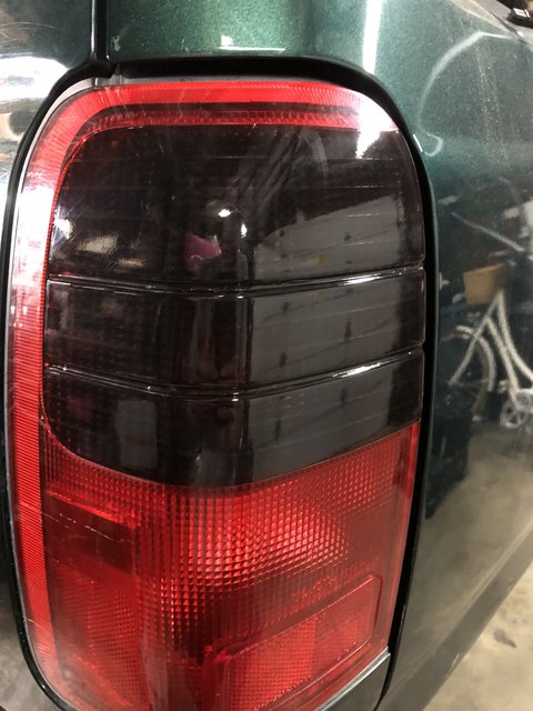

-tinted the clear part of my tail lights (unsure about it, might remove the film..)

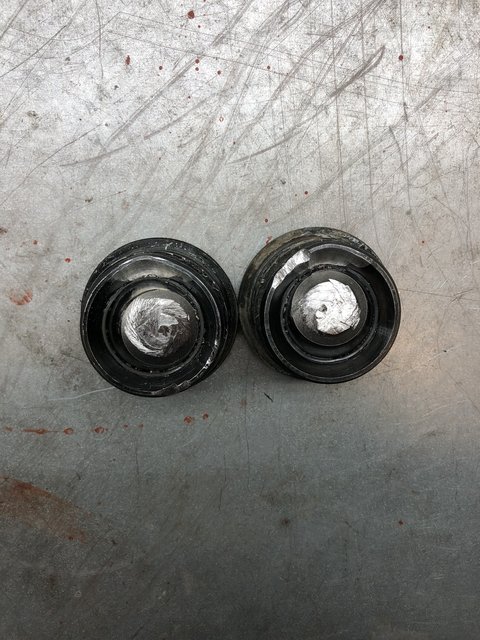

PSA if your lifted and not running a sway bar up front your limiting factor is probably your upper ball joints.. these were brand new oem with less than 2k miles, hard to see from the picture but they are pretty ovaled out.
If you have longer coilovers than stock or have top plate spacers, for sure. I did the measuring for myself when I did my front suspension and made sure the shocks limited travel before the ball joints (stock upper arms on my 4R right now). You may also want to make sure your bump stops are the limit of the up travel too instead of the shocks (though, based on your bump stops, that is unlikely).
-Charlie
I have the toytec bilstien kit. Is there a way to get the fully compressed measurement without removing the spring? If not I’m not going to bother but it would be good info to have..
You might be able to do something with the coilover removed, but it would be difficult to measure. I did it with the springs off of my 5100's - which is a bit easier to do than with most adjustable coilovers.

Those Coopers look beefy! Hope you like them as much as I've liked mine
So far so good, haven’t really driven on them much yet though lol..
-Charlie
I’m not too worried, I don’t feel like removing the springs.

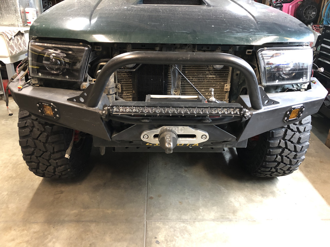

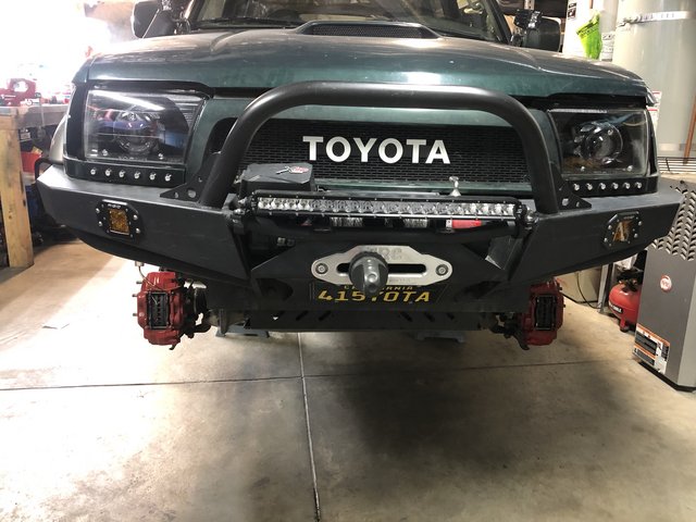

Moved my winch control box into the passenger side wing of the bumper. Pretty happy with how it came out.

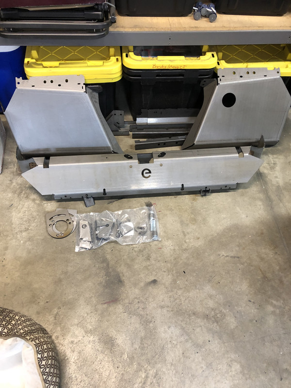

Eimkeith rear bumper, coil bucket reinforcement, lca reinforcement, and still waiting for the tank relocation brackets.

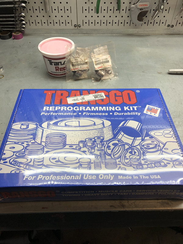

Transgo kit and shift solenoids which will hopefully fix my slowish shift between 1-2 when doing a rolling stop. Still waiting for new valve body gaskets from part souq.

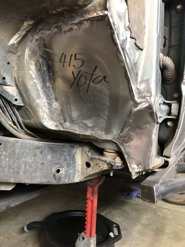

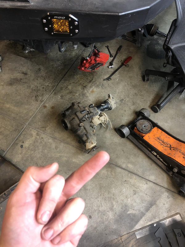

Finally finished cutting and patching for the 35’s on both sides. Pretty happy with how it turned out, just trying to get the wiring all hooked back up and get the fenders back on. Freel good performance on IG had some really good pictures of the firewall tubbing which helped me a lot. Pulled my rear 3rd and sent it to ECGS for 5.29’s, front is next. While pulling the 3rd I also pulled the drums and looks like my rear axle seals are leaking, the brake shoes are soaked in gear oil..
After much cursing and struggling I finally got this thing out.. Rear diff should be here on Thursday, hopefully be sending this one out by the end of this week.
