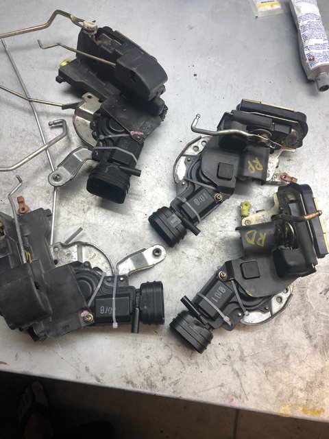

Had these door lock motors sitting around for a while and decided to tackle that today. Just finished putting the new motors in, sealed them up with some black Toyota fipg and zip ties.

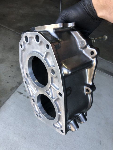

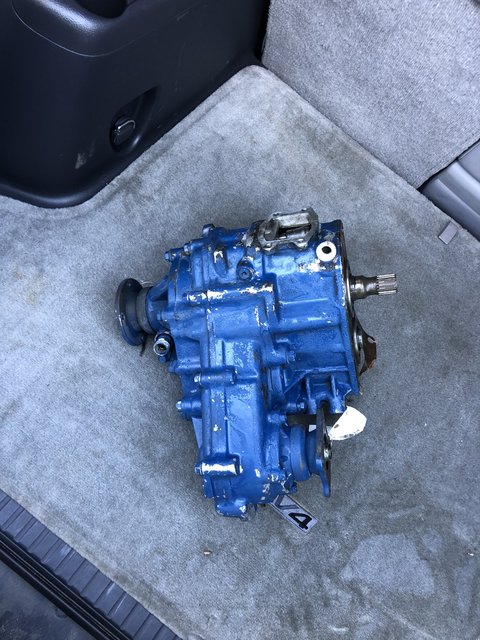

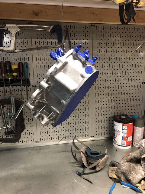

Cleaned and painted the transfercase housing, Marlin crawler said my order should ship out mid January.

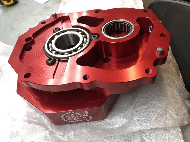

Well I wasn’t expecting to receive this today, didn’t even get a shipping notification from Marlin.. package 1 of 2.
You. Are. Going. To. Have. So. Much. FUN!
Putting it together and can't wait to see how the shifters go. :nod:

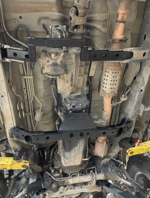

There’s only like 4-5” between the gas tank and the big actuator (guessing for the AWD?) on the back of the transfercase. Will definitely be nice having the tank gone from that spot. Thinking I’ll just weld a piece of 3/16 from the transmission crossmember for the extra mount for now. Eimkeith is supposed to be coming out with a crossmember kit that I’m interested to see. I’ll probably just go to a local drive shaft shop.

Pretty much that’s all it will take, gotta cut the crossmember behind the tcase a bit too. Supposedly eimkeith is working on a crossmember kit, and also a 4 link kit. Definitely want to keep the AWD. Also win win cause now i don’t need that expensive gas tank skid lol.
Here’s a pic for reference, might do it like this temporarily until he comes out with that kit.

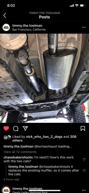

Installed a borla muffler today, was a little more difficult than I anticipated but in the end I’m pretty happy with how it turned out.
Is this the Borla ProXS Muffler? I used the 40665...
I like this mod quite a bit actually, the sound included, more like a truck.
You should have increased flow and clearance with a decrease in weight (12 lbs).
I got the 40664 thinking our pipes were 2.25” doh (the Amazon reviews even have a guy with a 3rd gen t4r saying it was the right one lol).. It would’ve been way easier with the 40665 2.5” one.. Didn’t want to bother with returning it and what not so I went with it. Yea tons of benefits for not a huge price.
I hear ya. I seem to recall doing the same, but can't remember what vehicle...
I remember that the 1st gen Tacoma engine specs, and you might know this, were rated higher than these 3rd gen 4Runners. Some have postulated it was due to our more restrictive muffler. If so, you might have liberated a little extra power...
