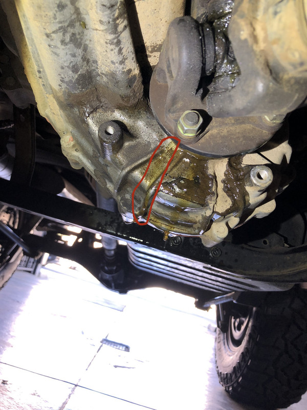

Hahaha....takes a bit of finesse and a half for that and hardly any swear words. Ish. Good work and good time for the oil pan re-fipg if you need it.
Definitely took a lot of finesse haha. I don’t remember it being that difficult on my Tacoma when I did the regear but I also had a 3rz so it might of been a bit easier. I’ll take a good look at my oil pan to check if it needs it.

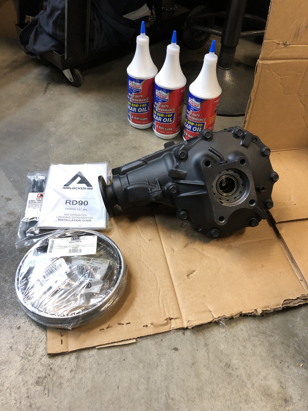

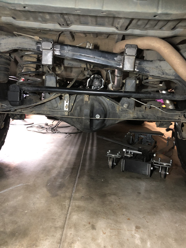

Got the new rear 3rd installed with 5.29’s and new Allen drain/fill plugs as my old drain plug was difficult to remove because of rocks scrapping right there. Also did my rear axle seals/bearings and brake shoes at the same time with oem parts.

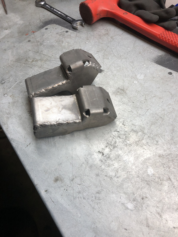

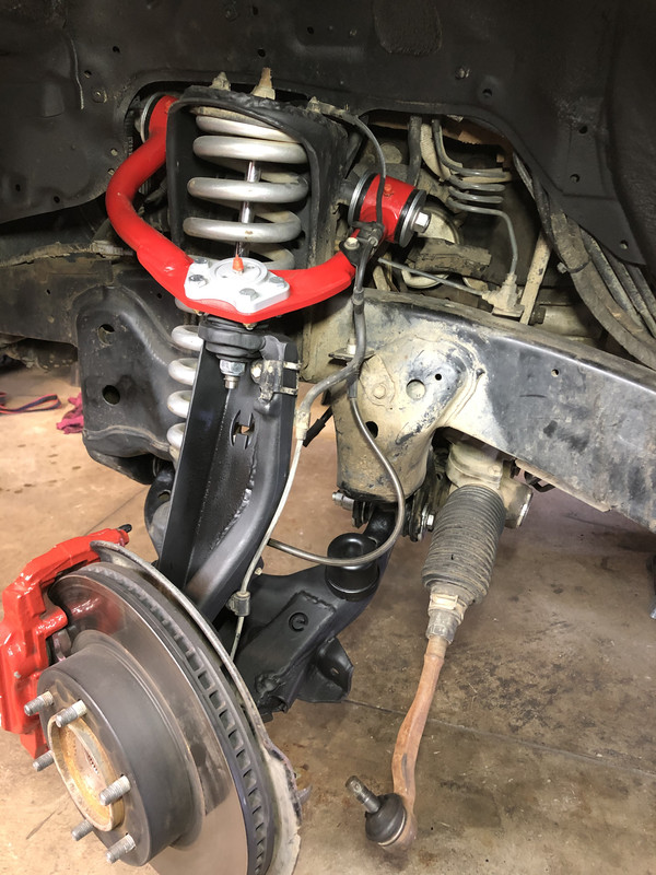

Got my front suspension all back together minus the front diff, still waiting on ECGS. Installed eimkeith shock bucket reinforcements, LCA reinforcements, and heavy friction works spindle reinforcements. Also got new front durobumps warrantied as they were both cracked.

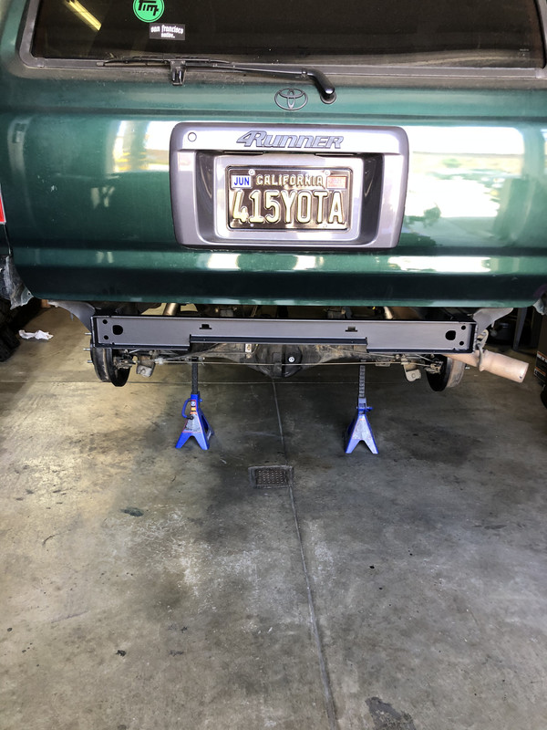

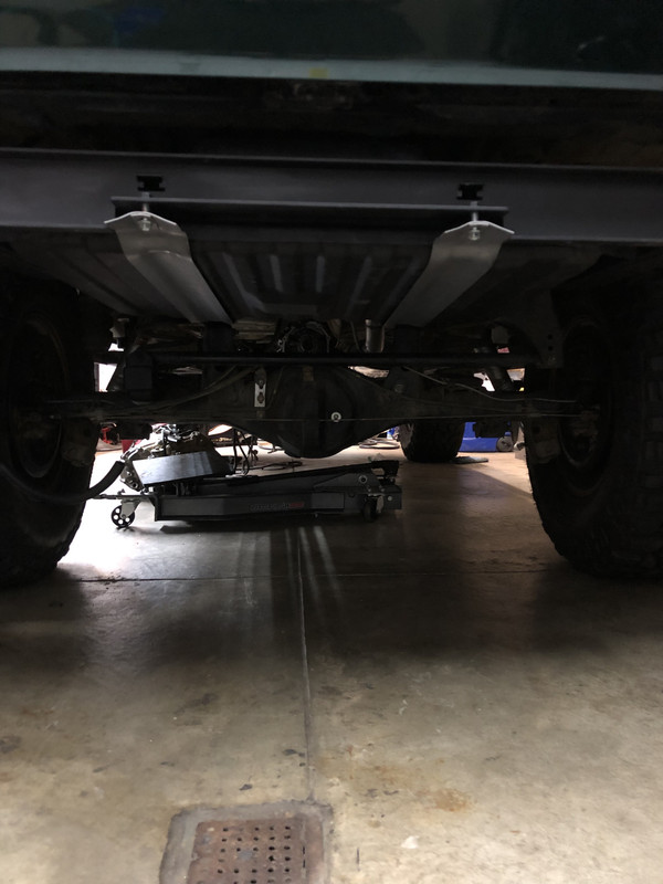

Last but not least I got the rear eimkeith crossmember installed for the rear bumper/f150 tank swap.

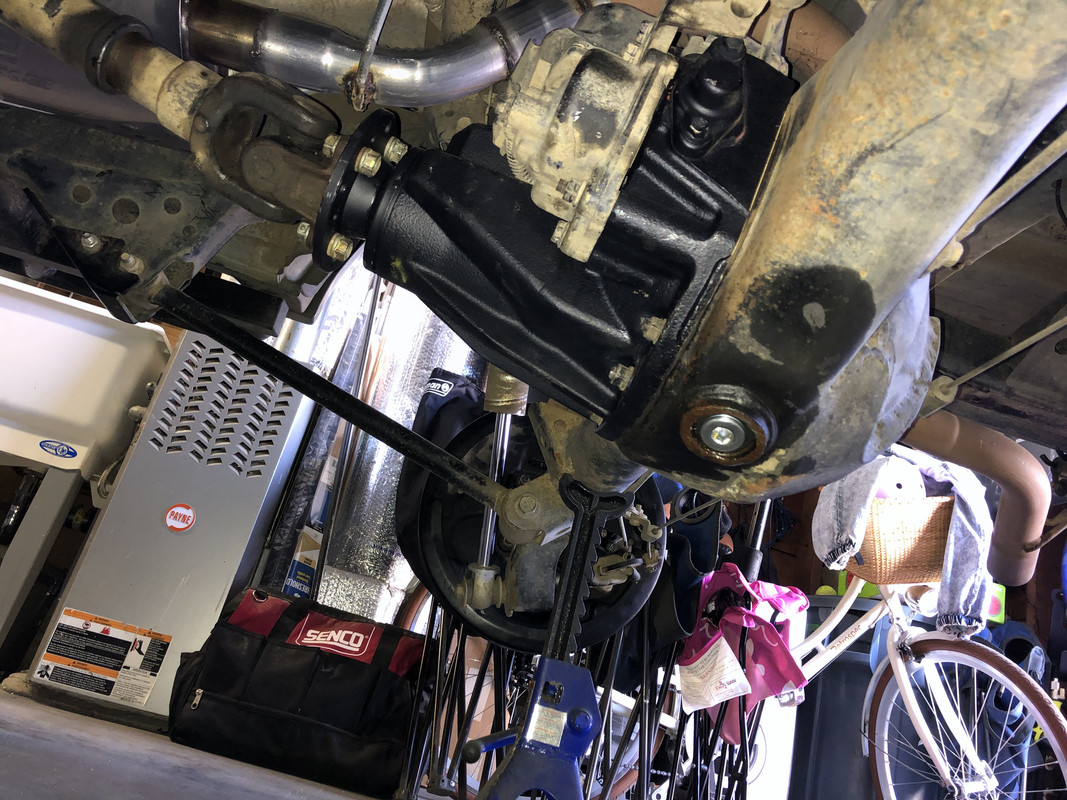

Gunna be a busy weekend, just got the front diff back from east coast gear supply. Sounds like the compressor is back ordered a few more weeks though..

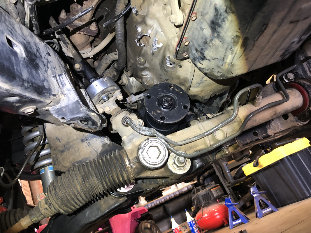

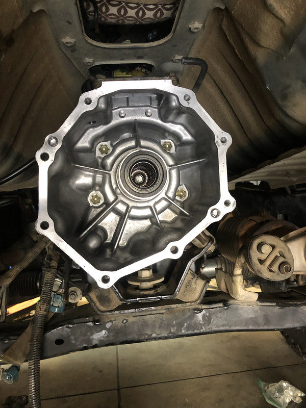

Sooo something happened.. I accidentally forgot I had the front drive shaft zip tied only and went for a test drive and shifted into AWD… Was pretty heart breaking after putting in so much work. Check out the carnage.
Front section of tcase housing cracked, transmission bell housing Swiss cheesed, power steering lines chewed up. Good thing I don’t need the sway bar mounts anymore, even made a small dent in the frame.

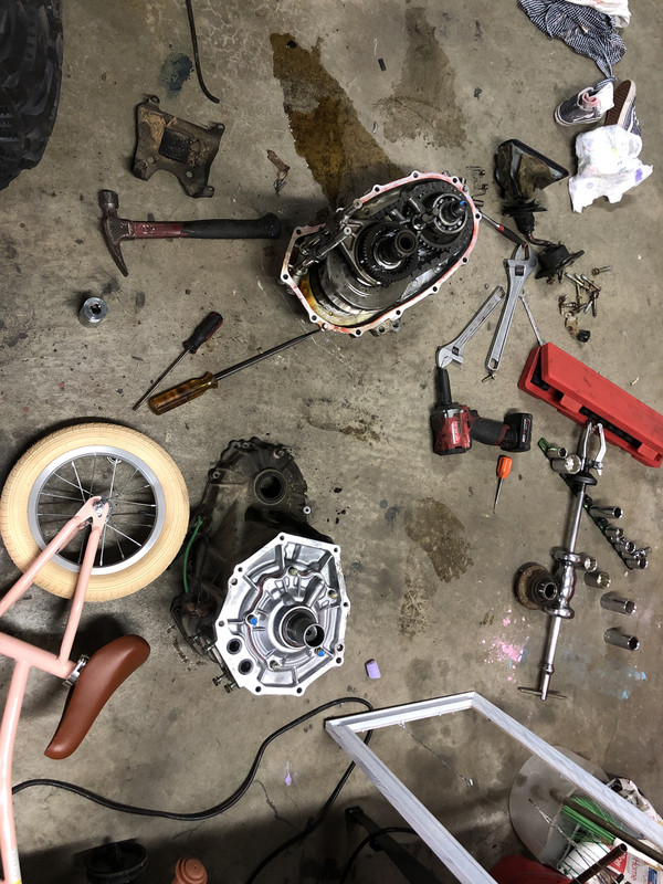

Went to the salvage yard and picked up a 99 limited transfercase. Was super crusty/rusty so I decided to just use the front section of the case only. Took it all apart and resealed the housing back up with all my original tcase guts.

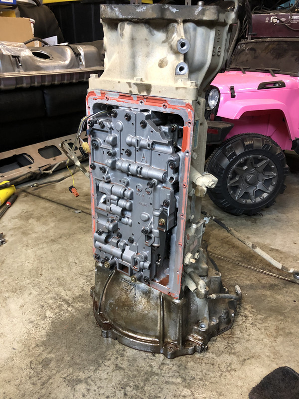

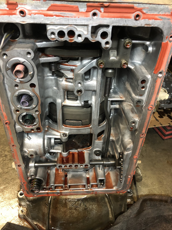

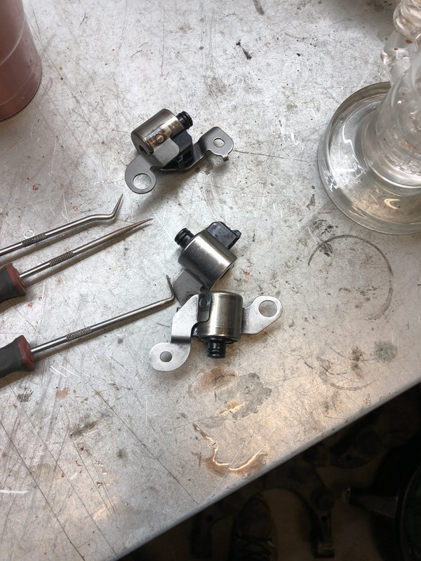

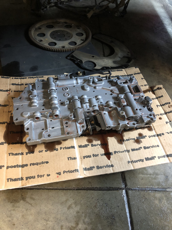

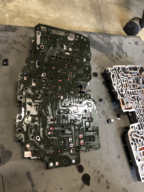

Took transmission out to replace bellhousing, decided to start the transgo/solenoid replacement. Realized I got the incorrect solenoids. If you want to do the solenoids I highly recommend dropping the pan before ordering as the ones I got were recommended by mcgeorge (didn’t order them from there though).. Was pretty hard finding the correct part numbers, had to look at the pictures on partsouq to figure it out..
Here’s what the solenoids look like

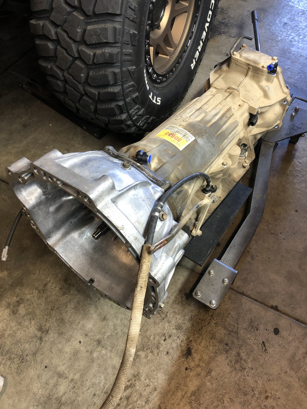

Trans go/shift solenoids installed and transmission is back under the truck. Also was able to use 5/8 quick connect fittings directly on both the breathers which I was really happy with.

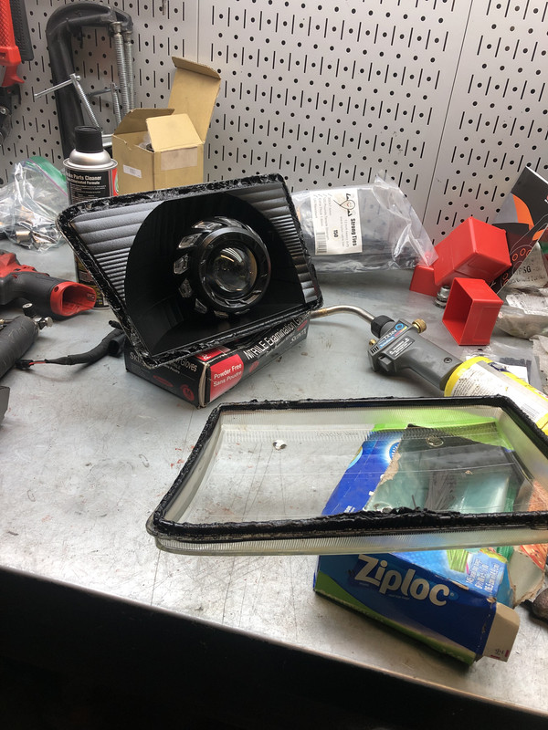

Opened up my headlights again, when I originally did the retrofits I didn’t clean the dust good enough and I also messed up the paint when I put them in the oven to reseal them. Repainted, cleaned the dust really good, resealed.. Never doing that again lol..

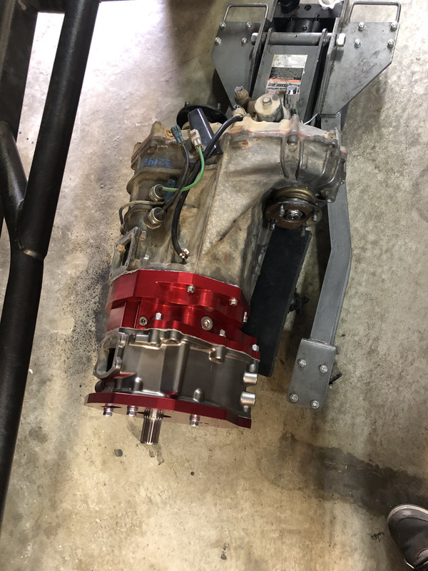

Got the Marlin crawler tcase fully assembled. Now just gotta get the fuel tank dropped and cut out the crossmember and I’ll be able to get that installed.

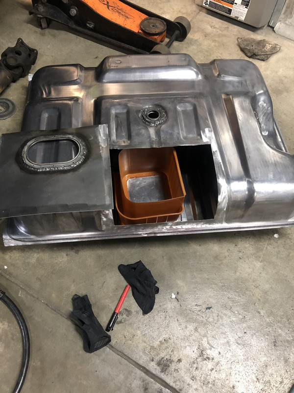

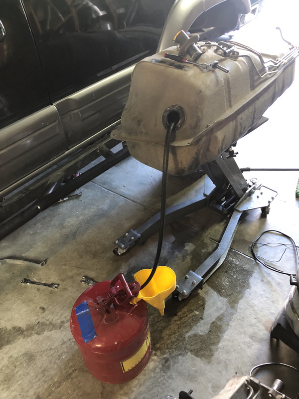

After about 6 months of planning and part collecting I’m finally doing it.. Gas tank is removed, disassembled, and drained. Learned some pretty cool siphoning methods on YouTube. Had like 13 gallons in the tank still, what a PITA. Luckily my wife was low on gas so I filled her car up a bit. Tomorrow Ill start cutting the tank up to harvest the flanges, then cut the f150 tank and weld the flanges on. Gunna have to look at [MENTION=118207]midcoma[/MENTION]s guide a couple more times..
Got pretty lit off the gas fumes in the garage (door was open) lol, definitely do it outside next time.

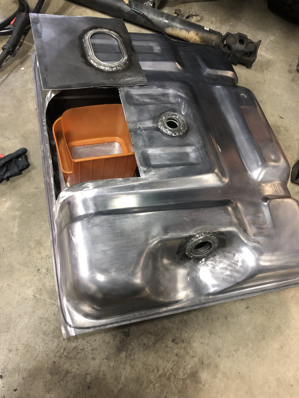

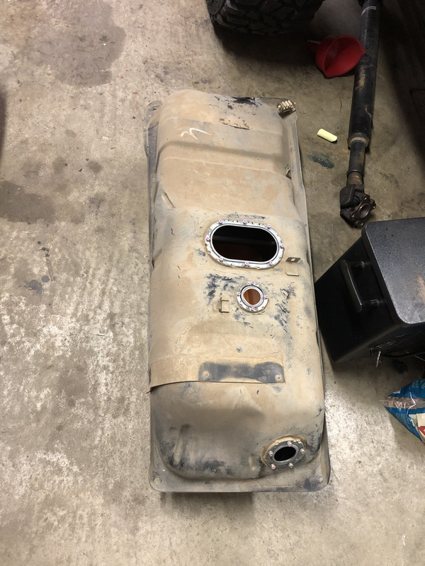

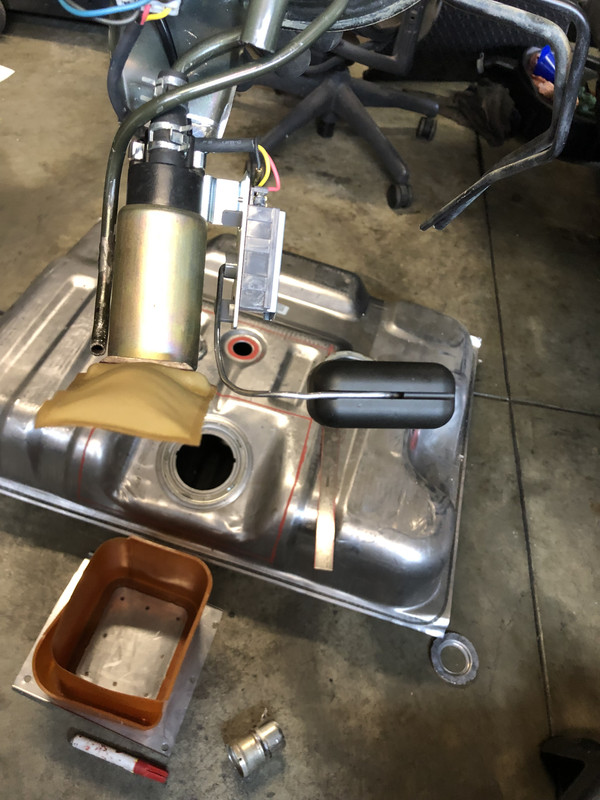

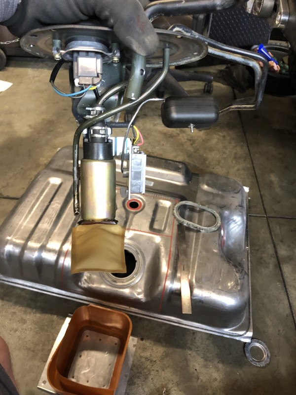

Cut off the Oem flanges and bucket, removed the filler nipple from the f150 tank, and modified the fuel pump bracket and the sending unit. Fits perfect inside the bucket now I just have to get the flange and the bucket in the perfect spot so the float doesn’t get stuck. Pretty happy with how it’s coming along so far. Removed approximately 4.375” as per [MENTION=118207]midcoma[/MENTION]’s thread and it seems right on when I put the assembly up to the f150 tank.
Empty:
Full:

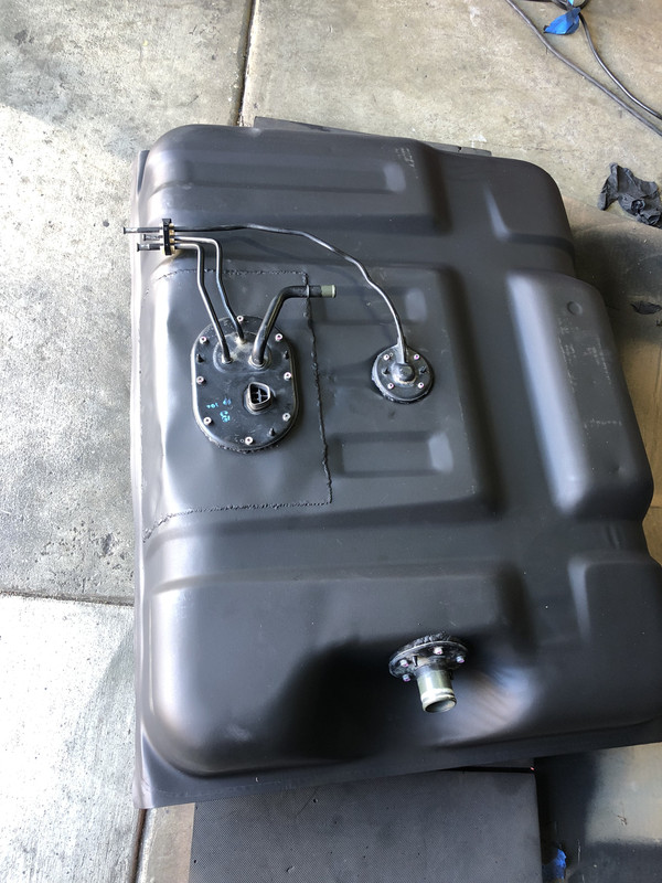

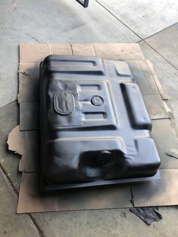

Got the flanges all welded up, cleaned the tank really well inside and out, and got the bucket placed where it needs to go. I’m going to angle the bucket very slightly to give the sending unit just a bit more room. The pump is literally perfectly touching the bottom of the bucket as well so the 4.375” was spot on. (Edit: had to cut an additional .25-.5” off due to warping)
After looking over midcoma’s thread a bit more I realized I installed the orange bucket in the wrong orientation.. lol. Too late now, I think it will work fine the way I installed it though as it will still hold the fuel in a steep hill situation..
Got the tank pressure tested and painted, had to fix 3 small leaks.. Adjusted the fuel pump bracket a bit as the plate with the main flange warped a little. Got the crossmember cut out and got the filler/vent trimmed back to where they need to be. Gettin there!
Got the brackets all welded up and installed, got the nuts welded onto the rear crossmember, finished cutting/cleaning off the spare tire crossmember, and got the tank fully ready to install. Now I just have to run the hoses and electrical connections and i will be done! (Oh wait and still have to re route the exhaust..) Super excited for the truck to be drivable again. Will get the dual cases installed on Tuesday with [MENTION=102606]infamousRNR[/MENTION] then I just have to order some driveshafts!!

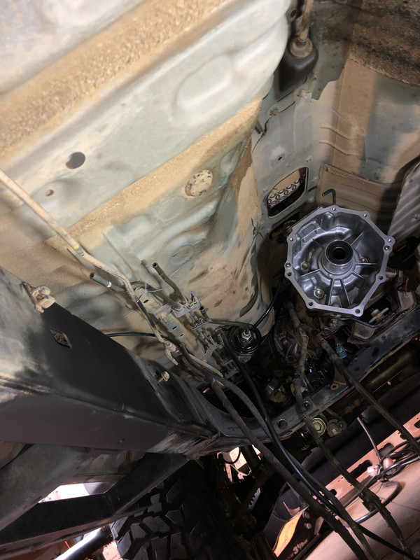

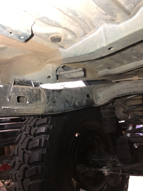

Cut out the crossmember and painted the frame, I’ve opted to only cut one side for now since the other side doesn’t interfere (mostly laziness lol)..

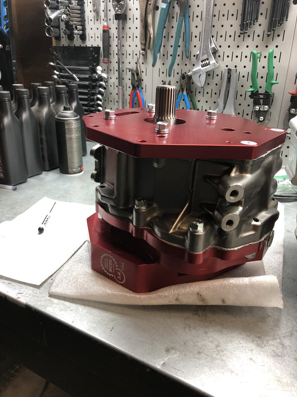

Tacobox mated to the oem transfercase
23 spline adapter and seal sleeve installed.
