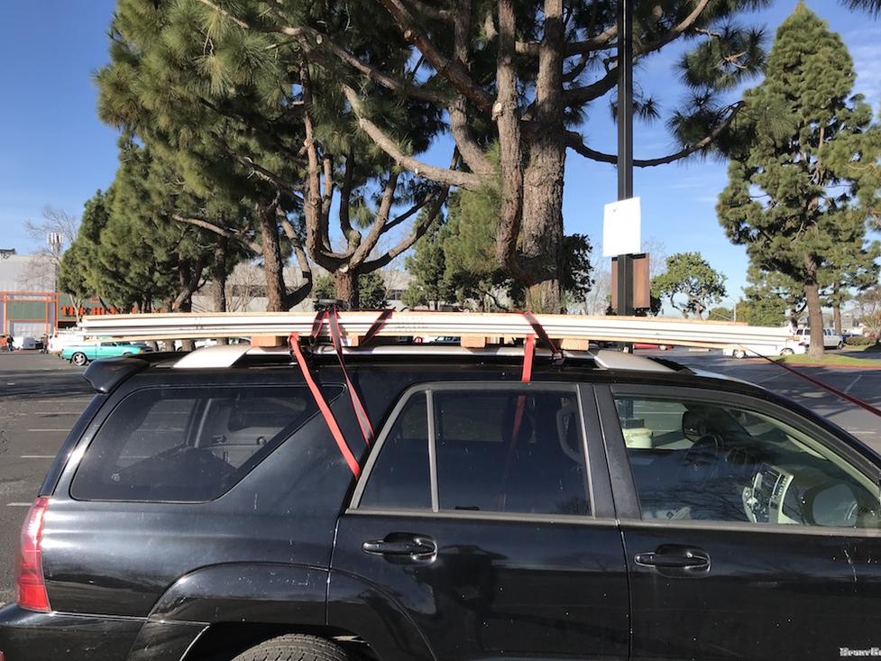

With that said, I just wanted to close out this thread by saying thanks to all of you guys for your support! I ended up cutting (2) 2x4s in half and laying them down in such a way that the cross bars were bypassed. Then I threw up a sheet of plywood and ratcheted those down (I didn't want to mess with bolting these to the rack).
I realized I only needed my sheetrock to be about 8.5 feet long, so I bought (4) 4x10 sheets and cut them to size in the parking lot. Threw the excess pieces inside the truck and put the sheets of drywall one by one on top (definitely doable, but it was a workout).
Then I threw on another sheet of plywood and used three tie downs to secure everything. Finally, used a 4th tie down from the front bumper. I didn't ratchet this down too hard, mainly just to keep the top sheet from flapping around.
I drove home at 25mph the whole way! I was watching through my sunroof and pulled over twice to double check everything was good. Honestly, I think it was secure enough to go on the freeway, but glad I didn't have to do that.
All the fixit forums were saying I was crazy, and a darwin candidate, etc...but you guys gave me a bunch of support on how to do things safely. Thanks to everyone!
