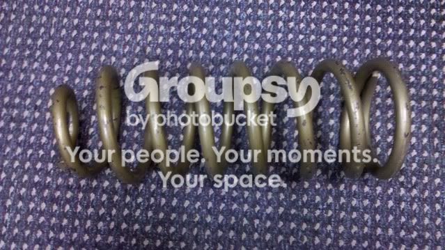

What kind of coils were your old coils? Looks good now!
Thanks! I actually don't know what kind of coils they were because they were on the truck when I bought it (the previous owner had the coils in the rear and a random steel spacer in the front). I have never seen anything like them on a T4R before, but maybe someone else might know what they are...
They look like a Downey Offroad coil. I know that Singtoe and APBLM (I think that's his Username) have them as well. I have a Downey coil, but mine are gold. What kind of lift did you get with those? I've only seen a handful of people running Downey coils and no one else running the gold ones like mine.
I was getting right around 3" of lift with them. I know they make both a standard and an HD so that may be the difference between the silver and gold. Are yours HD or standard?
I have no clue if mine are standard or HD, but I got over 3" of lift out of mine and they don't sag very much under load. I wish there was more info on them, but I haven't really found any and I assume mine are the HD version. Mine also have 8 wraps compared to your 10, but it looks like the thickness of the coils is greater on mine. Who knows, but I like them, especially loaded up.
2011-09-16_14-50-08_121.jpg~original
Yeah mine tended to sag under load so that makes me think that they were the standard version. As long as you're happy with yours, that's all that matters. I may just advertise them as standard and see what I can get out of them.

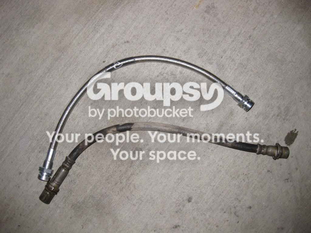

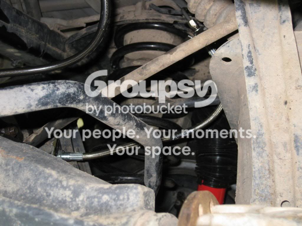

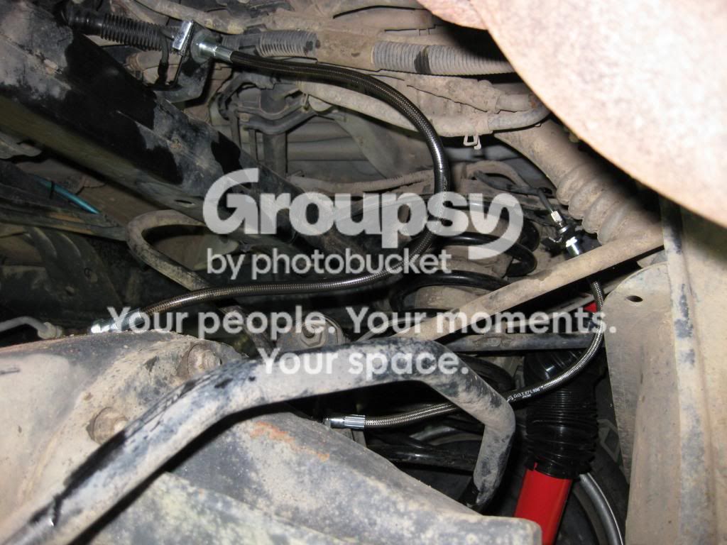

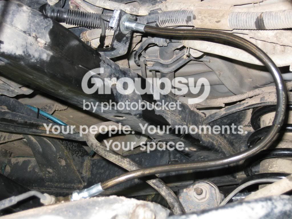

In other news, I got my extended brake lines installed tonight. I ran into one snag because one of the connections was pretty seized up and wouldn't budge. So, I had to bend the hard line to be able to get enough torque on it to break it free. Other than that everything went pretty smoothly and I will feel a lot better about flexing it out this weekend.
Old vs. new
IMG_0529.jpg~original
Installed
IMG_0530.jpg~original
IMG_0531.jpg~original
IMG_0532.jpg~original

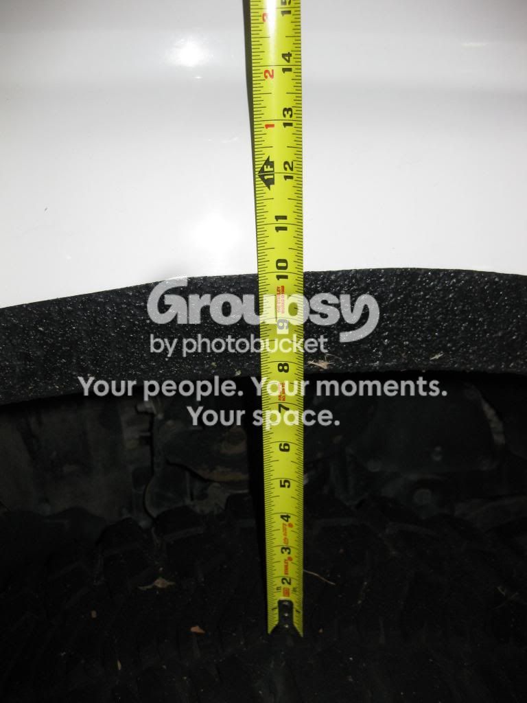

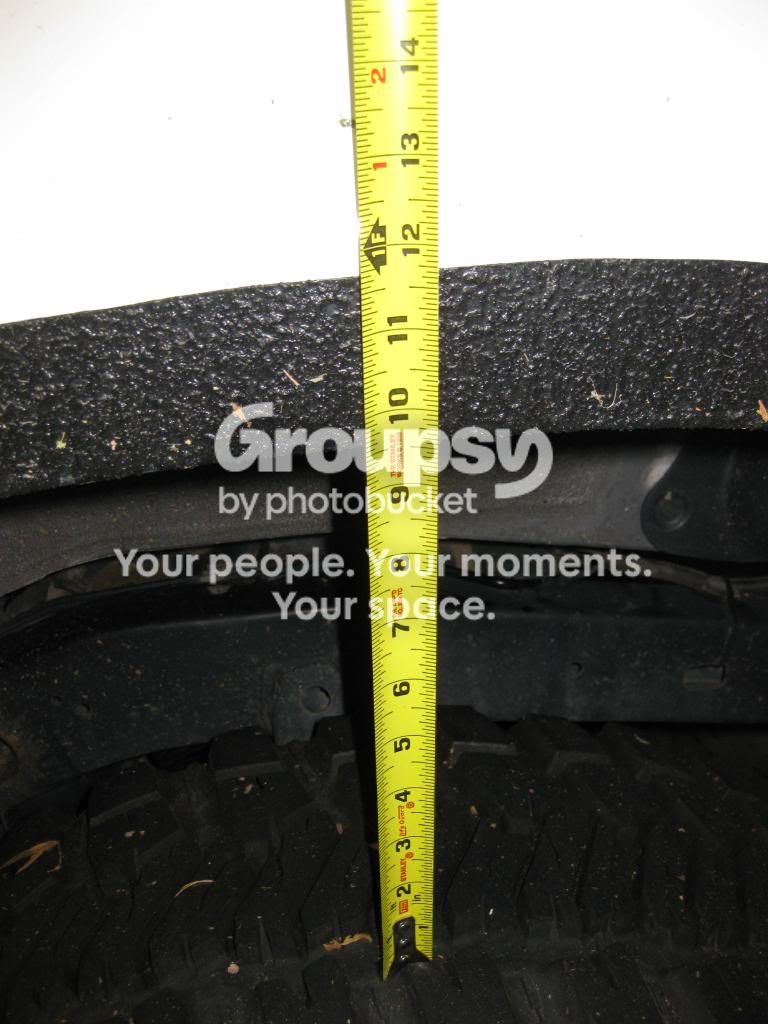

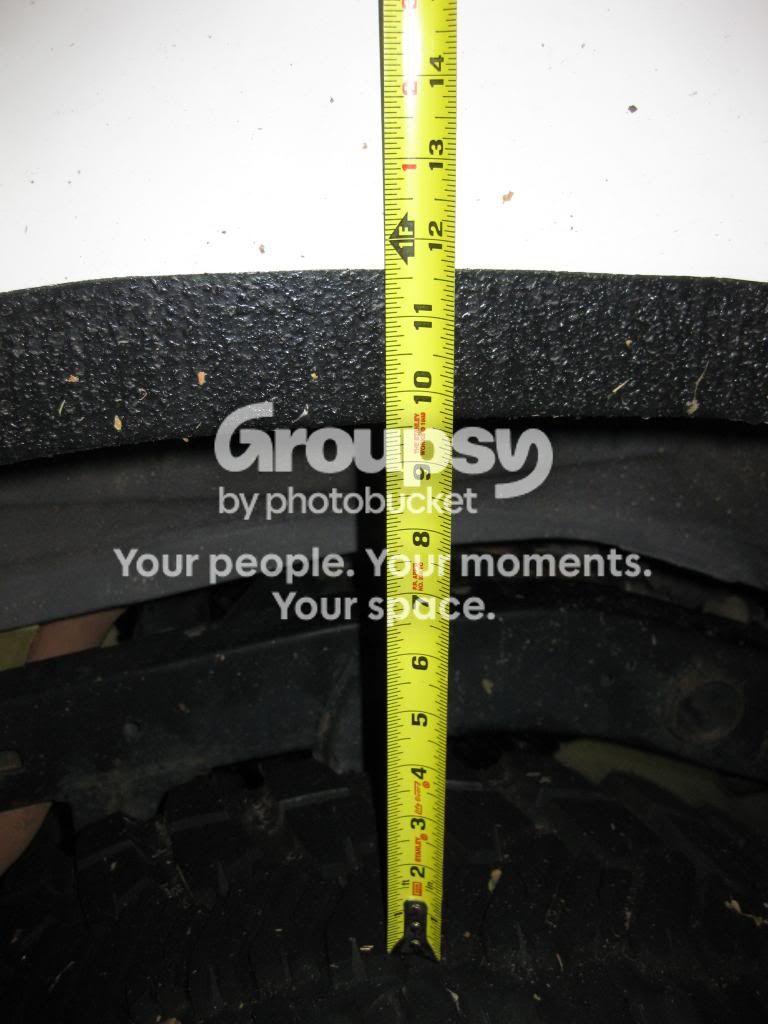

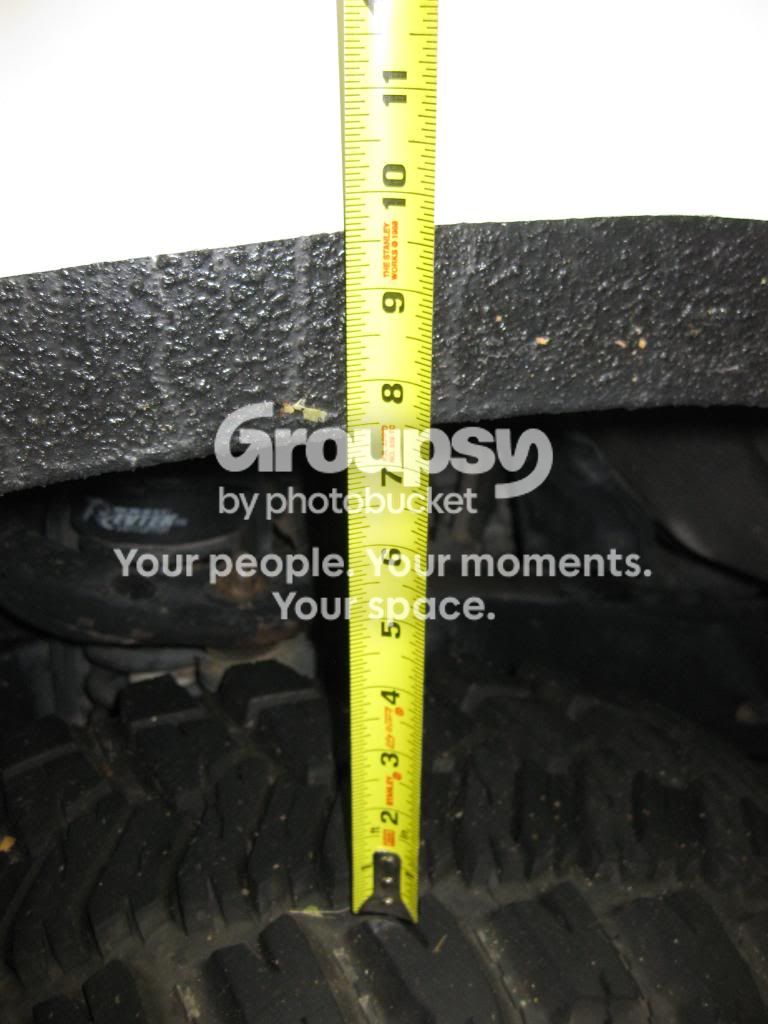

I also got some pictures of the measurements with the new coils. I have right around 2" of rake.
Driver Rear
IMG_0535.jpg~original
Passenger Rear
IMG_0534.jpg~original
Driver Front
IMG_0537.jpg~original
Passenger Front
IMG_0536.jpg~original
