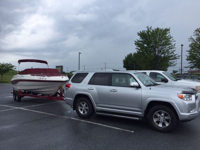

I did upgrade shocks to 5200's and it made a big difference with control and stability.I am able to maintain 65-70 mph once I get going and slow down going around turns, I am transporting boat to lake 90 mi from house and leaving at storage area near lake when not in use. I only have to tow to boat launch when ready to boat and launch is 1/4 mi away.
I am within tow rating of 4R so I should be fine, trailer has four wheel disc brakes and work really well with slowing down and stopping the weight.
What's the dry weight of your model? Have you actually weighed your setup?
My Caravelle 207 has an estimated dry weight of 3000 lbs and I'm running ~4600 wet. The 210 SSI has a dry weight of 3200-3400 and has 11 more gallons of fuel, so you could be a hair beyond 5000lbs. Not that the world is going to end if you are.

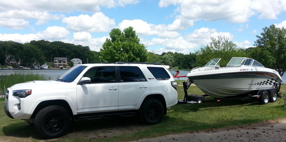

My boat weight overall is approximately 4500 lbs. I use AirLift air bags and trailer has surge brakes. Little slow getting up to speed but tows flawlessly down the highway 70-75 mph. No issues. My general towing is around 70 miles round trip. Gas mileage is around 13.5 AirLift bags help me tremendously. This set up works good enough for me. A Tundra will always be better if your wallet can justify it. = )
