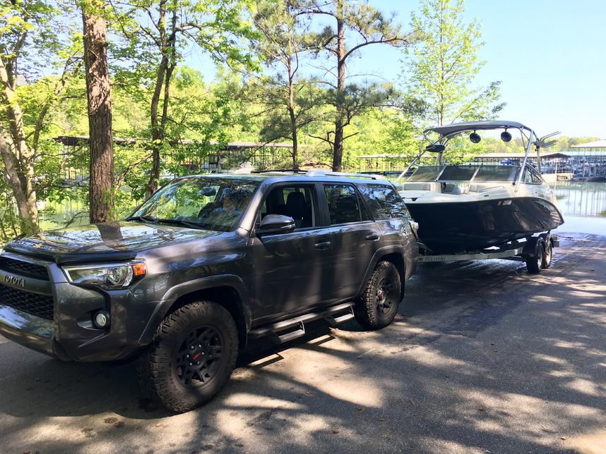

I plan on using the 4Runner to pull my 21' Yamaha out of the water each Spring to clean and perform maintenance. It's about a 20 mile drive over some moderate hills, fastest speed being 55 MPH. Trailer is tandem with surge brakes. Total weight on trailer, wet, would be just under 4500 lbs. I expect I won't have any issue doing so, especially since I take it easy when towing heavier weight, but will see come Spring.

It'll be fine. Won't win any races and you'll know it's back there, but as long as you use some common sense, just put the trans in S4 and roll with it.

Pulled our boat out this morning and drove 15-20 miles over hilly roads. Did the job like a champ.
