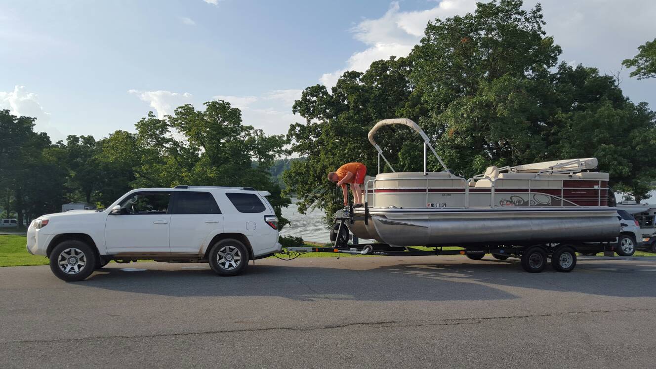

Pulled this pontoon boat for the first time last weekend. Normally we pull it with our cummins but decided I wanted to see how the 4Runner would do. It definitely was no Cummins but it did okay. Kept it in S mode and shifted how I wanted.
As you can see, it squats a bit with my buddy standing on the front of the boat. Without the extra weight of him on the front, it set pretty level.

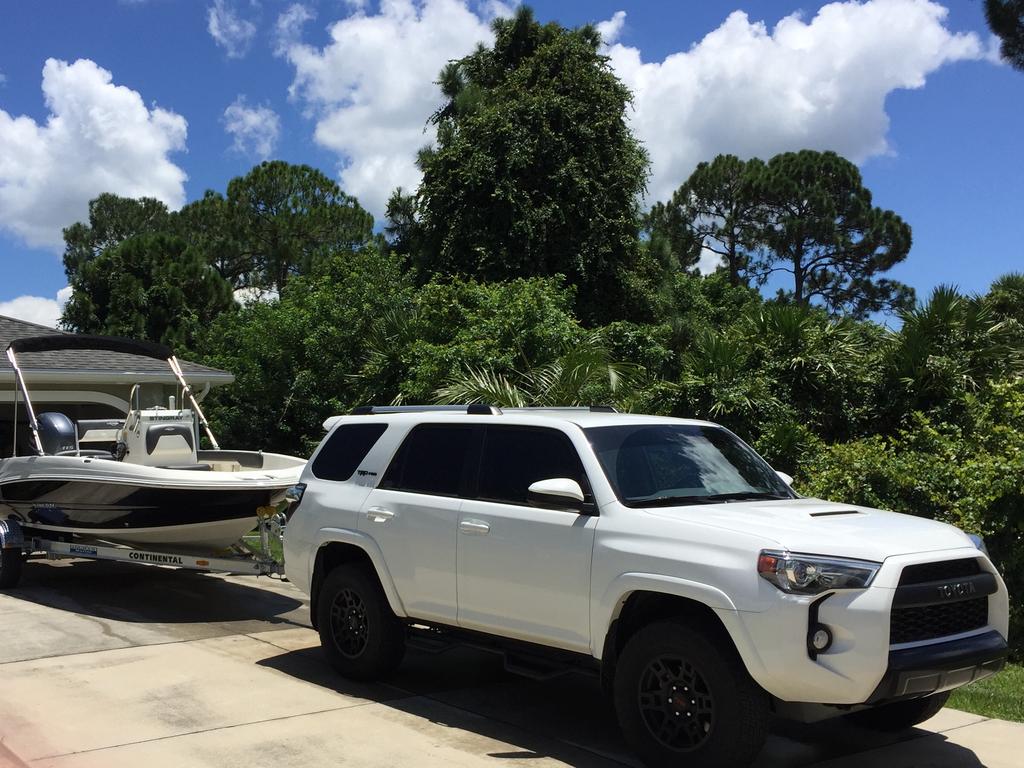

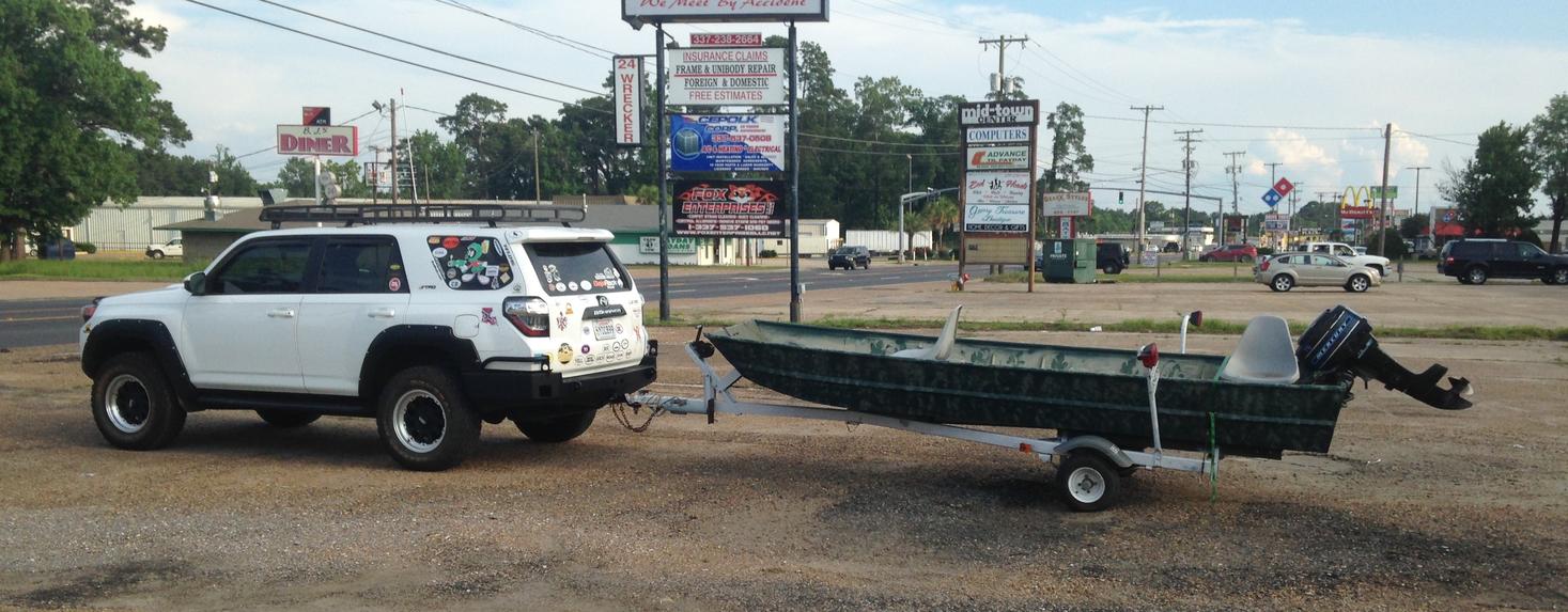

I'm pulling a 2400 pound 19' on a single axle and it's no problem whatsoever. I have the trailer set up right so there is almost zero back end sag. I don't think you want to run anything near capacity, not so much because of acceleration. It's the stopping that's gonna get you. Congrats on the new boat though!

I don't get all these worries about towing boats. I hardly notice mine is even back there. :hiding:
