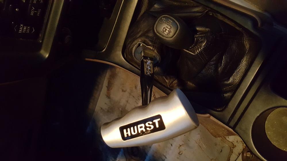

I always liked the short throw 4 speed T shifter in my 72 SS El Camino. So today I put a Hurst short throw T in my 99 SR5. Had to do a little cutting cause the shifter base is bigger. Had to cut steel divider plate for the boot and also the boot a little. All together now, just letting the RTV cure overnight so it wont leak and then I'll road test it.

Does the shifter sit any taller than the oe shifter . I definitely wish my stuck was a couple inches taller, and with a short throw it would be sweet.
Yup, you can get either stock height or there's an optional 3 inch higher one for body lifts. I gave its 1st run today, 150 miles, nice and tight short notchy throw, I like it.

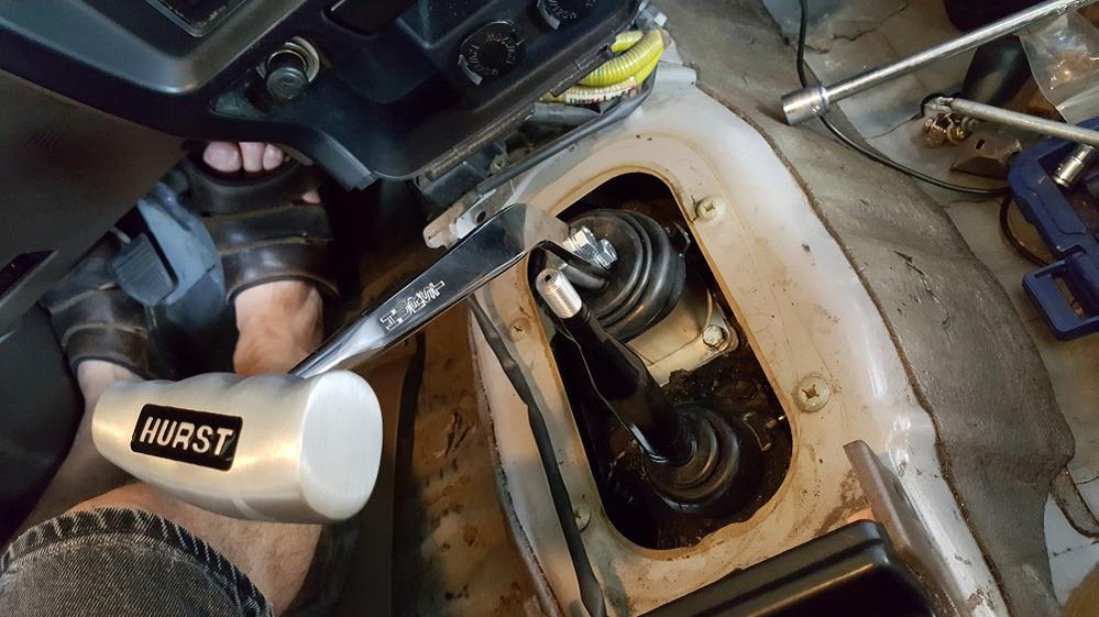

Here's the open view of the base on install, doesn't look like site pic cause they have so many diff ones.
Looks really cool, its nice that it comes with the chrome shifter rod, it is the only one that doesn't reuse the stock shifter rod.
Is the base made of steel?
Also it seems like the shifter is slightly moved to the passenger side of the car, when in H2 and Reverse does it interfere with the transfer case shifter at all?

Yes the base is steel. Its all good on distances and plenty of room between the shifter and transfer in all positions. The shifter has an angled bend, look at the 1st pic I posted with the console boot on, the one with the console boot off looks deceiving cause of the angle I took the pic.
