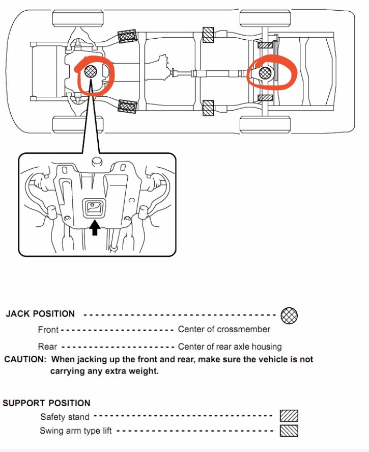

Does anyone know have an image for the jack points for a 5th gen?
It is in the OM. If you don't have one they can be downloaded.

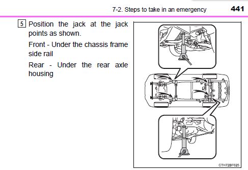

Thanks! Do you know about the rear and front center jack points when using a garage speed jack (not the stock jack)?
Is this what you’re looking for? From the user manual:
