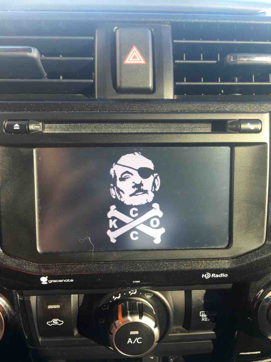

Need this with a blue stripe.
Sent from my Nexus 6P using Tapatalk
Good call
https://www.dropbox.com/s/42no51hkv1i8yvs/Toyota Screen Saver Blue.jpg?dl=0
K.C.C.O.
http://uploads.tapatalk-cdn.com/20161117/c8f1eb81f8b2222eaa58d6e1854548fc.jpg
