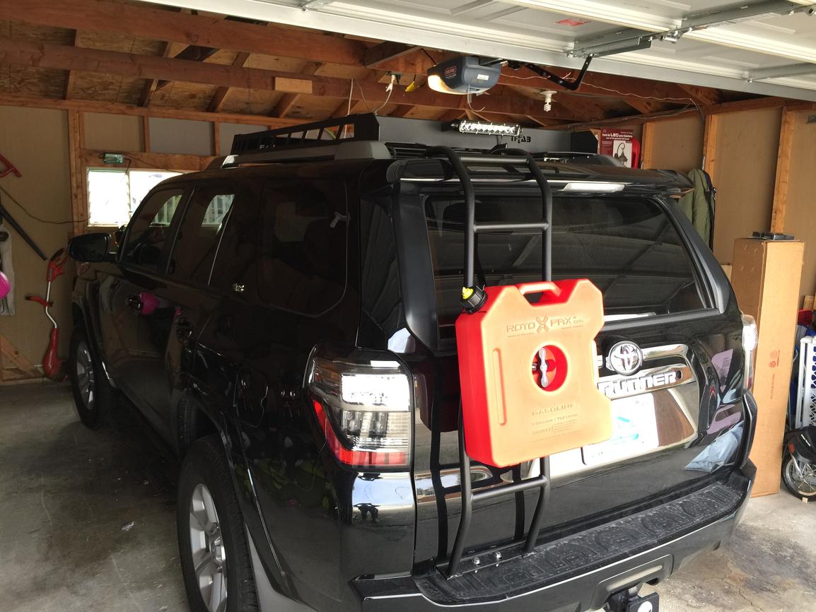

Heres my nfab rack from Amazon,remember price changes weekly and i got for 540 prime free shipping, can easily be lifted off by 4 bolts if need be. Works well with bajarack ladder. In case anyone asks. I drilled holes for the rear 10" light flood bar, not connected to backup lights rack has lots of cut outs on top for lighs but they will place them way too high for my taste but if you want let say a 20" up top make drill your own hole on slated front bar. Also unseen are diodnynamics full kit and highly recommend. And modified rotapax polaris mount on ladder 3gal pack.FYI you need to upgrade to stronger hatch lift supports if installing rear ladder.

The ladder was to heavy for the stock lift supports? I have the same roof basket. Any issues with the ladder with the basket?

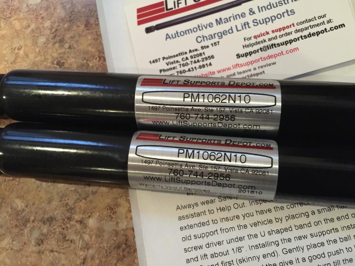

The lift supports haven't failed yet but they will. The hatch no longer lifts on its own it's basically brand new. Went to liftsupportsdepot.com part/sku PM1062N10W. Will update later this week. With ladder no interference at all, plenty of room to open does not touch rack. If you decide to add a light bar like I did it or anywhere else it's easy to drill through the aluminum. Before ladder install buy lift supports first.
New lift supports
Got the new lift supports installed 10min. What a huge difference, pops right up without flying wide open or slow crawl like stock ones. Do not try without ladder! Pm if anyone needs stock LS's.
