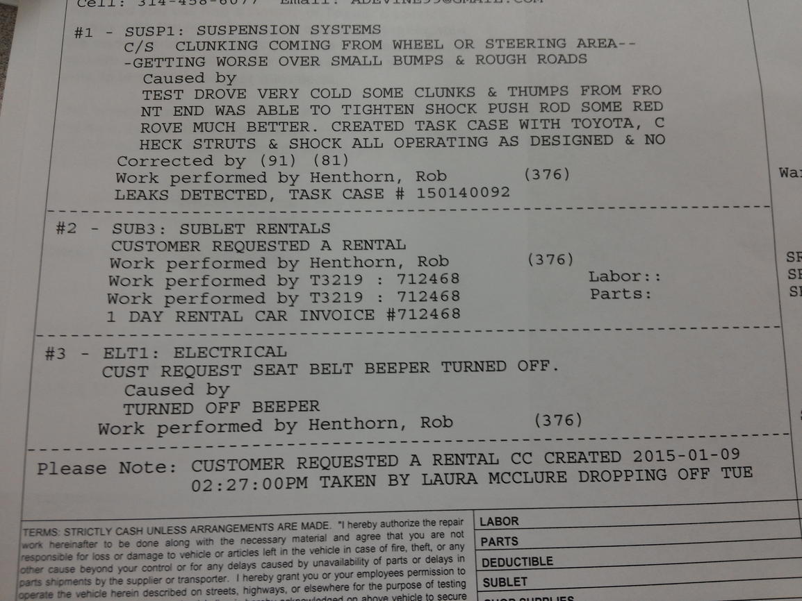

It was 8 degrees last night and when I started driving most bumps I hit the clunk sound from the front end was very evident. It sounds like there is something loose or something hitting another part (Sorry for the non-technical description)I haven't taken it to the dealer yet but its very annoying from a vehicle with less than 1500 miles on it and it definitely is more noticeable in colder weather.
I remember others hearing the same thing. If anyone has any updates on this or has figured it out please post. I am wondering if the TE has this issue too or is this only a TRDP thing.

No, nothing yet. Its just plain annoying and very noticeable. I didn't take it to the dealer yet but from what I'm hearing they are no help and no service bulletin posted yet. May have to stick a Go-Pro camera pointed at the moving parts and try to replicate it. I will also check out 444's note on the clunk thread

The dealer said both shock push rods were loose.
Not completely, but it is very hard to detect now. Definitely an improvement. Also posted in TRD Pro clunk thread... Never herd of a "shock push rod"...anyone?
