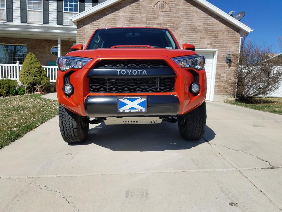

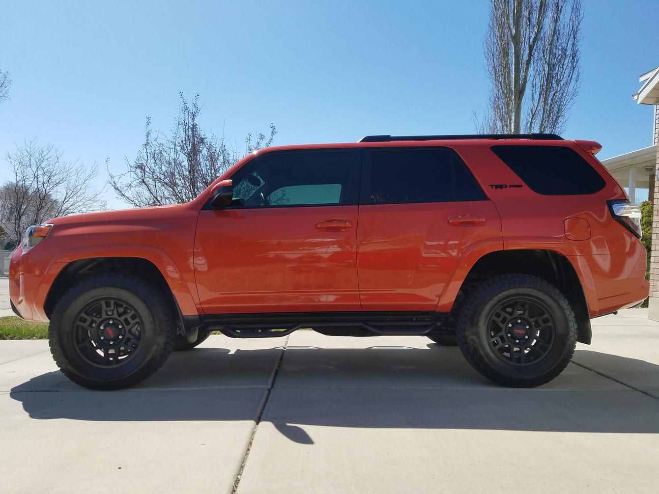

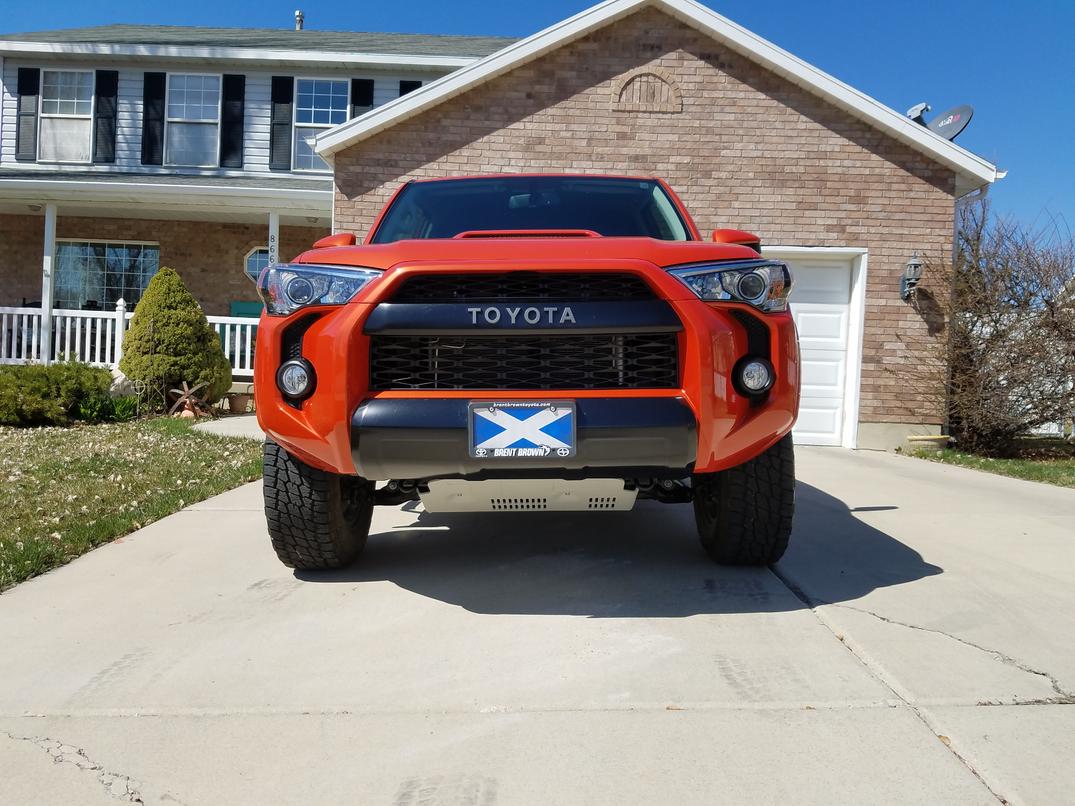

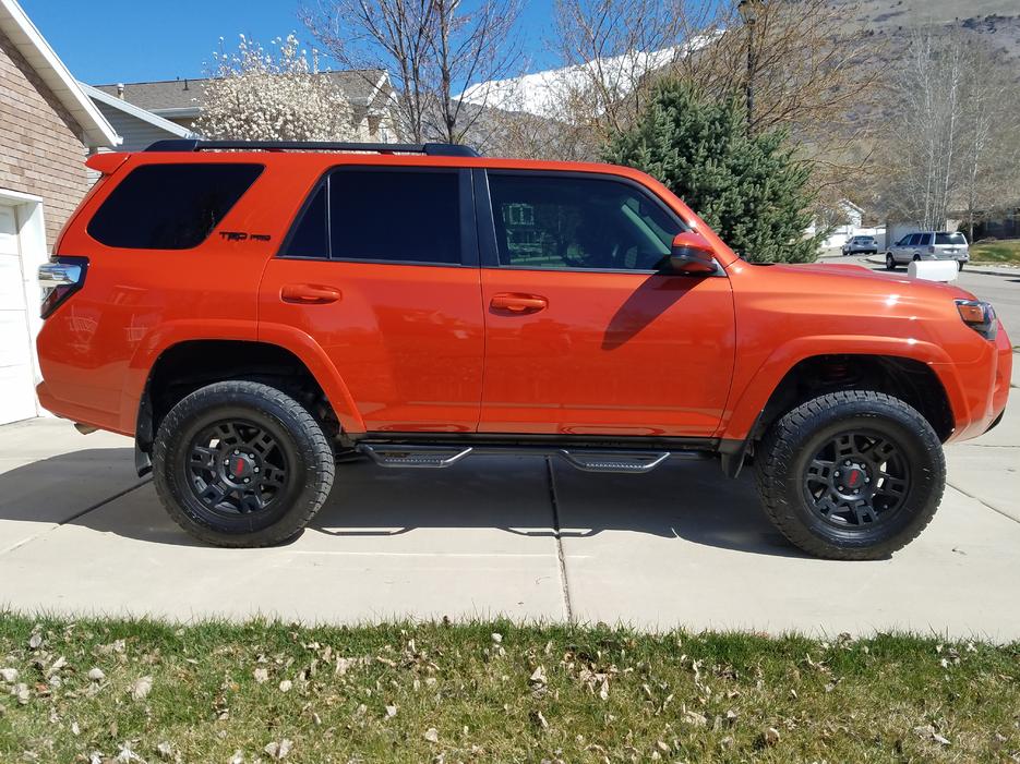

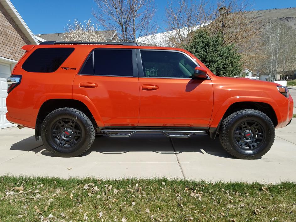

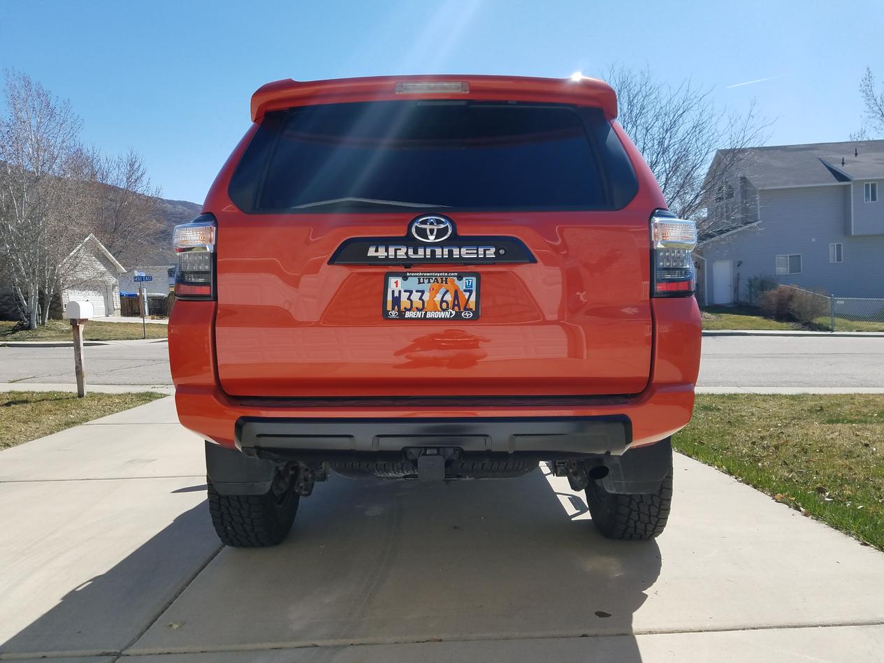

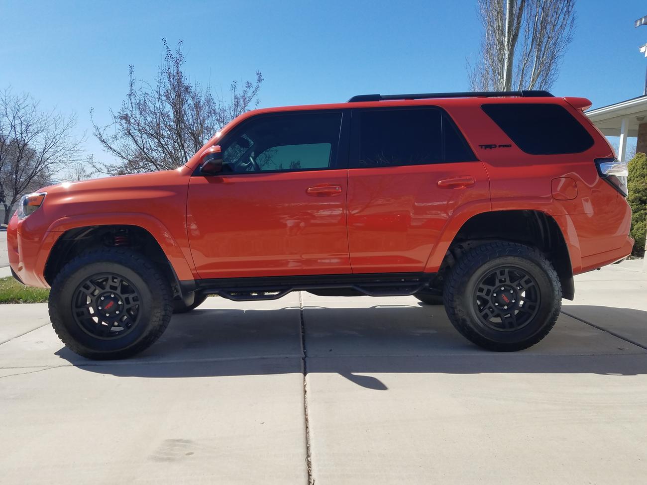

Just finished putting on a small lift and some wheel spacers. May get rid of the spacers because of a little rub. But I love the look.
Lift here -> Toytec lift kit for TRD Pro 4Runners
Spacers -> Spidertrax wheel spacers
dump the spacers, dude. they will be more trouble than they are worth. i also have the toytec kit and I'm happy with it. I was able to sell my terra grapplers for $500 with 13,000mi on them. They went very quickly. Used that $$ toward 285/70/17 TRAIL GRAPPLERS and it totally changed the look of the truck and the tires are awesome off road and pretty quiet on the pavement. just some food for though.
i ended up getting the TRAIL GAPPLERS for about $930 dollars for the set. well well well worth it. they are very badass.

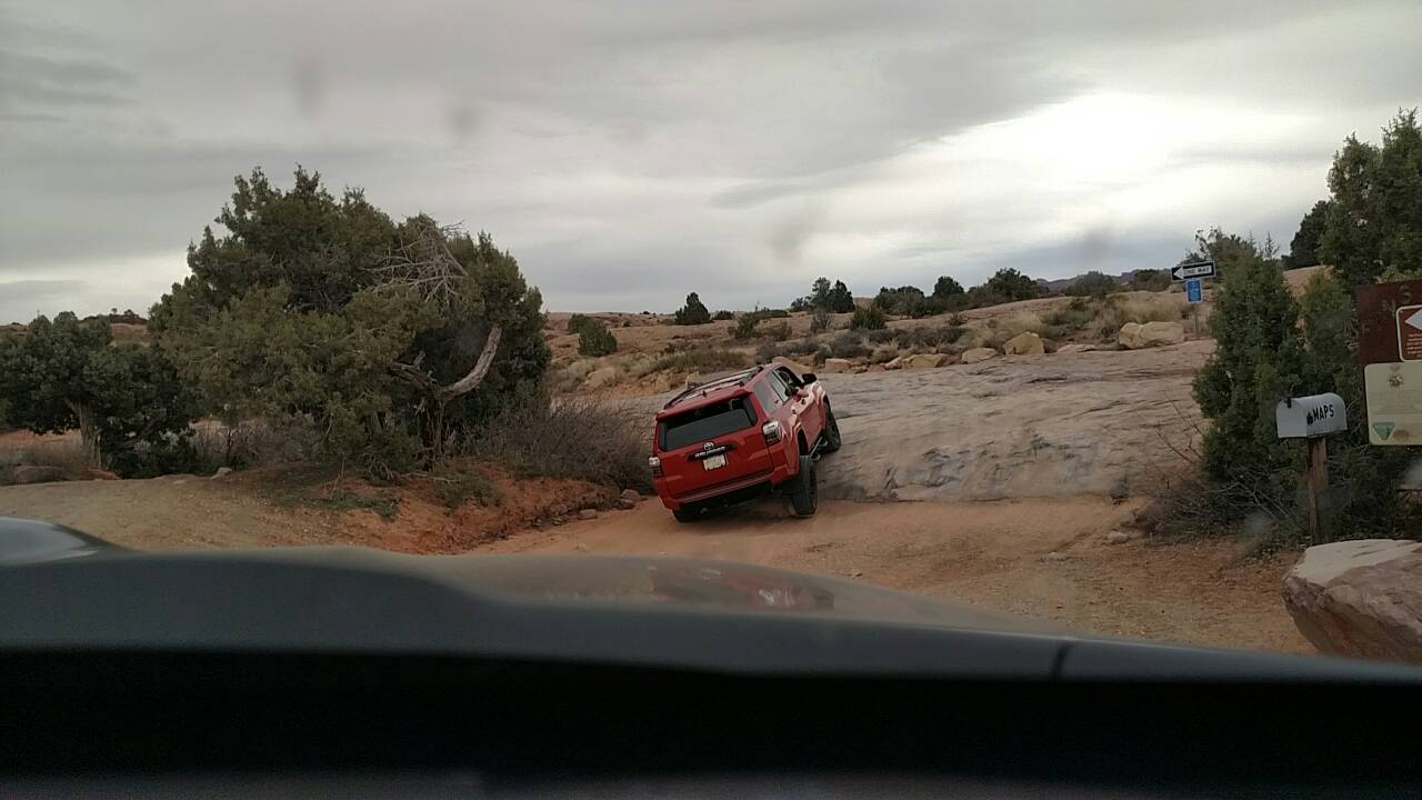

Very nice! Where was that? I have had mine for one month and I haven't taken her offroad yet. Not sure where I can go here in Utah besides MOAB.
This was in Moab. Haha. The thing is a beast off road. Went all the way through Fins N Things with no problems at all. And this was before the lift as well.

Only on the driver's side at full right-hand lock when backing up (and it is very very minimal at that). Otherwise, no rubbing. I'm putting on the ToyTec TRDP lift this week so it will be a non-issue soon.
You may rub with the 1.25" SpiderTraxx though, even with a lift, as you'll be moving the wheels/tires along a larger arc as a result.
I would definitely get rid of my Spidertrax when I do upgrade to 285s. Thanks for the input.
