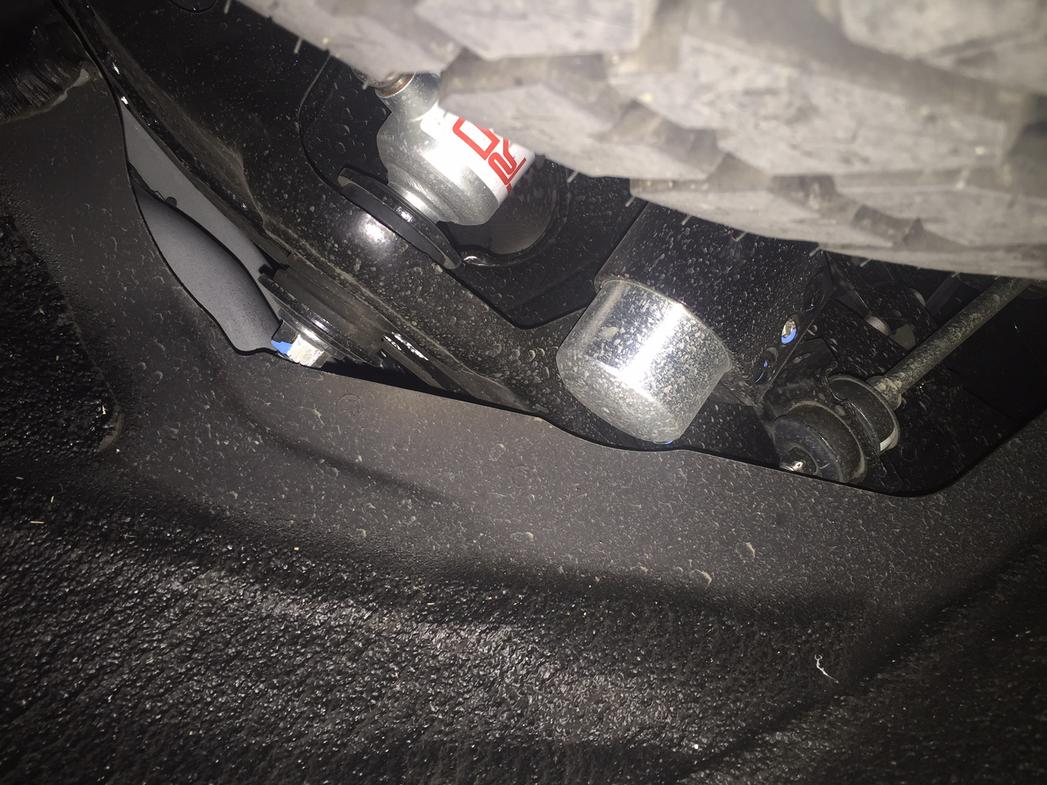

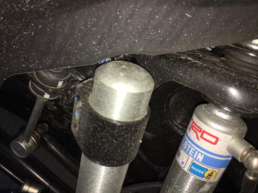

Same problem for me. Did the dealership discuss cutting the metal before doing it?
It seems like loosening the bracket and moving the reservoir down makes more sense.
Update:
The left rear reservoir was the issue. They loosened the bracket and moved it down slightly.

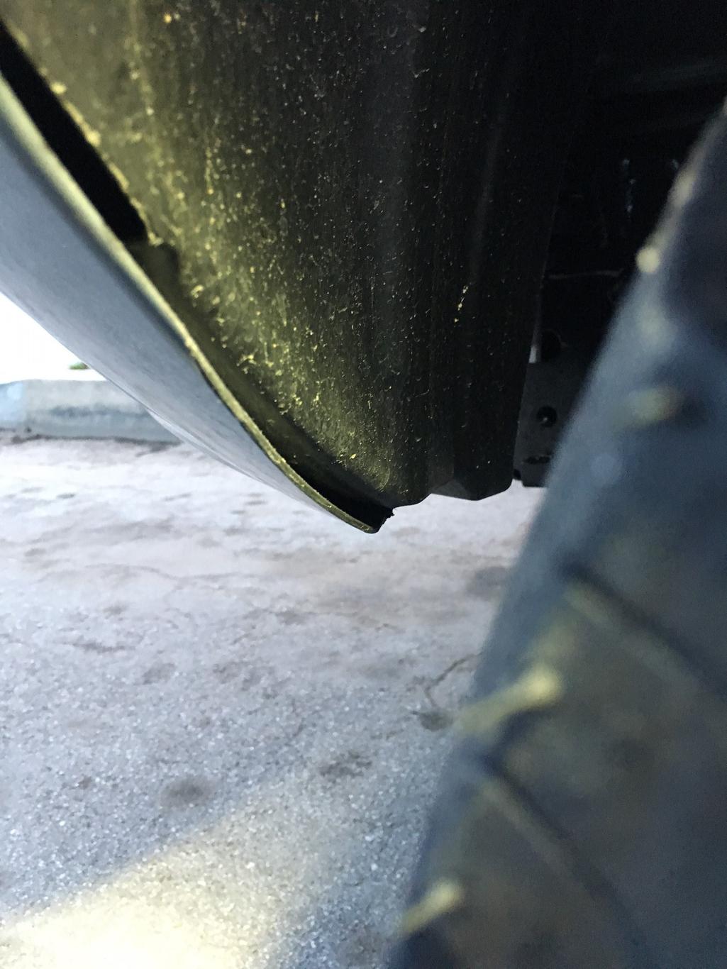

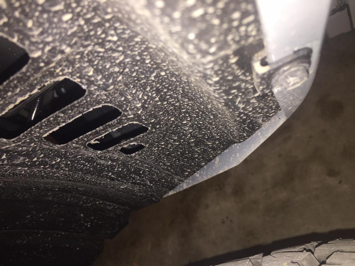

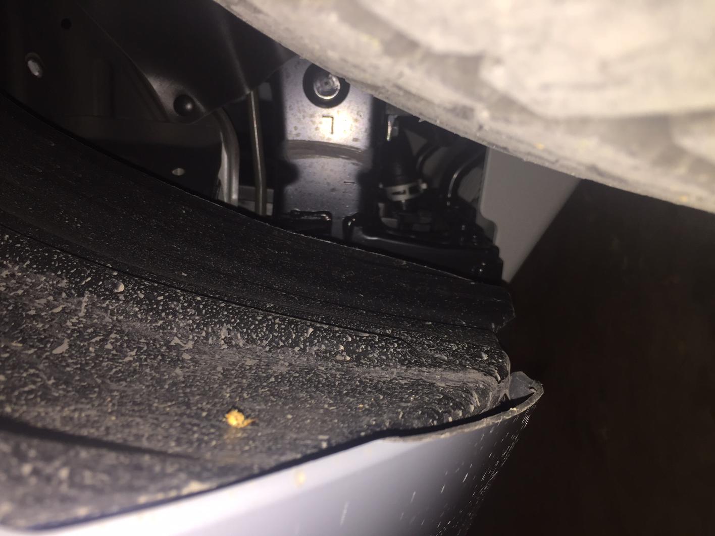

how is the front bumper cut? anybody got a pic?
Here is the bumper trimming and the cutout (same on both sides).
My truck is totally fine, but again based on others experience, when you pick yours up make sure to take a flashlight and look these specific areas as well as the rest of your inspection. Just make sure they didn't do a hack job. If you can point it out on pickup you're likely to have a better result on fixing anything.

Interesting, I had no idea these things were done at the port. It doesn't bother me at all and never ran across that in my research. Here are some pic's of mine. I'm assuming it came into a Texas Port. Looks like someone knew what they were doing.

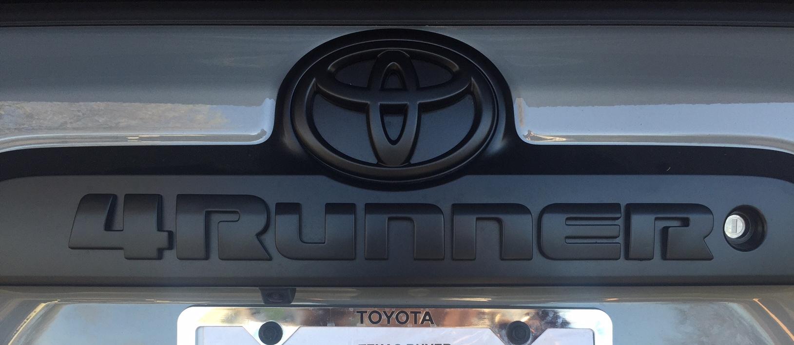

Oh and I got my overlays installed today. I highly recommend these. Super easy to install.
