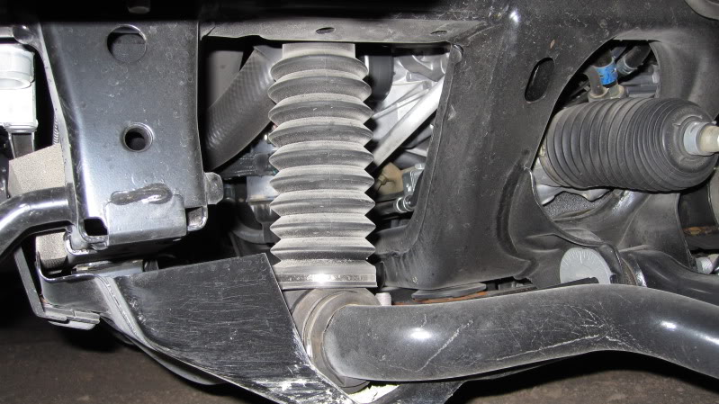

Clearance is lower on the KDSS 4Runners. BudBuilt & Shrockworks both build different skids for KDSS vs non-KDSS equipped vehicles. KDSS front skids sit lower to protect the piston holding the swaybar.

OK, this is good data ALT4R, I wasn't aware of the piston/clearance issues.
So, it may not be as simple as cutting the skid for a KDSS equipped T4R.
We need more data......
