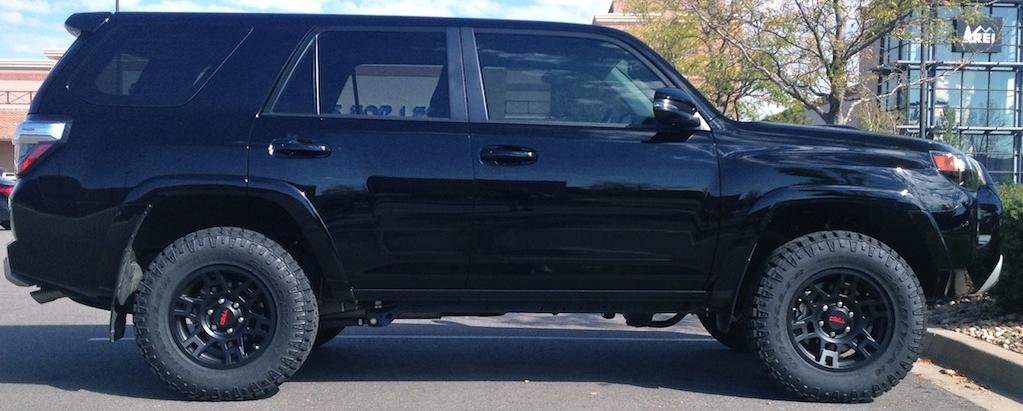

I installed my Icon coilovers and rear shocks over the weekend and forgot to take measurements before starting. I wanted to match the look of the prototype TRDP. I ended up adjusting the front to 21 inches. The rear sits at 21 3/4. I have a 2014 TEP with 5k miles. 265 Goodyears. Still looks a little low to me. I might adjust them up a bit more before alignment.

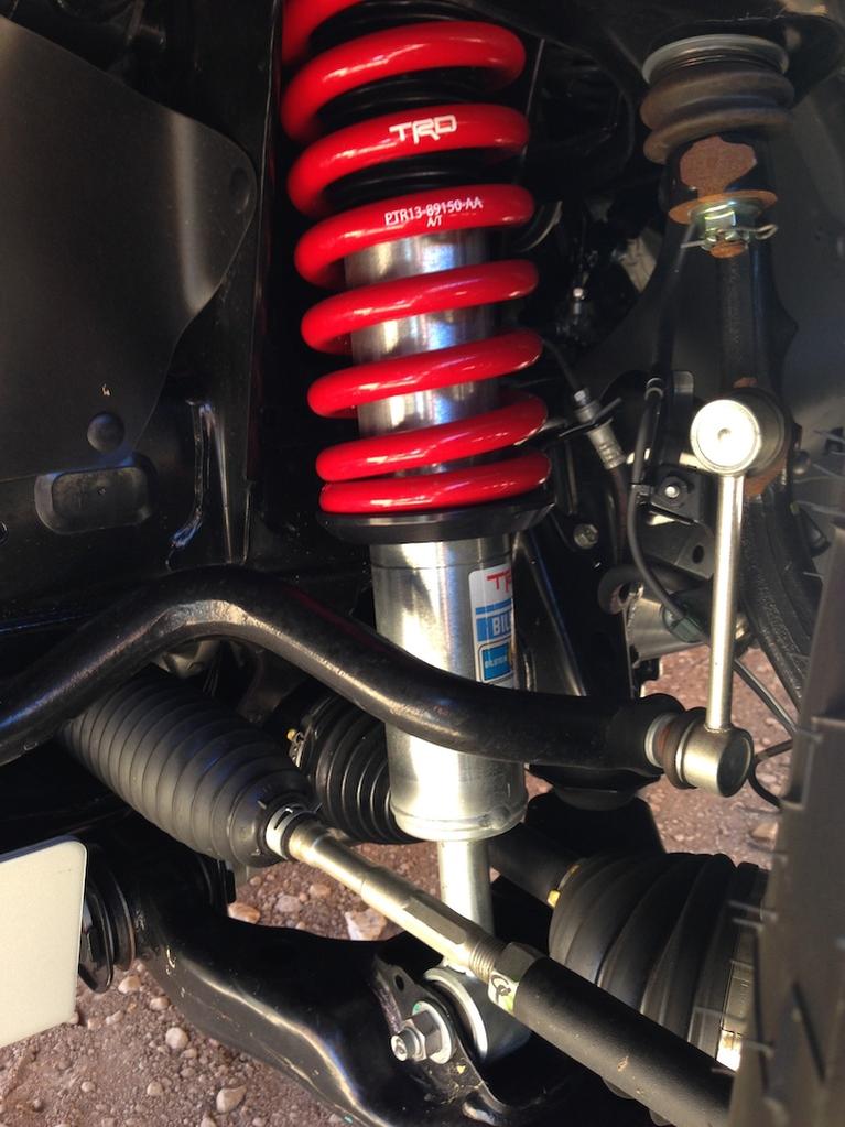

hey jrandom...... Looks like it is the ones with adjustable heights, this is a couple of photos from a port install kit:
Maybe they are. I should correct myself there are 4 notches, Stock, 0.85", 1.75", and 2.5". From that particular picture you could guess the notch you see below the spring seat is 0", I would think you would be able to see the fourth mark through the spring though. Dunno. :shrug: I am interested to know.
It just seems that would open them up to liability of premature wear and tear on CV's and associated parts if people start moving them up to the 2.5" mark, since I believe they would be considered OE parts.
Would need another picture looking from top->down to see.
