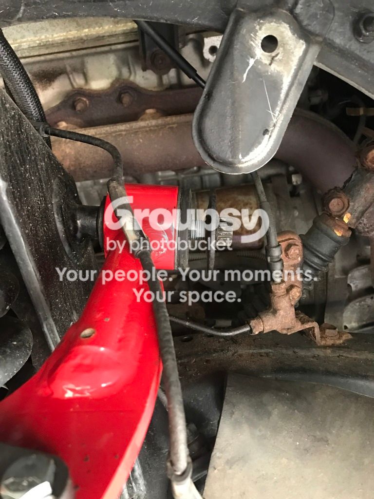

Great write up. I just finished installing mine. The JBA instructions differ slightly from yours in step 16. When the pin goes through there should be a thick outer washer, then the UCA, thin inner washer, then tube, thin inner washer, UCA, thick out washer. It seemed impossible to get it all together with one person (I borrowed my neighbor for that part). It takes someone pushing on the bolt while the other wiggles all the pieces into alignment.

Here's a pic. The instructions are not clear which washer goes in which place, but it's really tight, so this is the way I put it together. It took two people to get the UCA in place, one holding one of it, the other putting the inner washer at about 45 degree angle and using it to ramp the other end in place so that both inner washers are there.
Prior to getting help, I was considering using a bottle jack to stretch the UCA slightly...probably not a good idea.

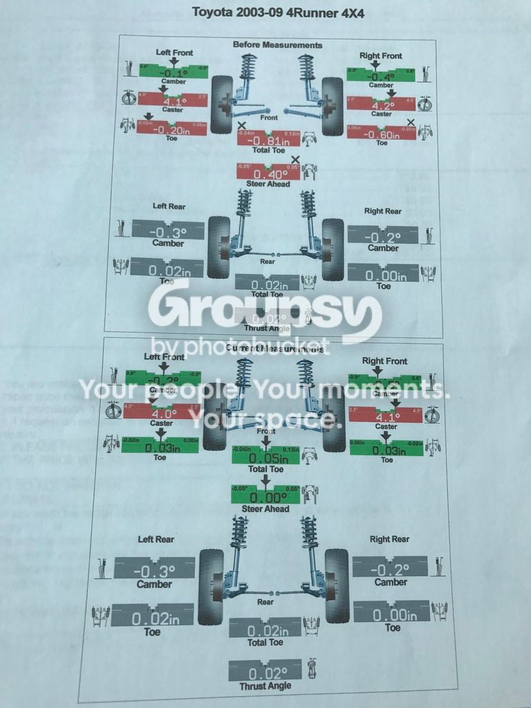

Caster
Your caster still on negative after the alignment, why is that? Its supposed to fixed it right?
One last thing, here is my alignment printout:

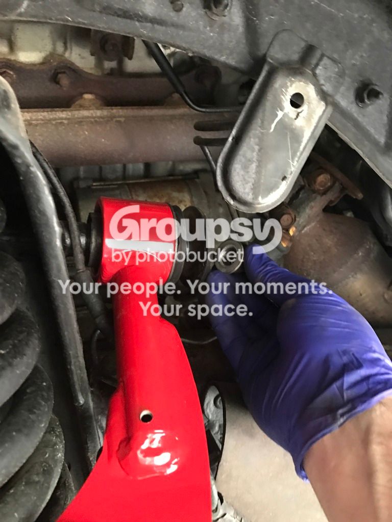

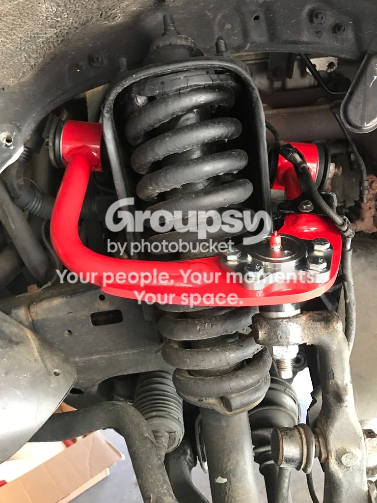

15. Place new UCA in place, and thread in through bolt.
16. Replace through bolt washer and nut.
******VERY IMPORTANT******
The orientation should be: Long Bolt, Large Washer, A-Arm Bushing, UCA Tube mounted to chassis, other side, A-Arm Bushing, Large Washer, Nut
Also, make sure the Lower Control Arm is supported by a jack. The weight of the vehicle needs to be on the UCA for the bushings to seat properly. If you tighten the UCA through bolt without weight on the suspension, the bushings will be destroyed quickly.
You can torque the through bolt with the wheel on the ground, and the weight on the tire.
Torque nut with torque wrench to 85 ft-lbs

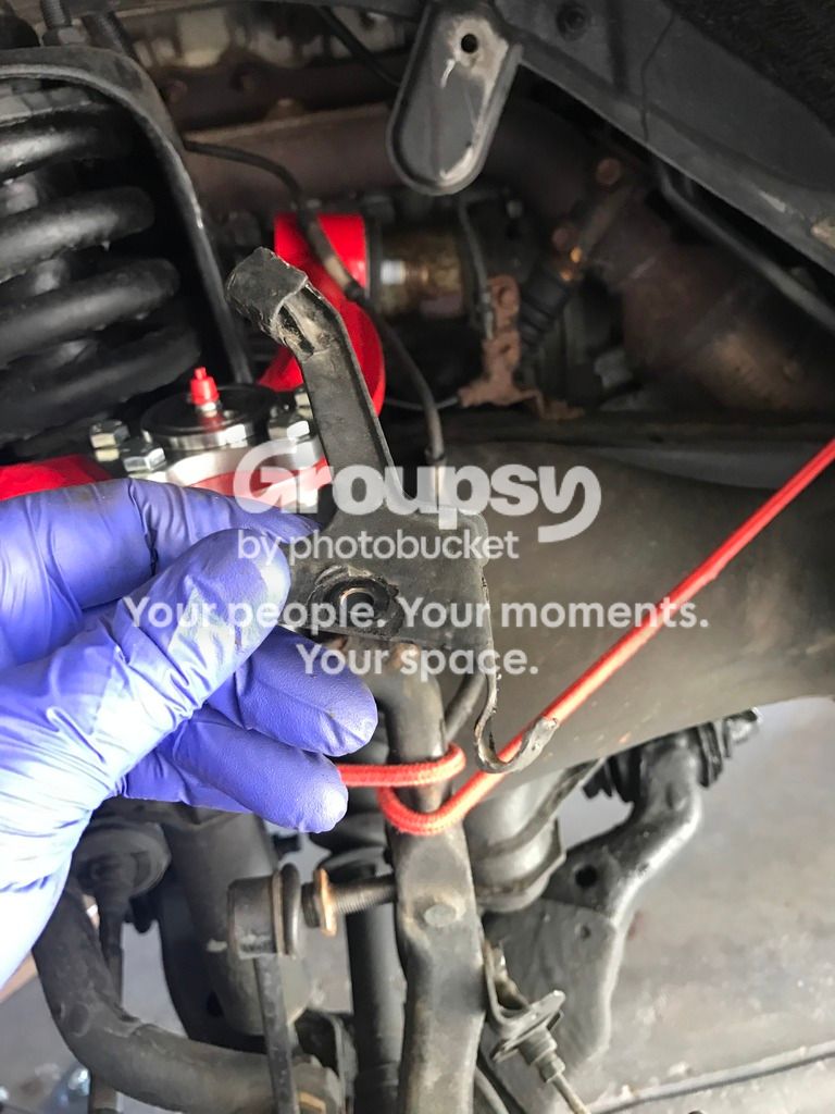

17. Place ABS wire bracket back on new UCA. I had to bend the shape of the ABS wire bracket on both sides to get it to fit just right on the new UCA, and then had to cut and reposition the rubber sheath around the wire (CAREFUL!!!), then bend the tabs on the bracket and gently crimp them around the ABS wire. If you cut or crush this wire, you'll be pretty bummed out. You have to place the wire in a spot where the articulation of the UCA won't pull or crush the ABS wire. There is room, but just barely.

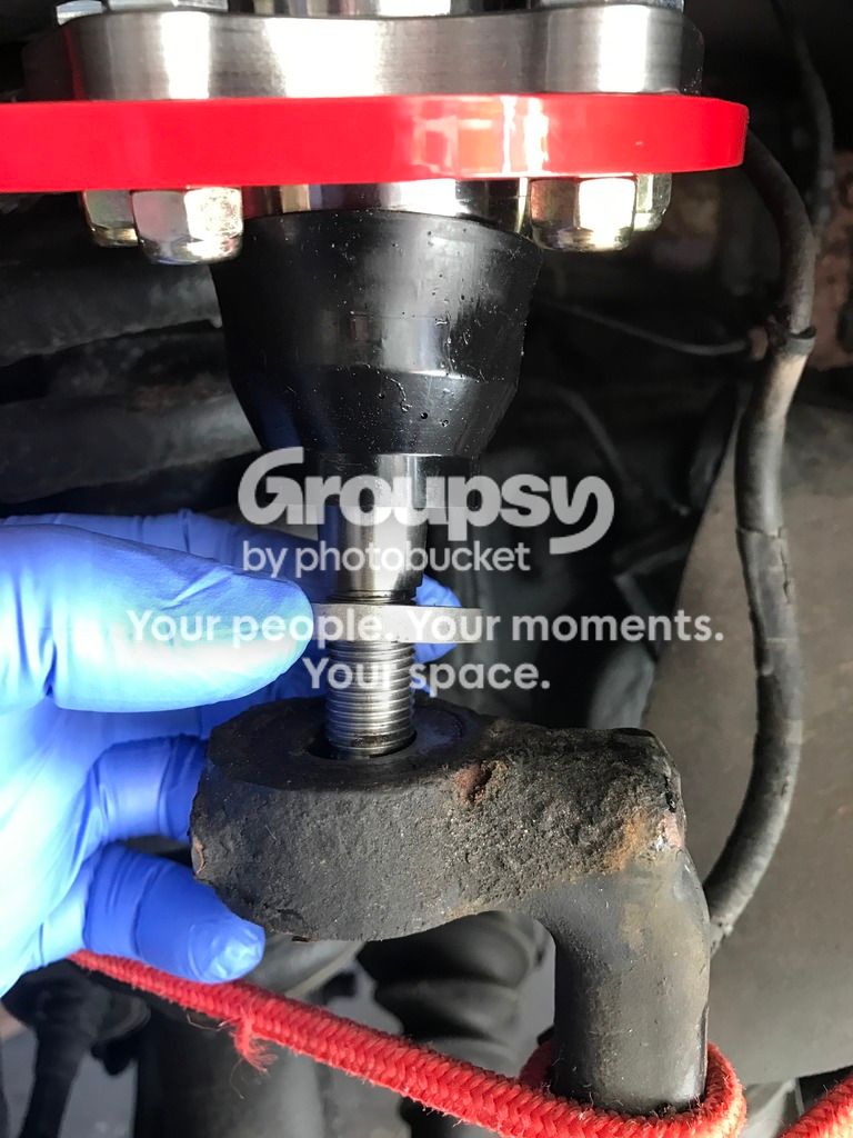

18. Place the supplied washer ABOVE THE KNUCKLE AND BELOW THE BALL JOINT and place the ball joint stud into knuckle. (Some have questioned why the washer is there. It seems to be to keep the grease inside the boot. So yes, the washer goes ABOVE the boot!!)

I'm doing these on a 2016 4Runner. Mine came with four washers two thick and two thin and in the write up it says I should have a washer on the outside of the bushing and on the inside of the bushing but there is not enough space to get the control arm in place, has anyone had this issue or do I not need the interior washers... Please help running out of beers and patiences

Big washers go on the outside, by the nut and the bolt, the little washers go on the inside, by the tower/strut area. This video (it starts on the important part with the washers) shows big washers, but the theory is the same.
Big - Little - Little - Big
I just spoke to Al on the phone, and he said definitely use all 4 washers. And he mentioned that a helper would be helpful at this step.

I just installed the JBA control arms on my 2008 over the weekend. I found the washers to not be too bad, but a little bit of a wrestle. The technique I ended up using, was a pry bar once it got to the rearward bushing to slide the washer in. The bushings flex enough with the right leverage, and then you can slide that around. There seemed to be just enough width to get the front washers both in place, without any leverage. All in all took a little while but not too bad, and I was doing it by myself.
