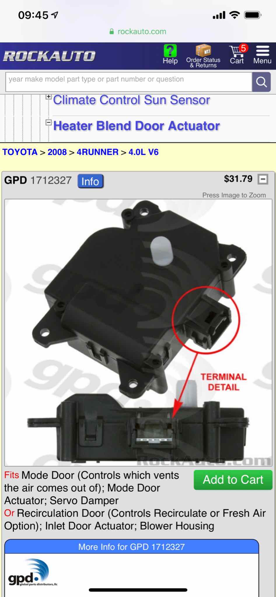

Took apart the glove box, and located the vibration/buzzing noise coming from the actuator (which is in an incredibly inconvenient location). I wrote the part number down, but can't seem to find a place to buy that specific part, any help is appreciated!
Denso
063800-0660
12V 3K 5270 AUTO
Just replaced both of mine with Ebay items - total of about $200. They work great. Read all the threads on how to replace them, because there is a trick to getting to two of the screws that are terrible. I did both of mine in about 90 minutes.
