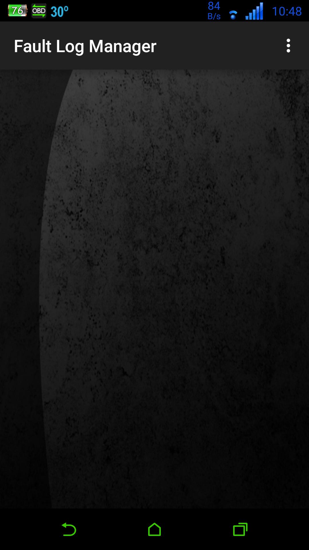

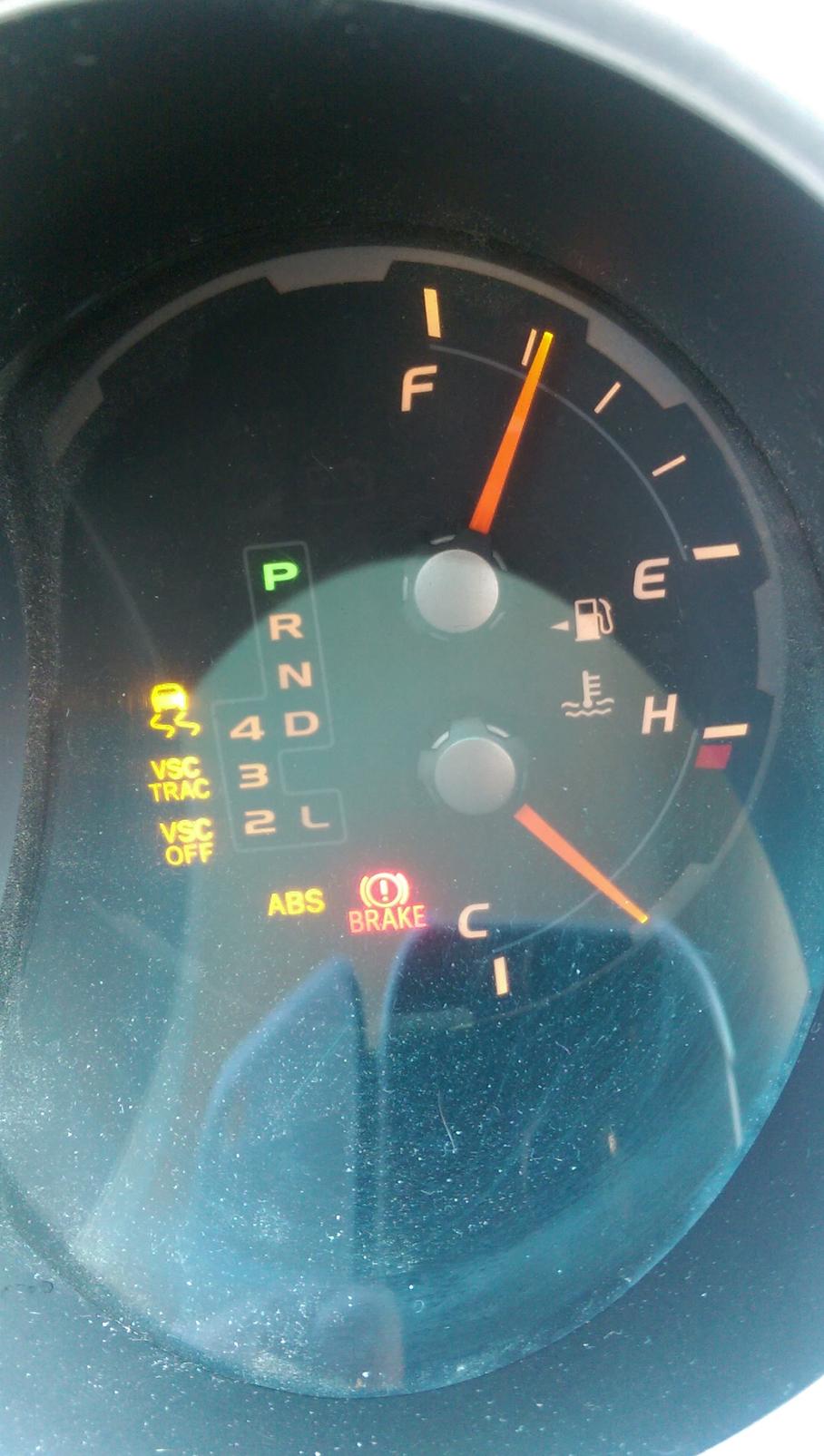

I have an issue guys, damn lights are on and I don't have any codes! My abs light is on too so I am thinking it is something to do with that, but I'm at a loss as to where to start here. Some pics:

I had the same lights come up on mine recently minus the vehicle skid light. Get ahold of a code scanner with ABS capability. I borrowed one from Advanced Auto the other day. For me it was the passenger front ABS wheel speed sensor.

If you disconnect the plug on the side of your master cylinder it results in the same lights. I installed a switch to do this whenever I want less intervention by traction control etc. Not sure if that helps.

Stopped at advance auto parts and had codes checked. It said all 4 sensors were bad and control module. Gave me a code of C1223 which after looking up could be something as simple as a bad gas cap (which I do and replaced just now), zero point calibration, or as major as the abs ecu which is like 2k! So... I replaced my bad gas cap, lights are off, hoping that's all it was...
neither of those are check engine lights, no codes will be shown by them.
Well the lights keep turning on and off at random as I drive. I'm wondering if some condensation or if there is a bad connection somewhere, somehow.
My warning lights (vsc, trac, abs) were intermittent at first too. Then they became constant with the addition of the brake warning and a CEL. The scanner told me all four of my sensors and the control module were malfunctioning too. I also had the C1235 code (metal sticking to pass front sensor) and the P0500 code (vehicle speed sensor). I wiped down that sensor and unhooked the battery to reset. The CEL and Brake warning are gone for now. I'm gonna get it rescanned to see what comes up.

When my wheel bearing went out last fall it had tons of crap in there. I sprayed it all out with brake cleaner, wonder if I missed some.
