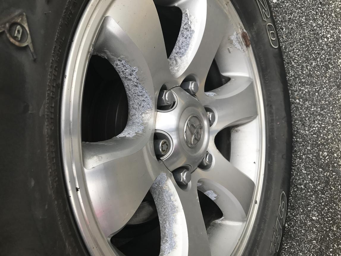

Seeking wheel repair suggestions.
I'm assuming this would be a sand, prime, paint job. But I've never attempted to do rims before so I was curious if there was any useful operating experience/suggestions out there.

I've painted wheels a couple of times, not on my t4r though.
Be sure to sand every single inch of the wheel surface. I start with a 100 grit then jump up to a 200 grit for final prep. Wash the wheel to remove sanded powder and let it dry completely with the aid of the sun and an air compressor. I never used primer, but some people say it's better to do so. I haven't had issues after driving on the wheels for 30k. Note cards that protect the tire from paint are useful, as well as taping up the valve stem. Spray about 3 feet away and work your way around the wheel. Don't just stay in one place and spray. You want to mist the wheel with paint and give it some time to dry in between coats. It'll take quite a long time, but it's worth the patience. It takes me about 6 hours to complete about 6 layers on all 4 wheel. I let it sit in the sun the rest of the day to let it cure.
I think the most important thing is to make sure your not painting in cold weather. I usually paint my stuff in the middle of the day. We did my friends once in the middle of the night, so the paint and the wheel was cold. Not to mention, he was impatient about the new change. It began chipping shortly after.
Well that's some pretty bad corrosion on aluminum alloy. If I was dead set on keeping them I would pull them, demount, pull stems, strip all the coating, abrasive remove the heavy corroded spots with varying levels of aluminum oxide sandpaper and discs but avoid anything with carbon, use wet sand methods towards the end and feather out the damaged areas, acid bath, polish, alodine coating, prime and paint. A lot of work to do it right if you're DIY and could be costly if you don't already have the equipment and chemicals.
If you just sand, prime and paint its going to come back and bubble the paint in no time. The corrosion where the weight was is due to galvanic corrosion. Steel weight on aluminum alloy. If you remove the surface level corrosion anywhere and see any splitting of the grains it's called exfoliation and the structural integrity of the wheel is degraded significantly. Probably not worthy of repair.
What I would rather do is replace the wheels with some stockies off Craigslist or throw down for some aftermarket wheels. You can usually find a decent deal on some stockies on Craigslist. Try looking for newer model Toyota wheels someone is selling. As long as they are the same lug and hub bore you'll be good... Well most Tacoma or 4Runner stockies will have the right dimensions. Maybe not tundra wheels but I'm not 100% on that. You'll have to research it.
+1, it'll probably be alot easier and more efficient (time and money) to just buy some stockers off craigslist. I was recently searching for stockers, and you can find 5th gen wheels with tires for about $400~600. Not a bad deal IMO. Cheaper for the older gen's.
Appreciate the responses/suggestions. I just looked on CL and found a pair of 2008 stock rims about 20 minutes from me for 160. Im satisfied with that.
