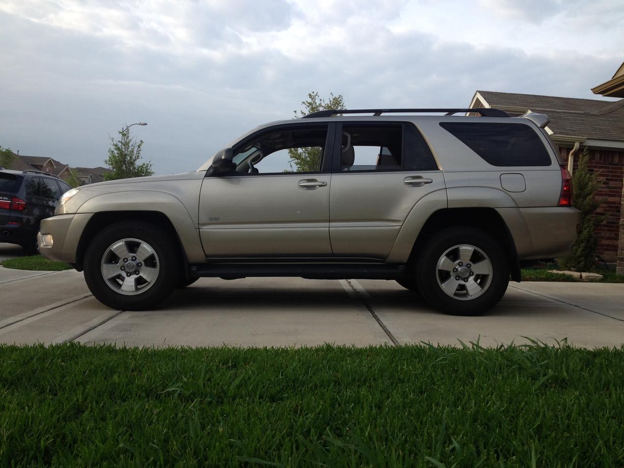

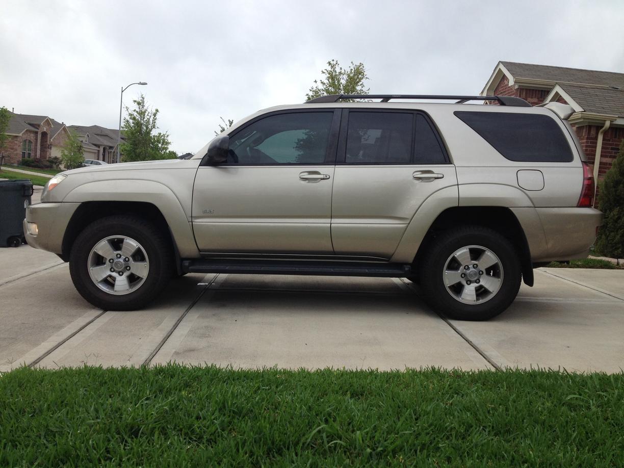

Just did my swap. no spacers installed, just springs here.:toilet:
2005 4runner 2wd v6 (168k mi) with bilstein HD (30k)
springs were from a FJ 4wd with i think around 70k miles or so. trying to find the email with the info.
The bilstein HD all around have ~30k miles front, <10k mi rear, had them on the stock springs and made the ride better on the freeway.
The rear seems to be a very slight lift, the rear springs were very slightly thicker.
the front springs were definitely thicker.
ride quality:
did the rear first and noticed the ride firmer just getting out of the driveway to reverse in. after the front, the ride is a lot firmer yet controlled. i still have to do alignment. most / 1/2 of the truck like bouncing around has gone however the front still feels bouncy, like when braking hard when parking and the nose goes up and down like worn shocks, altho shocks are pretty good. but hey, i come from sporty cars so i think i'm being too picky
handling is a lot better around curves. lean is less. the steering feels firmer and a bit more responsive. but i'll have to see after alignment.
overall great improvement, the ride feels more controlled now. it's not soggy. the suspension feels tighter on bumps. it feels renewed. i didn't measure but about 1.5" lift in the front. mostly did it to get a better ride

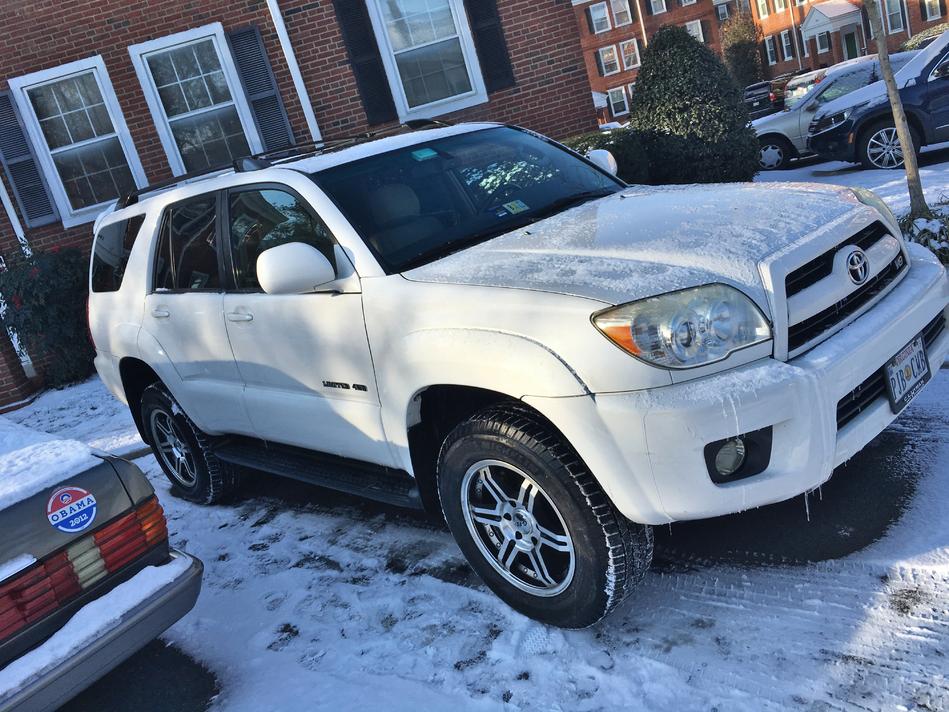

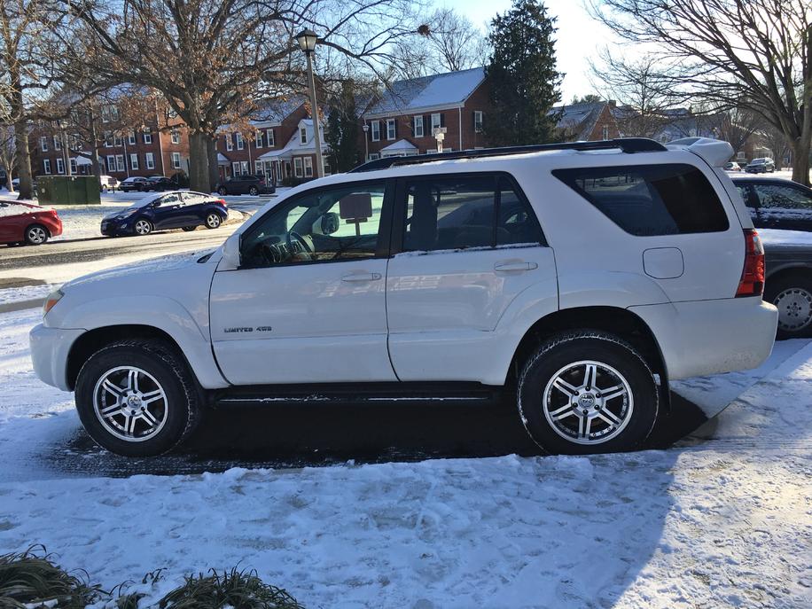

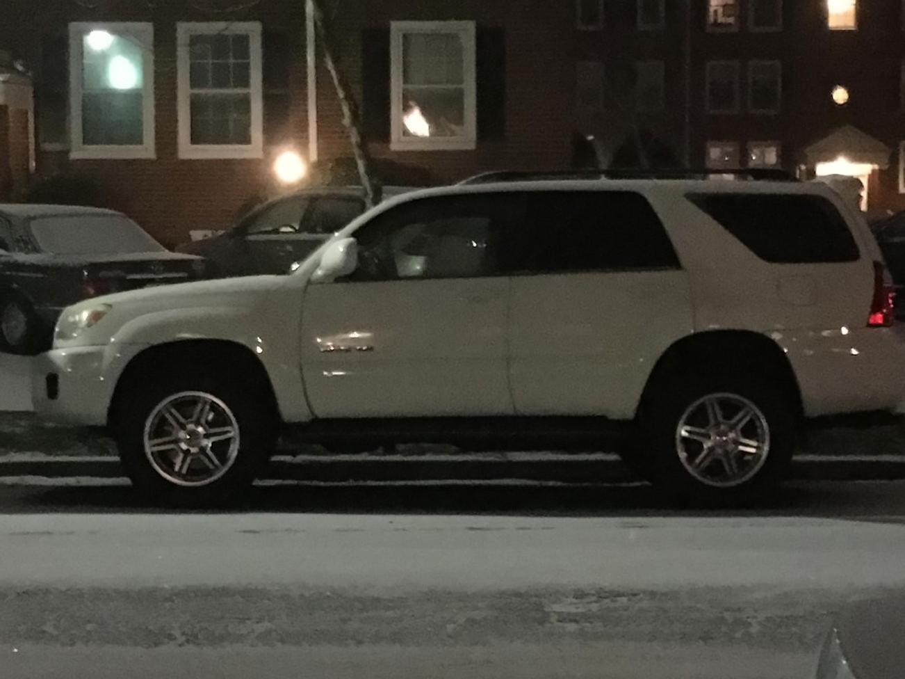

2005 V8 4WD Limited with FJ OEM coils and Bilstein shocks
I just got this mod done today after riding around with my trunk full of parts for a couple of weeks...
Parts:
  • lightly used coil springs off a 2009 FJ ($275 shipped from a very helpful seller on FJ Cruiser Forums)
  • Bilstein Trail Teams front shocks off the same vehicle: p/n 48510-04100, seems very similar to 4600 HD (included with the springs)
  • Bilstein 5100 rear shocks p/n 33-187174 ($150 through Amazon)
  • KYB strut mounts ("top hats") p/n SM5640 ($53 from TH Motorsports)
  • 10mm front topout spacers and extended-length studs ($37 from Wheeler's Offroad)
I chose the front spacers to reduce the rake just a little. Once the front shocks are worn, my plan is to remove them and the spacers and replace them with 5100s set at 0.85". That's why I already got the rear 5100s; they are reported to be valved the same as the 4600s and about 1" longer.
Old ride height: F 18.75" R 21" (hub center to fender)
New ride height: F 19.75" LR 21.25" RR 21.75"
Lift: F 1.0" (about 0.4" from the new springs + 0.6" from the spacers) LR 0.25 RR 0.75"
Given that I live in an apartment, I had this work done by a nearby shop. They charged me 5h of labor ($475) for completely removing XREAS and the old springs, installing the new components, and replacing the front sway bar links and bushing ($75 for these additional parts). This might sound like a lot but some of the other quotes I got were almost 50% higher.
So far, my experience is as positive as Geerlijd's, and I also want to thank this forum for the great advice. Ride and handling are almost as nice as on my wife's new Crosstrek. :D
